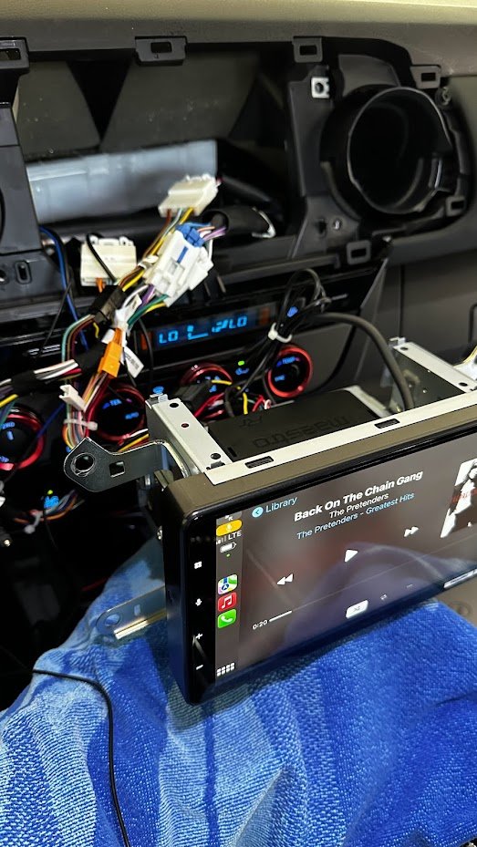

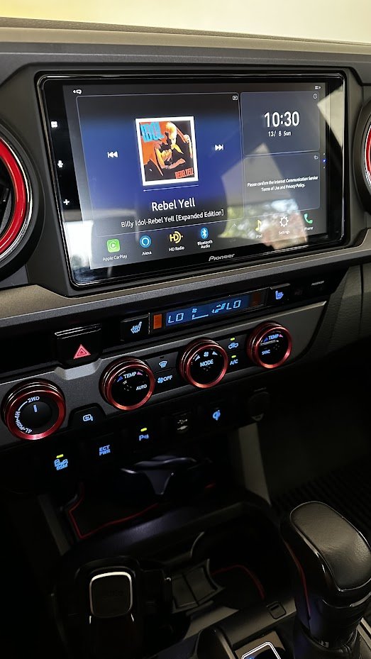

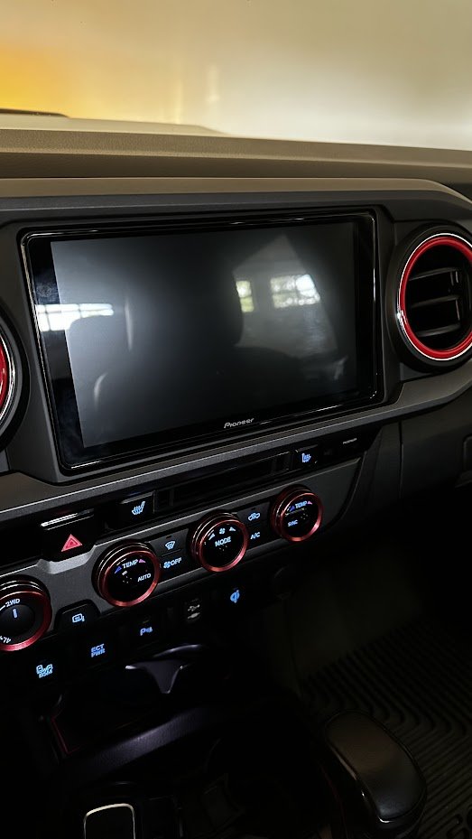

    Just installed on 2017 Pro, the entire process was straight forward. I was able to get allot of helpful ideas from previous posts.
    HU is seating flush with only slight mod of the factory brackets.

    Yes ...I installed the Pioneer 6600 head unit. As others have mentioned, it took longer to adjust the bracket to get a flush mount.
    I saw another Tacoma that had the JVC 7" radio installed, doesn't compare to a 9" screen.
