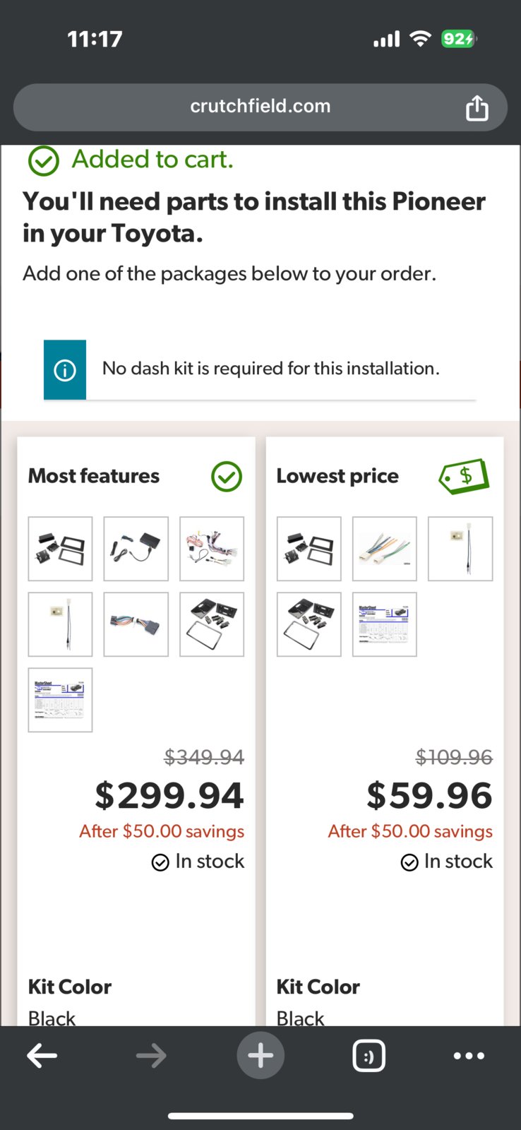

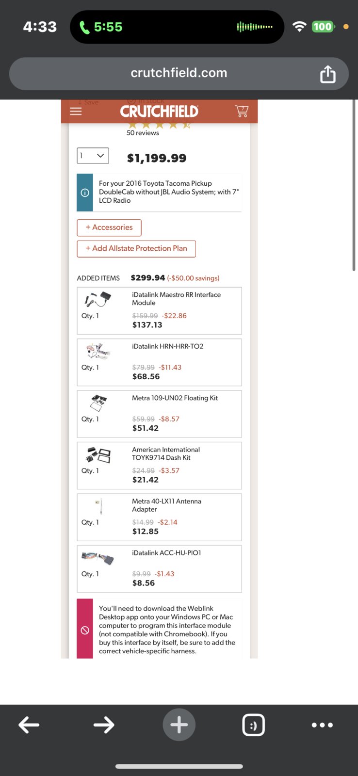

    Do I need the floating kit and the dash kit for this flush mount install?
  3. Oct 23, 2023 at 10:39 PM
    #1863
    Rainoffire
    Rainoffire Well-Known Member
    May 31, 2018
    #255034
    3,120
    2017 QS DCLB TRD Sport
    I don't think the flush or floating kit is necessary. If you have the larger entune premium head unit, then it will fit into the same cavity. You use the OEM brackets, modify them with a hole or two, and it will sit flush.
    You just need the head unit, the maestro rr, the cables and adapters.

    Is there a good write up or video that can show me how to install this? I got the head unit and other stuff to install it with from Crutchfield. Thanks.
  7. Nov 6, 2023 at 8:24 AM
    #1867
    jiriza84641
    jiriza84641 Active Member
    Aug 29, 2023
    #432376
    31
    The PRE OUTS from the pioneer are all labeled FR, REAR, SUB. Those you can just connect to the amp you will be using. The Camera will have its own connection. Hope this answers the question.
  8. Nov 6, 2023 at 8:25 AM
    #1868
    jiriza84641
    Aug 29, 2023
    #432376
    31
    If, you have the wiring rom Crutchfield, it should all be pig and play. The only thing with the Meastro RRR is that you may have to use a windows system to program it, and you can find plenty of youtube videos on how to do that.

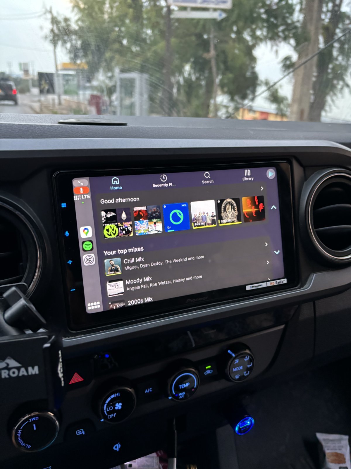

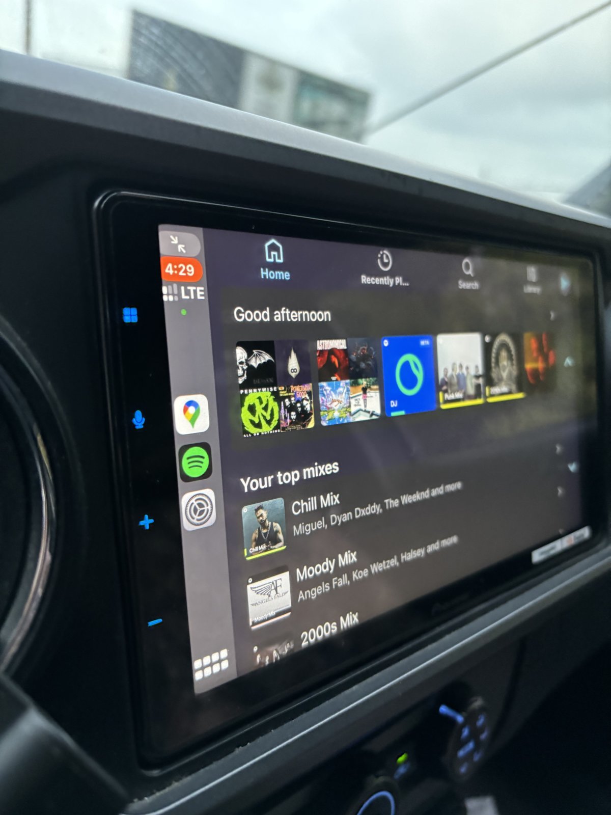

    Any pics of the 360 and backup cameras
  11. Nov 12, 2023 at 10:23 AM
    #1871
    cowfootball
    cowfootball Well-Known Member
    Jul 4, 2022
    #400664
    806
    South Lake Tahoe, CA
    2022 TRD OR
    They look identical to stock. The Toyota software draws them with the overlays and everything and the Pioneer just displays them so they look identical.

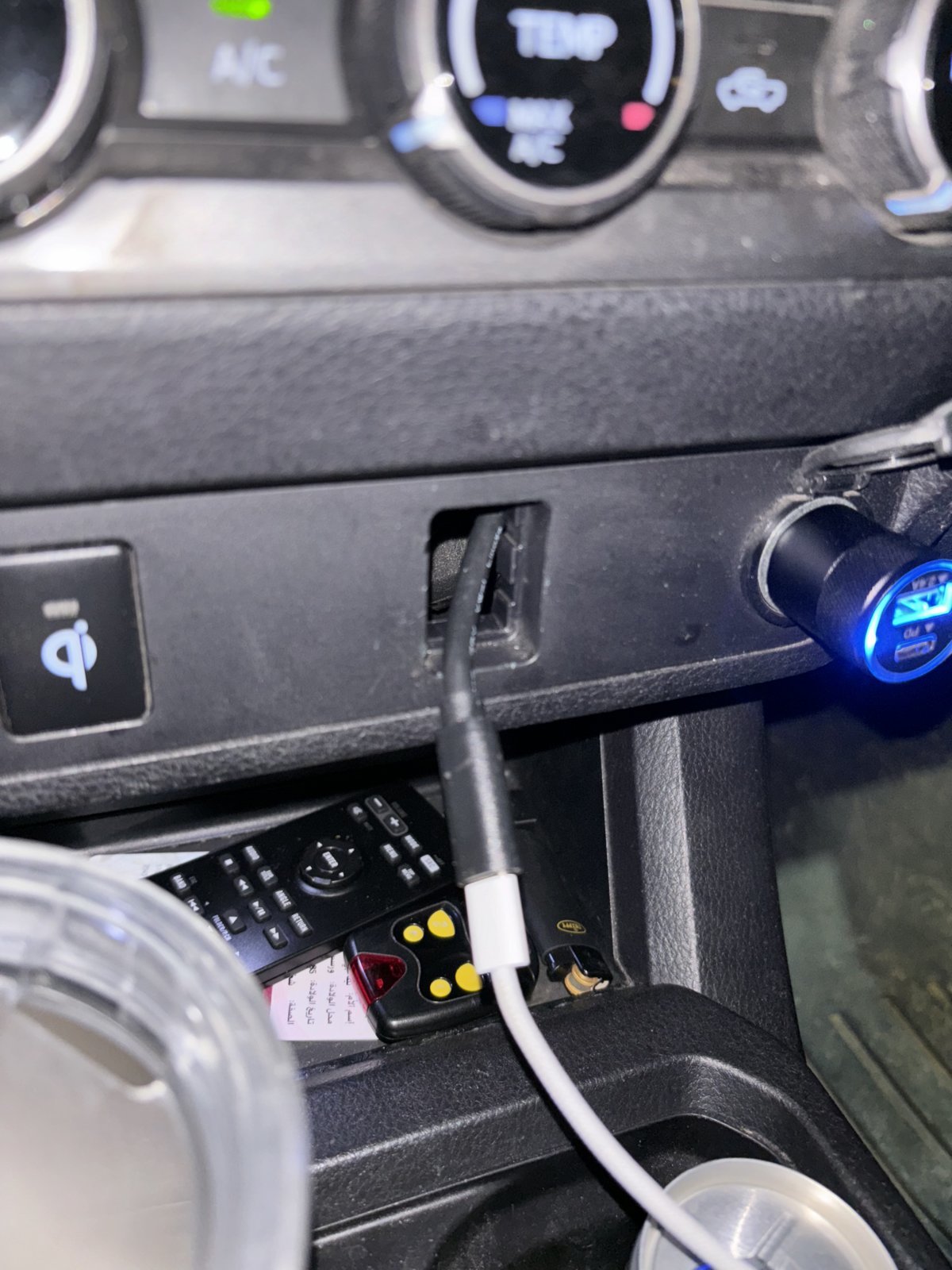

    Any idea what to do about this? How can I add a usb c port that looks stock?

    You want something like this:
    https://a.co/d/eH94iEJ
    you’ll need to confirm exactly which one as the buttons come in two sizes depending on generation and location.

    thanks. But will that give me the ability to share data and update firmware and all that?

    yeah I’ve been searching I can’t find anything. Honestly I don’t mind keeping it like this, but if there’s someone out there I’ll do it.

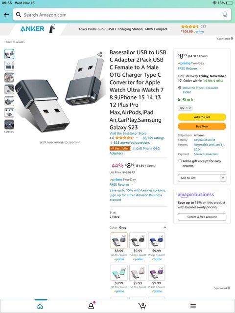

  18. Nov 15, 2023 at 7:58 AM
    #1878
    Stevie17
    Stevie17 Well-Known Member
    Mar 2, 2023
    #419202
    4,218
    Stevie
    Crossville, Alabama
    24 Celestial Silver Sr 5 DCSB 4x4
    Do you still have the original port? You could always try this
    IMG_0008.jpg Or something like this

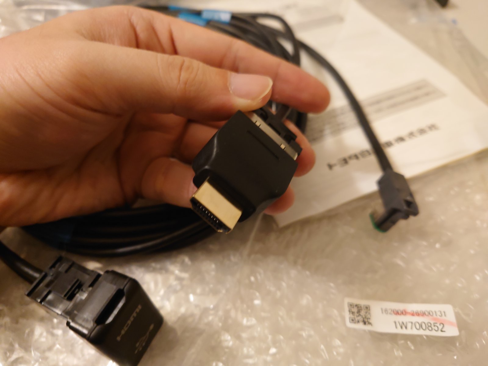

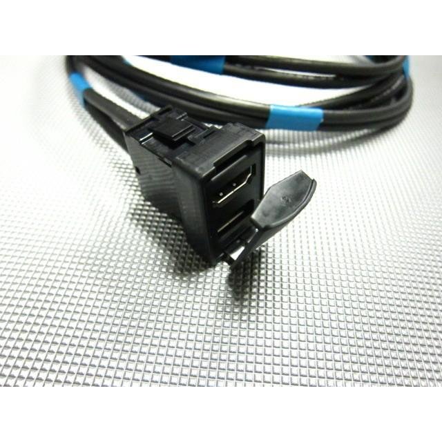

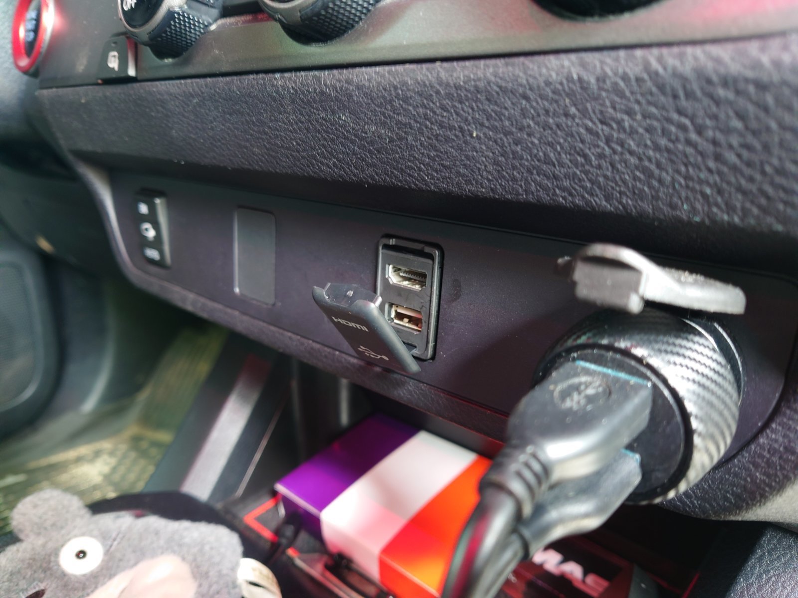

  19. Nov 15, 2023 at 9:56 AM
    #1879
    Rainoffire
    May 31, 2018
    #255034
    3,120

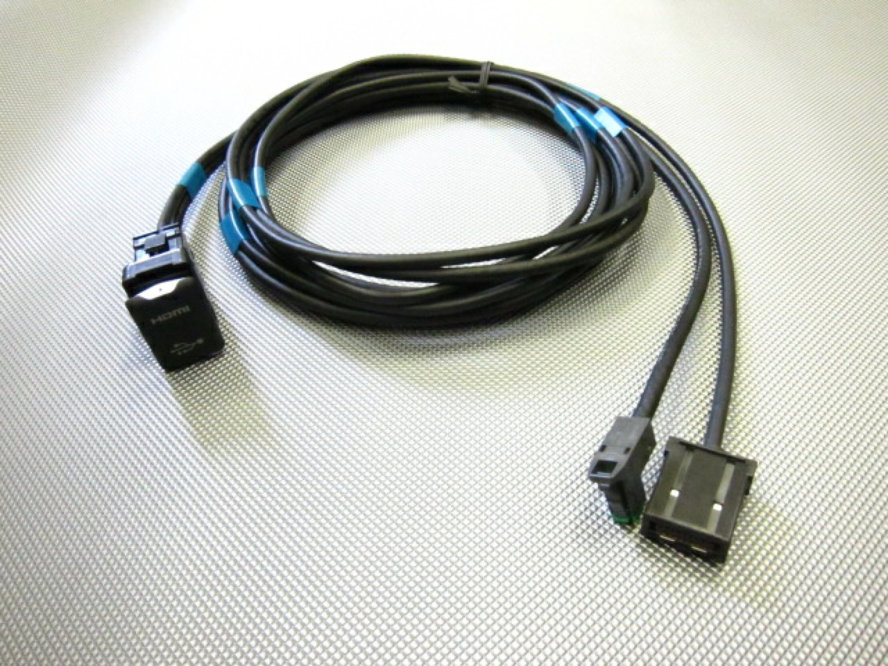

    Sadly there is no OEM usb-c port that transfers data, all the ones I have seen are for charging only.
    However, the WC6600NEX only does USB 2.0 at best with a max charge speed of only 3.0A. So the stock USB port would be more than enough for the headunit.
    I personally went with an OEM HDMI+USB combo port.

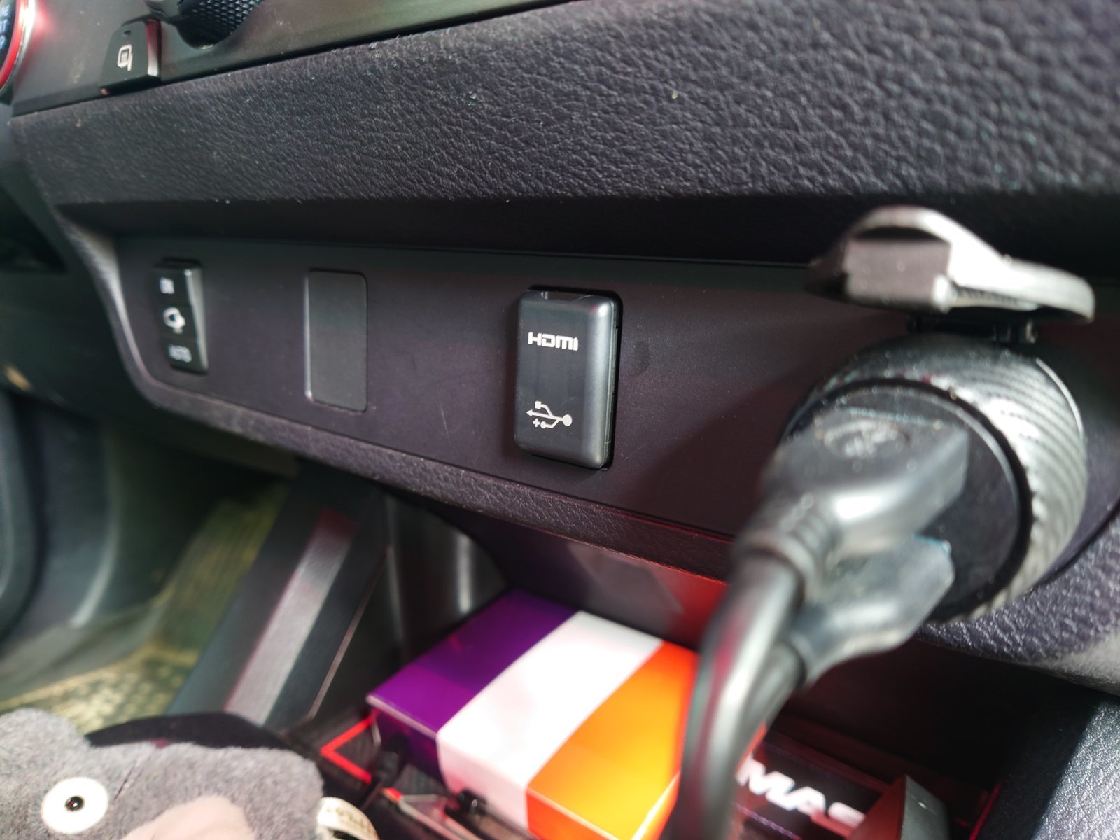

    I have an unpowered HDMI 3way Switch to change input between the HDMI port, a Chromecast and Nintendo Switch.
    Pics of it installed.

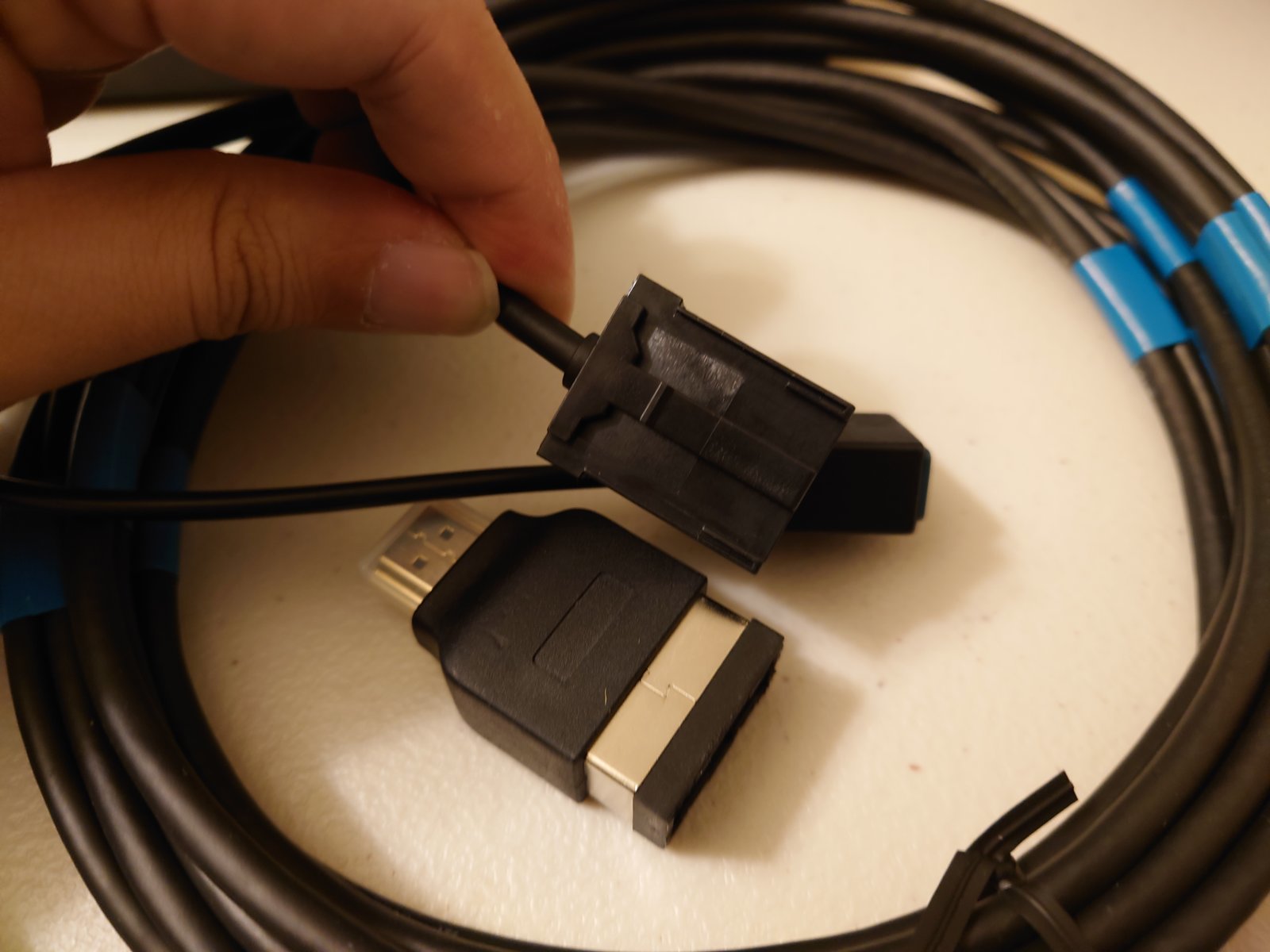

    This is a Japan Only market part, so it teminates with a HDMI-E and 4pin USB connection. HDMI-E is an automotive spec connector used only in Japan (maybe the rest of Asia too?), so finding an adapter was particularly hard...

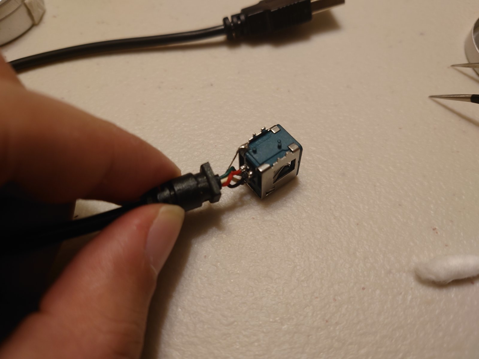

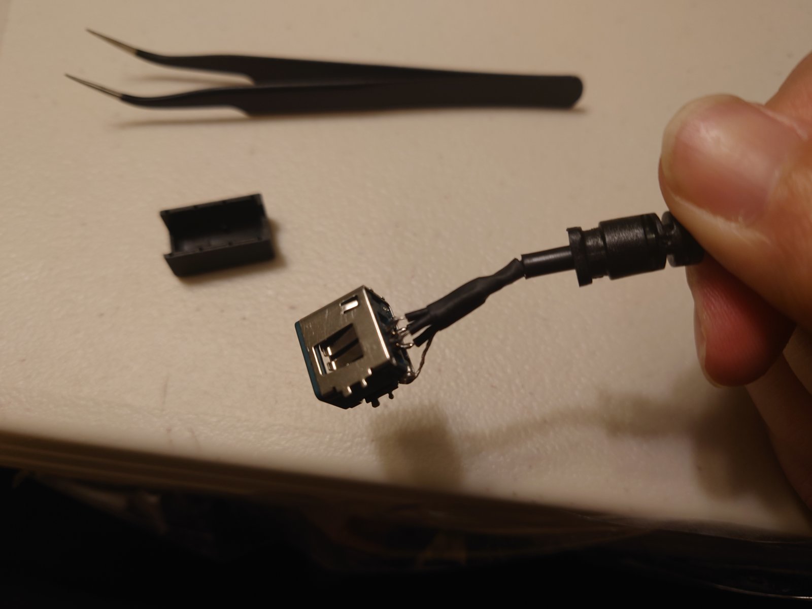

    For the 4 Pin USB, it is the same connector used on Mazdas, so their USB retention adapter works. However the data+/- and positive/negative for the adapter were flipped, so I had to resolder the wires to the correct pins.
    Edit: added info
