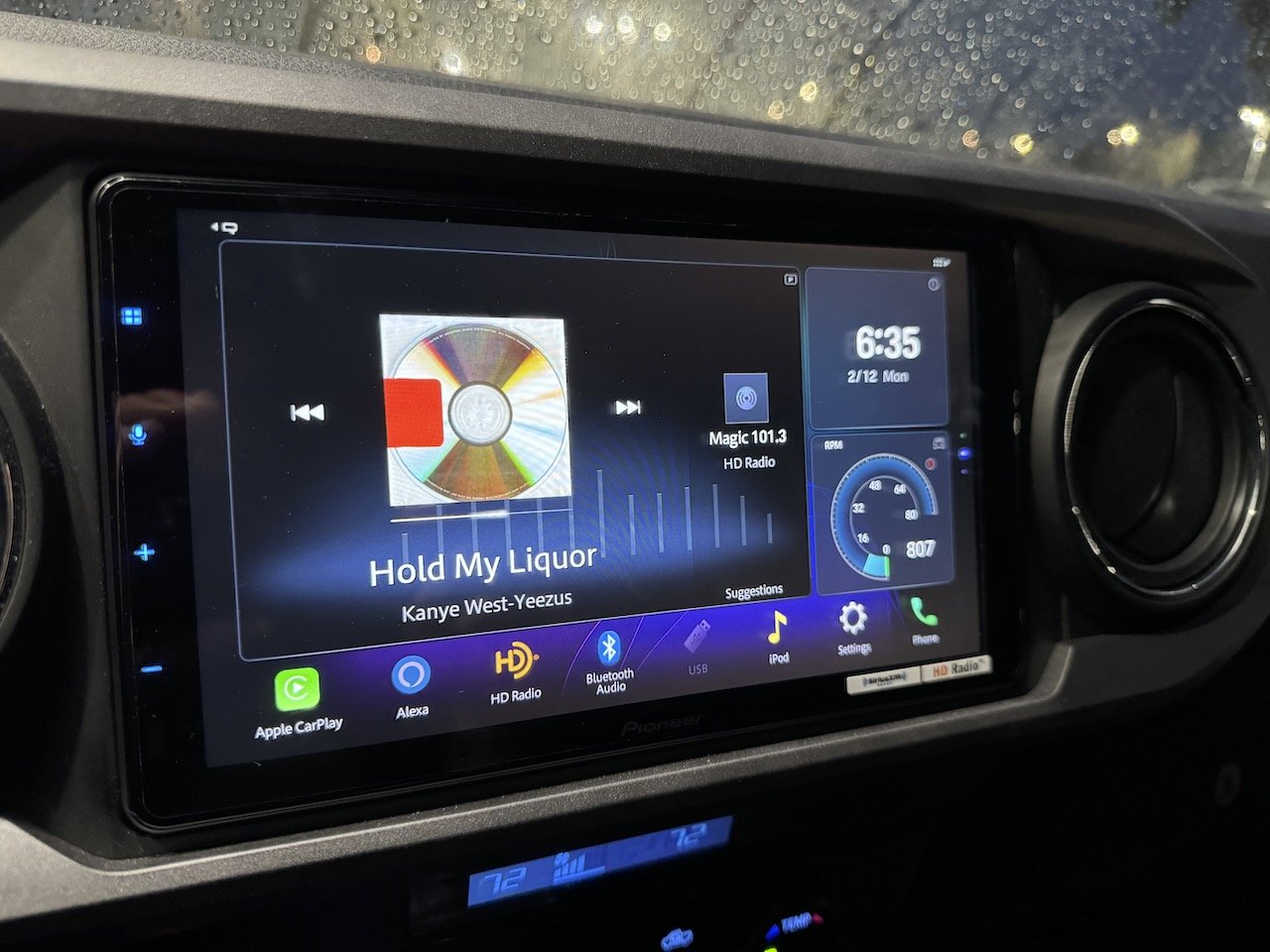

    I bit the bullet and got this. I installed it today and it's working well. For those who like this stereo but can't stomach the $1200 price tag, I just kept searching Amazon and finally got it for $750 (new not refurbished). All the Maestro crap still put it about a grand, but better than $1500+. Creative Audio was the seller; sounded like a shop in the midwest. Have it connected to an Audio Control 1200 W amp, Infinity Reference components, and a Rockford Fosgate sub in the Skar box. It's really, really loud and the audio quality is way better than trying to run stock speaker wires to an amp or LOC. I've had zero issues with it connected via bluetooth, really nice audio features, CarPlay works well. And where I thought I might lose features, I actually gained some, like vehicle data, CarPlay dash controls, different programmable selections for the steering wheel controls. Crutchfield will say you cannot buy the iDatalink USB and GPS/NAV adapters, but you can. It's a USB-C, but Pioneer includes a USB-C-to-USB-A adapter. Only issue is the mic, which sound impossible to adapt. But it sounds like the Pioneer one can be routed overhead where the factory one is, should you choose to do it. As far as the install, the Maestro vehicle-specific firmware MUST be installed first via a PC. Save yourself a headache and buy all the wiring harnesses. Some Toyota plugs are left loose, and one Maestro connector can use one of two Toyota connectors. It's the white one there, not the black one. After that, install the Pioneer CarAV app on your phone, connect your stereo to it as a hotspot, register the device, and follow the instructions for updating the firmware (tricky but doable). In my case, everything worked flawlessly. Very happy with this.

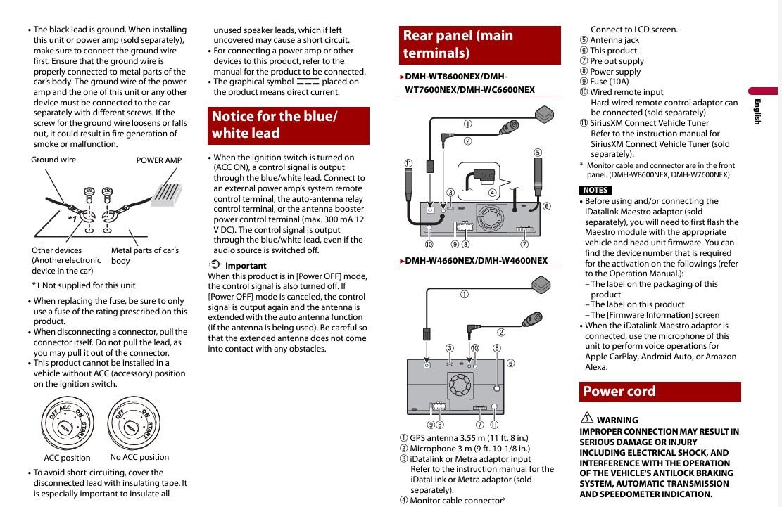

    Thank you, much appreciated. I used that adapter kit. I connected the existing black wire (which maybe is the wire to the shark fin antenna?), which was already plugged into the back of the HU in the GPS port. But. I don't know why I had it plugged into the GPS port with my original install. My theory is that it's the antenna for a local wifi connection between the Iphone and the HU, and this is needed for wireless Carplay. I don't understand the fundamentals of the carplay connection I think.
    Anyway, I removed the existing black wire that was plugged into the GPS port, and used the adapter to plug ithis wire into the module below instead of the GPS on the HU.
    But, when I do that, I get an error message that carplay/phone Wifi won't connect because there is no GPS connection. We don't have Sirius up and running yet because we need to call and get his account transferred over to this new device, but it seems like the black wire (assumed this is the shark fin antenna), needs to somehow be wired to the satellite adapter AND to the GPS port on the back of the head unit?
    Doesn't seem like there's a way to do that, so maybe I have to use the new antenna that came with the kit in the photo below? And then the black antenna wire remains plugged into the GPS port. And there's the other antenna wire (labeled as 5 below), perhaps that goes to the shark fin. :confused::confused::confused:
    I will keep seaching to see if I can figure this out, any suggestions appreciated.

    Sat/XM wire is black, the GPS antenna is white. So maybe you have them switched for some reason.
    This thread has helpful install tips if you haven’t seen it yet.
