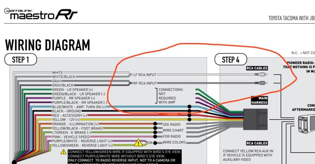

    Hello, and thank you in advance for helping me figure this out.
    I have a 2018 Tacoma Limited with the JBL system and the 2.0 entune package. I purchased a DMH-WC6600NEX along with a Maestro RR and the wiring harness. My next step is to solder the wires on the harness, but I noticed that the Maestro diagram states that speaker connections are not required.
    I just want to confirm that I do not need to connect the individual speaker wires, including the two RCA connectors shown at the top of the diagram (LF-RCA-input and RF-RCA-input)
    Thank you!

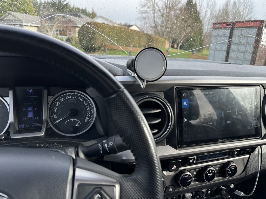

    I figured out my previous question, but I have another one. Has anyone encountered the TPMS displaying opposite sides between the dash and the Pioneer system? It looks mirrored.
