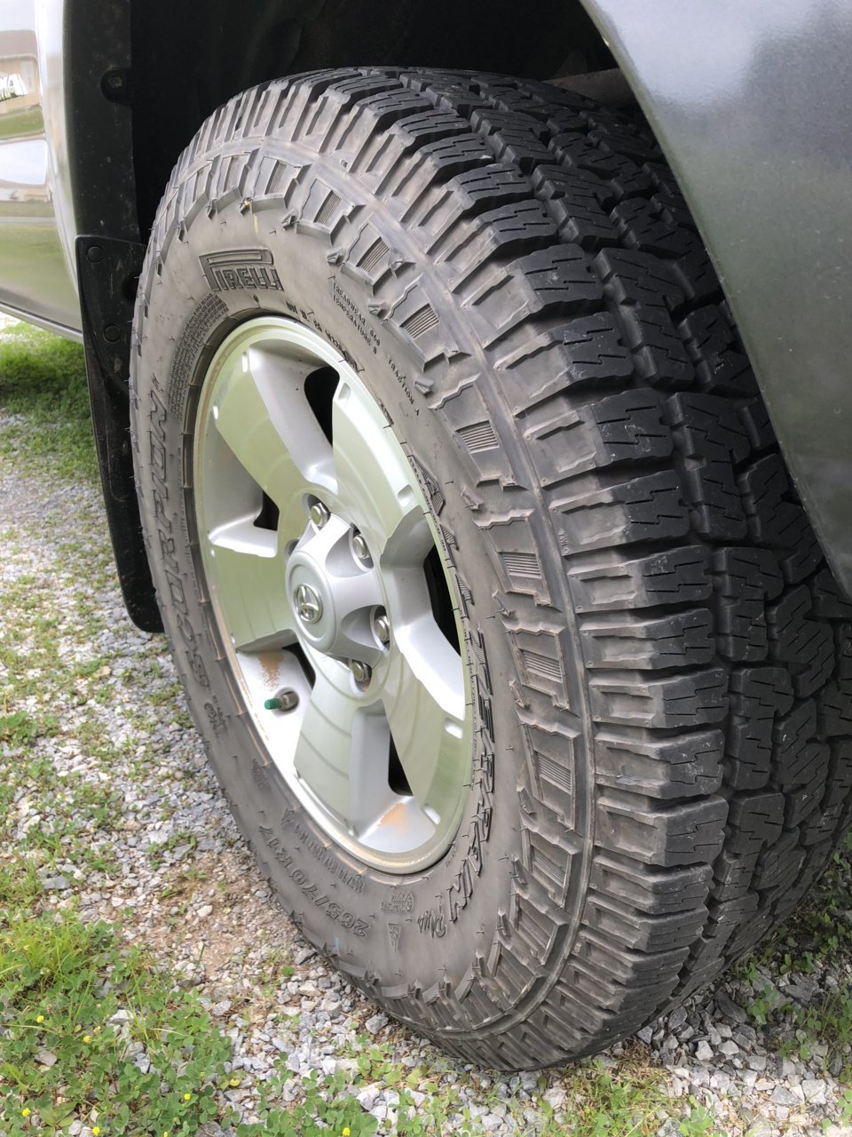

    Got a set of the new Pirelli Scorpion All Terrain Plus installed at the local Costco today in P265/70/17. Was looking for a KO2 alternative since they’re stupidly expensive in Canada for some reason. Like almost $300/tire expensive. Ridiculous. Got the P rated for weight savings, only 41 pounds. The E rated was 48 pounds, which isn’t too heavy for a 10 ply. Will update thread after getting some kilometres on them. I couldn’t find any reviews online except for a few auto publications who went to a Pirelli event to test tires, so I’ll see what I can come up with. I’ve also realized I’m not a tire photographer, so I’ll try to get some better pics too.
    Wet weather update: Had some rain on the way home from work. There’s a few stretches of highway that have grooves worn in them from traffic which collect standing water. Very annoying to drive through at times. Of course I tried to find the line with the most water and ended up being very impressed with the hydroplane resistance of the Pirellis. They definitely made a bit of noise, as all tires do, when the water got deeper, but there was not really any loss of contact with the road up to 70 mph. I haven’t had any other A/T tire for my 2015, so I don’t have much to compare the Pirellis to other than the shitty Dunlop’s and my Yokohama Ice Guard winters. I’d give the Pirellis a higher score in wet weather performance over the Yokohamas, at least when they’re new. Have to see how they do over time.

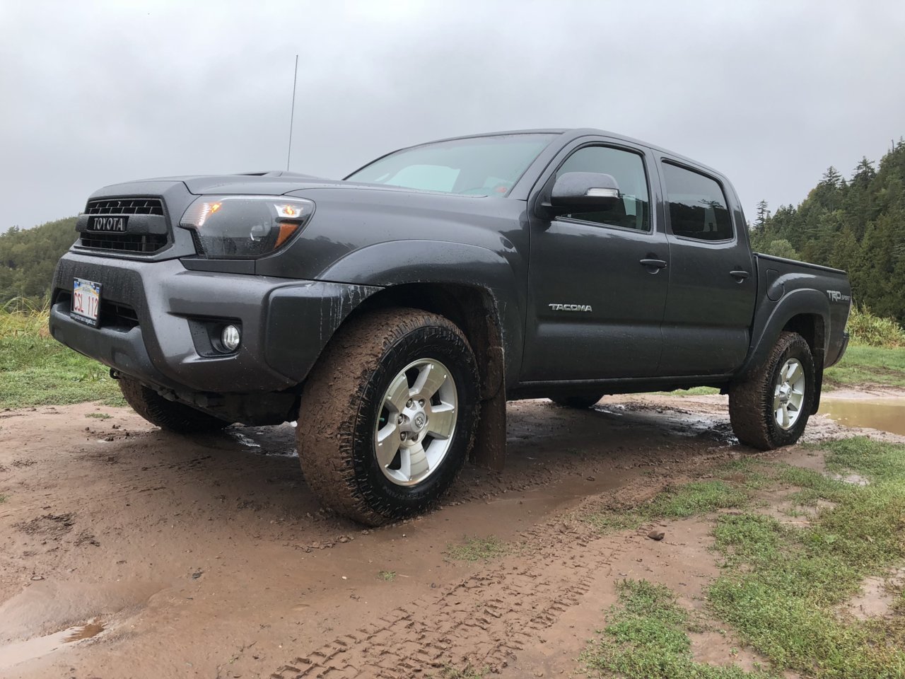

    Finally got into a bit of mud yesterday. It’s a hard packed dirt trail that develops a slick muddy layer on the surface when it rains, so not deep mud. The tires did fine but the tread doesn’t clean out well at low speeds. I’m not sure other A/T tires would either, unless they’re the more aggressive hybrid A/Ts. I’m sure some more wheel speed would fix that though, but it wasn’t necessary for the conditions. Actually 2wd was sufficient.
