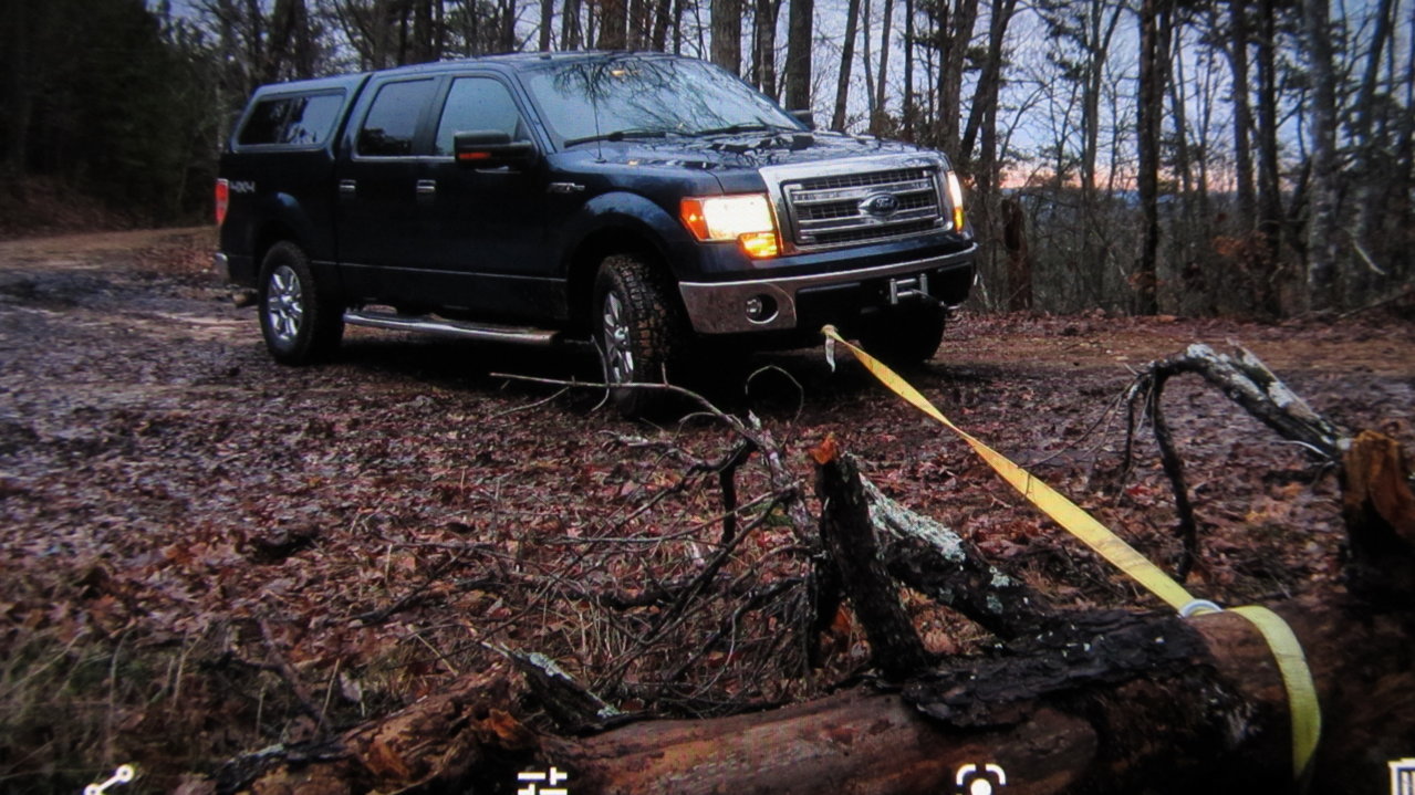

    I did get several chances to use them in mud. This is me dragging a downed tree out of the way on a forest service road while hunting. I'm on pretty solid dirt here, but 5-10' behind the truck the mud is 6-8" deep. By the time I got the tree clear of the road I was in pretty deep mud. The wheels spun some, but I never stopped moving until I had the tree out of the road.

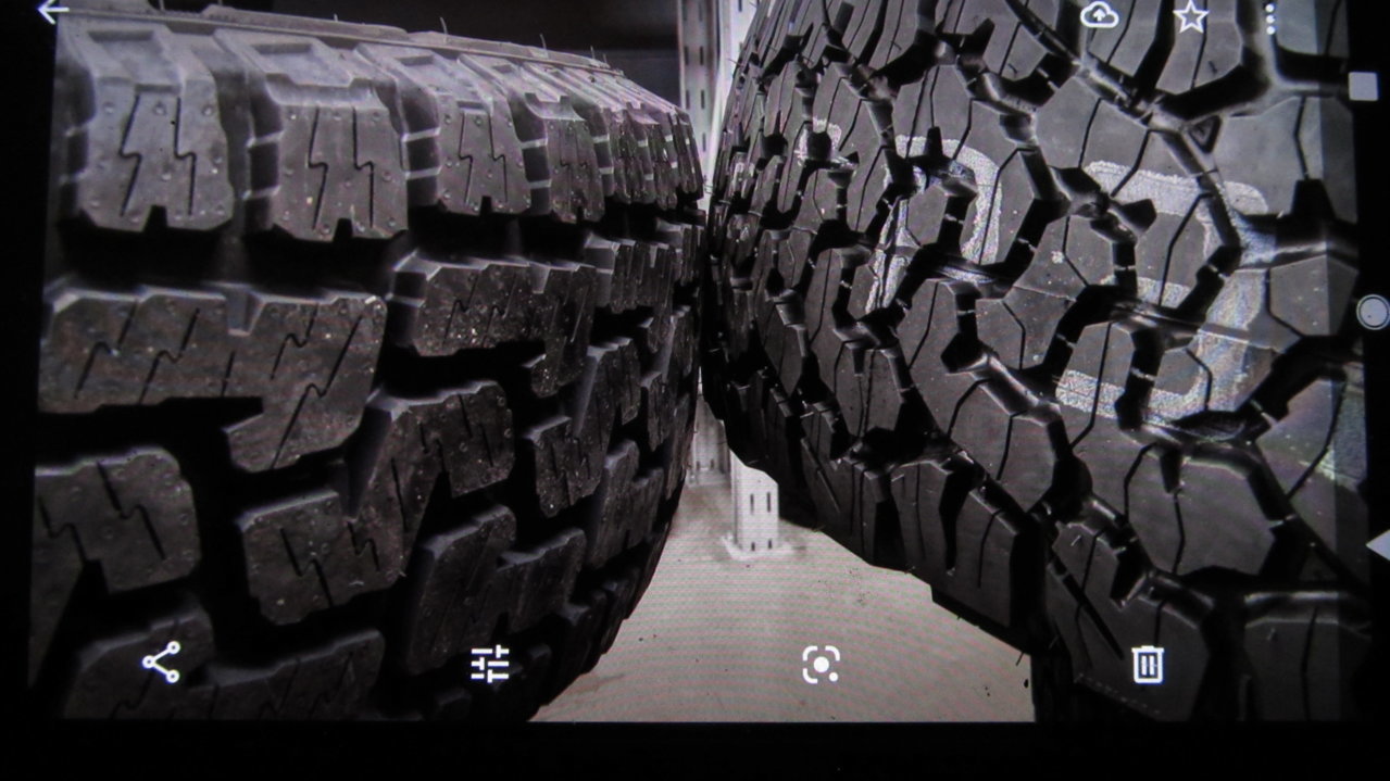

    Just for reference. When deciding on tires BFG KO2's were on my list. I'd seen the Pirelli's online, but not in person. When I say them side by side I liked the Pirelli's better. Plus they were a lot cheaper.

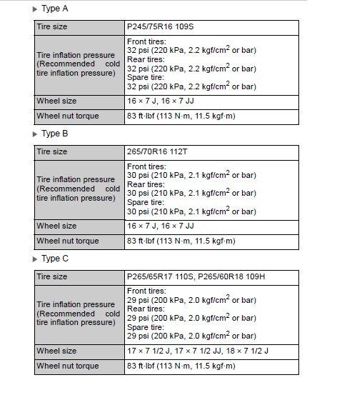

    I like your choice in tires, a major improvement over the stock Dunlop Grandtrek AT20 P245/75R16 109S SL (2,271 lbs)
    vs the Pirelli Scorpion AT 265/75R16 116T SL (2,760 lbs)

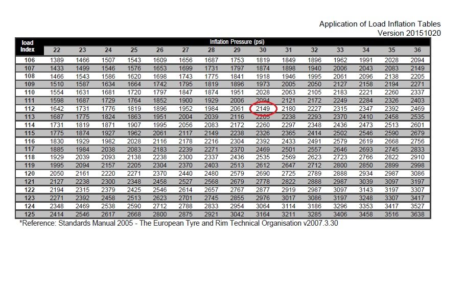

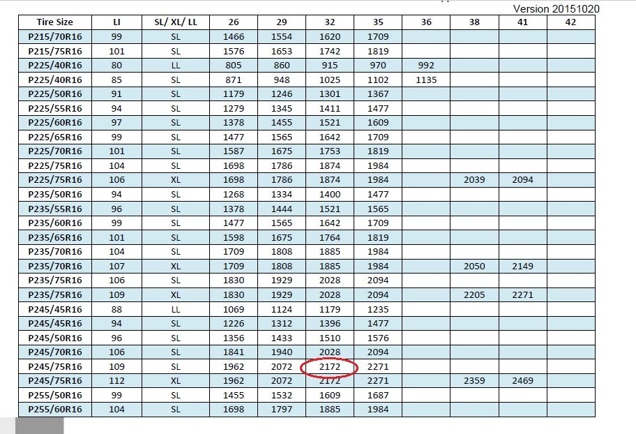

    Also here is a link at Toyo pdf document that talks about load capacity regarding P metric tires when used on a light truck (Page 5)...
    https://www.toyotires.com/media/2125/application_of_load_inflation_tables_20170203.pdf

    That link is pretty interesting. From the chart, if you had a TRD Sport with 265/65/17, and switched to LT265/70/17, you would need to inflate them to 50 psi to make the load rating equal to the original tires. :eek:
  9. May 19, 2020 at 5:00 AM
    #89
    splitbolt
    splitbolt Voodoo Witch Doctor
    Mar 7, 2010
    #32761
    7,858
    NW Arkansas
    2016 TRD OFFROAD DCSB MGM

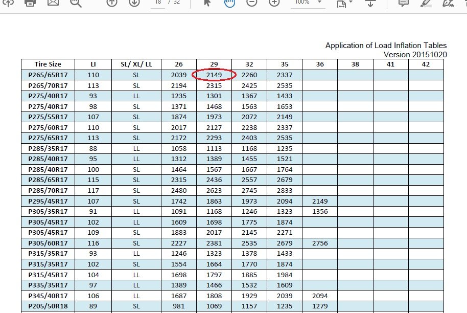

    The load of a P265/65/17/110 @ 29 is 2,149 lbs...
    After de-rating(going from a P/Euro metric to LT), the load for an LT is 1,954 lbs(2,149/1.1=1,954)
    An LT265/70/17 attains a load of 1,964 lbs at 37 psi.
    And just for shits and grins...a 265/75/16/116 requires 27 psi(2,178 lbs).

    Actually 45 PSI with a LT265/70R17 would provide 2255 lbs if compared to the 265/65R17 112 SL (Goodyear Wrangler w/Kevlar) 2149 lbs @ 30 PSI (page 28).
    If you look at the LT265/70R17 load inflation table (page 22)...1890 lbs @ 35 PSI, 2075 @ 40 PSI and 2255 lbs @ 45 PSI
    Load capacity increases as you reach the maximum PSI for each load rated tire...
    LT265/70R17 Maximum 2470 lbs @ 50 PSI for C-Load 112
    LT265/70R17 Maximum 2910 lbs @ 65 PSI for D-Load 118
    LT265/70R17 Maximum 3195 lbs @ 80 PSI for E-Load 121
    So yes, more air for LT tires to meet ISO metric tires load capacity.
    Edit: 2149 lbs @ 30 PSI

    Just some errors I wanted to point out...
    The OEM Sport tire is a P265/65/17/109
    The OEM Offroad/Pro tire is a 265/70/16/112
    You've conflated the two...
    So 2,149 lbs-2,172 lbs for P and Euro metric tires.
    You neglected to account for de-rating of P and Euro metric tires when changing to LTs. See page 11 of PDF...
    So 2,149 becomes 2,149/1.1=1,954 lbs...or 37 psi @ 1,964 lbs.

    The only error I made was using the word "stock" when comparing the ISO Metric tire to the LT metric tires. There was no intention of discussing the P metric tires which is a different topic you were commenting on.
    Still like your post on stock tires.

    This is what you wrote...
    "265/65R17 112 SL (Goodyear Wrangler w/Kevlar) 2227 lbs @ 32 PSI".
    This tire does not exist and that pressure is for the SR5 P245/75/16/109.
    It's either a Goodyear Adventure Kevlar 265/70/16/112 or a Firestone Destination P265/65/17/110.
    Like I said, you conflated the Sport's tire size and Offroad's load rating...with the SR5's tire pressure.
  14. May 19, 2020 at 7:34 PM
    #94
    SmileyGuy
    SmileyGuy Well-Known Member
    Nov 21, 2019
    #311305
    497
    Darrin
    Nova Scotia
    20 Tacoma Off Road Voodoo Blue DC SB TRD Premium CAN
    265/65R17 112 SL Goodyear Wrangler w/Kevlar....product code 758061571
    https://www.goodyear.ca/en-CA/tires...ave&webprodid=2732&productcode=75806157100000
    https://www.tirerack.com/tires/tire...n Adventure with Kevlar&partnum=665TR7WATAOWL
    32 was the PSI I chose from adjusting my wife's car tire pressure today. Made the correction from 32 to 30 PSI. No problem, changes nothing. Has really no effect to your problems.
    Your 1st problem: The above tire does exist and if you look at your ISO metric chart 2227 lbs is under 32 PSI column for 112 load index, which may be the same as many other vehicles not mentioned here like the SR or SR5 which comes with 245 series tires.
    Your 2nd problem: You comment is on P metric tires and was not quoted.
    Your 3rd problem: You concerned with P245/75/16/109, again P metric, 245mm width and 16" tire. (I compared an ISO to a LT of same size 265mm and 17")
    Thanks again for you input about P metric tires. Personally I feel P metric tires on a light truck is the poorest decision Toyota made on the Tacoma. ISO metric minimum or LT tires on the Tacoma is my opinion.

    Pertinent would be referring to the Toyo pdf which has load index tables in it. Anyone reading this would have to assume 37 PSI was calculated correctly as it is not on the chart.
    Difficult for others to decode and think WTF?
    Having a Sport with P265/65R17 and changing to LT265/70R17 is pertinent and just for shits and grins P265/65R17 to 265/75R16 would be impertinent.
    Finally, having a Sport with P265/65R17 110 SL 1,954 lbs (2,149/1.1=1,954) @ 29 PSI and changing to 265/70R17 112 SL 2469 lbs @ 51 PSI max could be run at what PSI would be more pertinent.
    Would you choose 2149 lbs @ 30 PSI or the de-rating P metric load index of 1954 lbs near 27 PSI?

    Just so everyone can know where 37 PSI came from you divided the lbs between 35 and 40 PSI by 5 and got 37 LBS/PSI. Adding 74 LBS to the 35 PSI chart value of 1,890 = 1,964 lbs.
    To equal the P265/65/17/110 de-rated load index of 1,954 lbs the LT265/70/17 pressure would be adjusted to 36.73 PSI.
    For a load index of 2,149 lbs the LT265/70/17 pressure would be adjusted to 42.1 (42.0553) PSI. :D
    Now for your soup sandwich...P metric P265/65R17 to ISO metric 265/70R17 112 SL
    You already said the P-metric de-rated load index is 1,954 lbs would you choose 27 PSI to match the de-rated load index or choose 30 PSI for 2,149 lbs circled in the chart for the Tacoma TRD Sport?
    Why adjust different metrics to different load index's that makes no sense, how you do...
