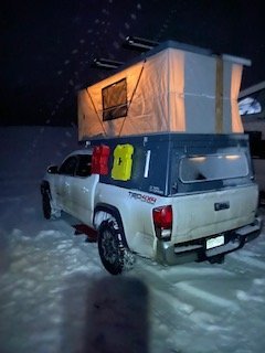

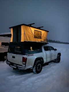

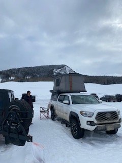

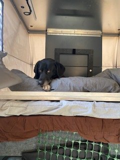

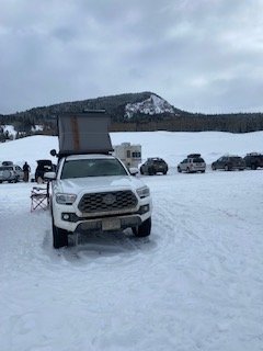

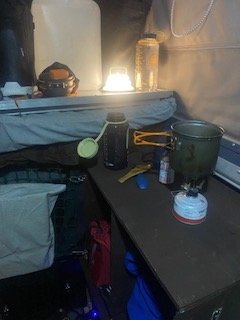

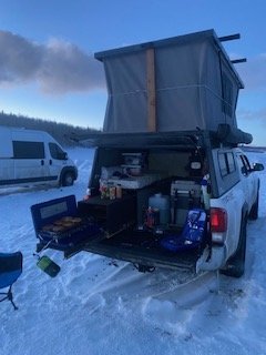

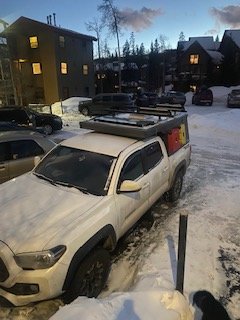

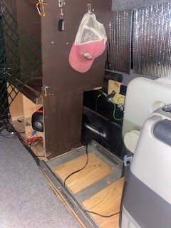

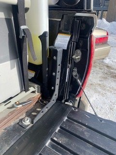

    Holy hell this thread has really blown up since I was first putting my deposit down about a year ago (page 1 of the thread)
    Few photos from my time with my badlander since I picked it up in June 2022
    Note the 2x4's - This was a safety thing to prepare for my first snowstorm with it. I used the vantech J1000 series crossbars with the L track bolts as they were what I could find in stock from the company, they're heacy tho. I got some stronger struts from TT, 80 and 90# to support the weight of the solar, fan, crossbars and ski racks on the bars
    After catching up on the thread, few notes/observations
    1 - Love this thing, cant say that enough! Wind, rain, snow, ive felt comfortable inside the whole time. I will say ive had a small amount of water come in along the seams by the bed once, tightened all the bolts and I *think* its been resolved!
    2 - I you're going to plan to put as much weight up top as i did, definitely get the upgraded struts and I would recommend either having a 2nd person help or use a 2x4 like I did for safety. When I drop the front, I need to leave the rear velcro attached while I climb down. Once down, I release the velcro and the rear will collapse or borderline hold up which is why I have the 2x4 to let me get fully in position to close the thing properly. Again, I have a LOT of weight
    3 - 2.5" mattress TOPS if you're going to go with something that doesnt deflate. At 2.5", dont plan to leave your comforter up there. Im actually about to get some custom ones done as I started with a 4" memory foam and had to cut that wayyyyy down
    4 - Opinion of mine, I got both the upper and lower lighting and never need them both. I wish I had just done the lower and saved a buck as it lights the place super well as is
    5 - Would recommend insulating the roof, this is probably next on my to-do list for the summer. Camping out in tahoe/yosemite on the way back from pickup last summer was brutal!
    6 - Got the KDmax tune which helps, but living in the mountains of CO Im getting about 4 miles/gallon less
    7 - Yes, I have build out specs. Yes, my diesel heater is self contained and the intake/exhaust is punched out through the composite bed. Yes, it's crude and yes, my dogs awesome. Hope I helped anyone thinking about it! Id do it again in a heartbeat
    IMG_7696.jpg IMG_7541.jpg IMG_7538.jpg IMG_7537.jpg IMG_7529.jpg IMG_7527.jpg IMG_7526.jpg IMG_6906.jpg IMG_7812.jpg IMG_7813.jpg

    Nice set-up. Thanks for the photos. What kind of heater are you using?
  3. Feb 19, 2023 at 6:13 PM
    #283
    Adallman
    Adallman Member
    Mar 25, 2022
    #393466
    7
    Alex
    Dallman
    Vevor 2kw, this baby just sips diesel! I have the 10L reservoir and can run it nonstop for 30+ hours
    Would recommend the 5kw if you’re going to do winter camping where temps are in the negatives a lot. The 2kw struggles to get above 8 Celsius when it’s -10 out
