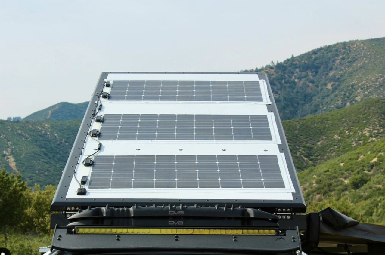

    he is running renogyofficial he goes over his solar setup. Im also looking to put solar panel, you can run the cables into the truck bed or cleaner look drill into the top and seal it and make sure to be between the canvas, thats what I was told when I got my topper put in. Im looking at sun flare xplor 180 series.

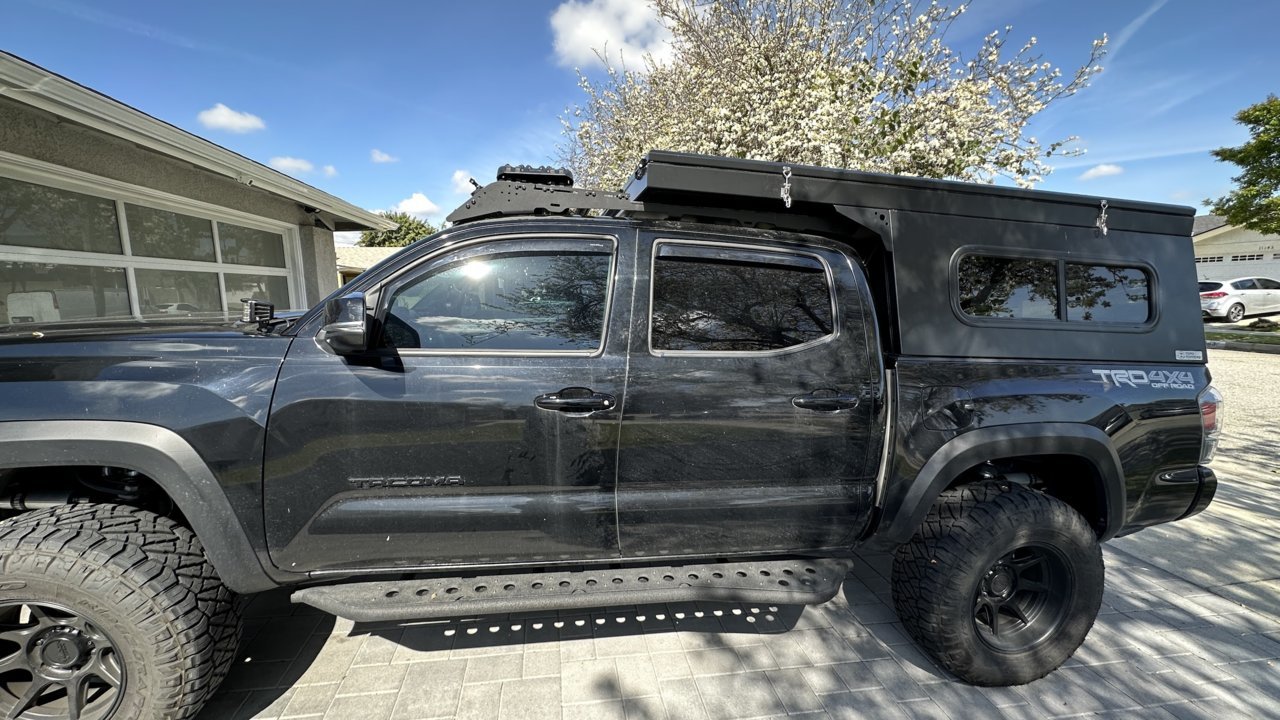

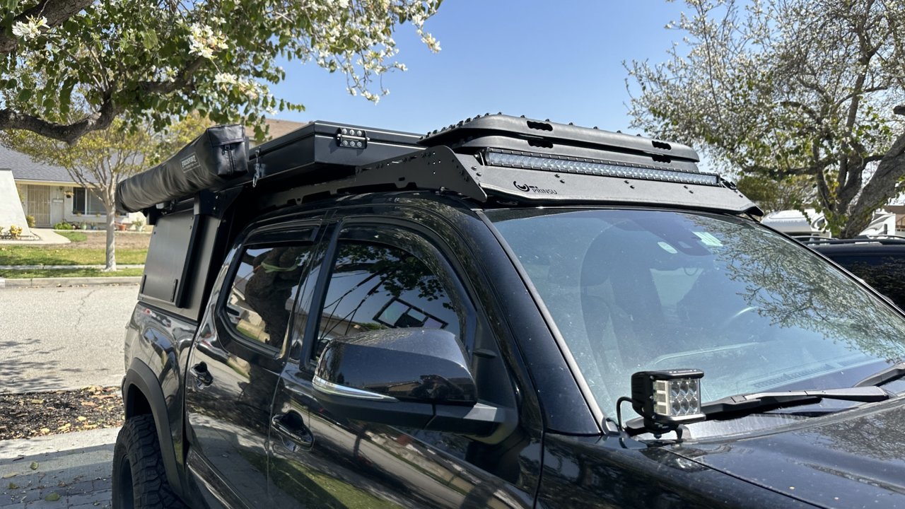

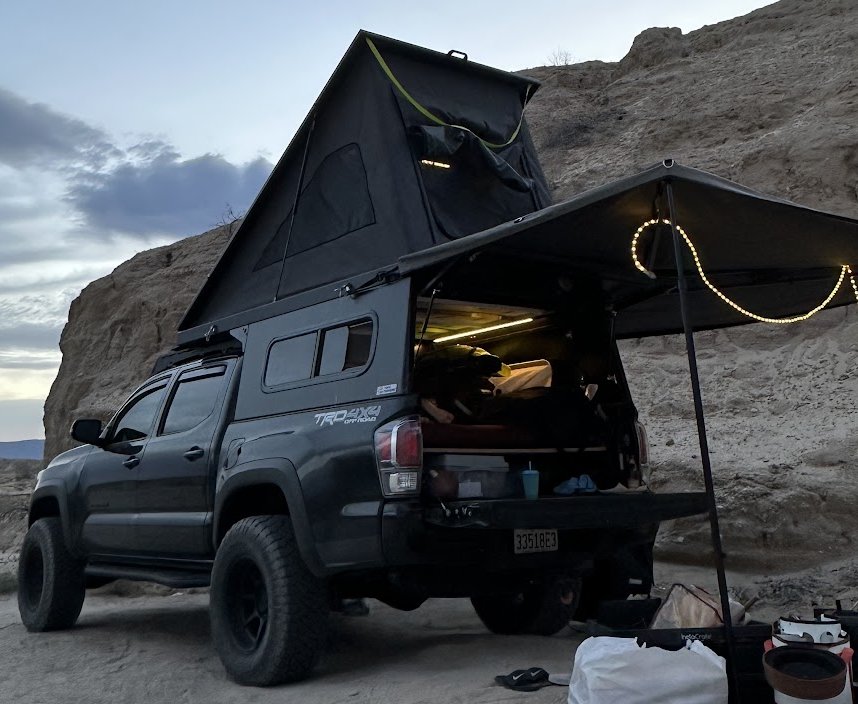

    This is my Mesa had it about 3 months now, so far so good. I came from RSI SmartCap w/ RTT then back to ground tent, now back to truck topper. I'm in Los Angeles we dealt with record rainfall for much of first quarter of the year. No leaks, has been able to handle high winds during camp. Slowly building what to do, I have 2 kids so most of it right now it just jamming stuff inside, plus it's my daily/surf vehicle. Will be adding a rack and solar. Highly recommend Topo Toppers they are great people.
    As far prinsu style cab racks.. I had about 1/8''-1/4" clearance I ran it like that without cutting, I didn't have issues but just scared of flex and scratch/damage truck or topper. I ended up cutting off 1/2" from my prinsu just for my peace of mind. Screenshot 2023-05-06 at 12.34.44 PM.jpgIMG_9890.jpgScreenshot 2023-05-06 at 12.34.44 PM.jpgIMG_9890.jpg IMG_9009.jpgIMG_9100.jpg

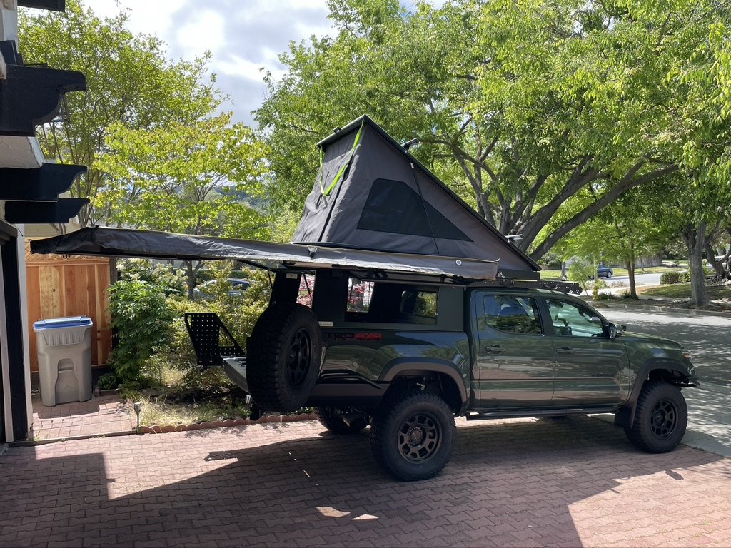

    Got the Mesa in April, haven't had a chance to do much camping yet.

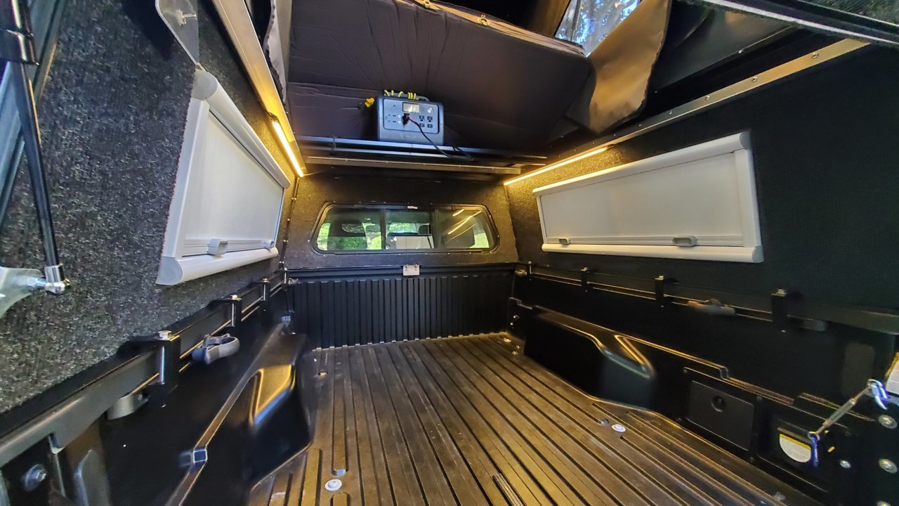

    Just thought I would share. Finished insulating the inside. Wasn't the easiest thing in the world but my first time doing it.

    Nice! That's one of the first things on my list. Do you mind sharing what you used?

    Sure I actually kept it pretty cheap going to home depo. I used the ridge foam board there and only needed one 8x4 board and the carpet available in bulk. I used spray adhesive and insulation tape to keep in all together. I did use reflectix around the back window since it was easier to work around the gaskets and bolts for the locks.
    I only used the spray adhesive to mount the carpet, if you cut the ridge board just right, it will be a tight fit. It also leaves some air gaps between the aluminum wall and insulation which I hear makes for better working insulation.

    Thanks for sharing! This is def another method I have not thought of, especially leaving an air gap between the wall & insulation. Might ponder on that idea.
    I have not gotten a hard date for installation, but can't wait for it.
    Let us know how the insulation holds up in the future!

    I’ve insulted mine exactly the same as yavin4 and it’s been in use for well over a year holding up great. Only issue I’ve had has been the need to reapply spray adhesive to the back of carpet and face of insulation due to slight peeling. I went with speaker carpeting with a backing meant for this as well. It’s a real cozy place to be with the full bedrug as well.
