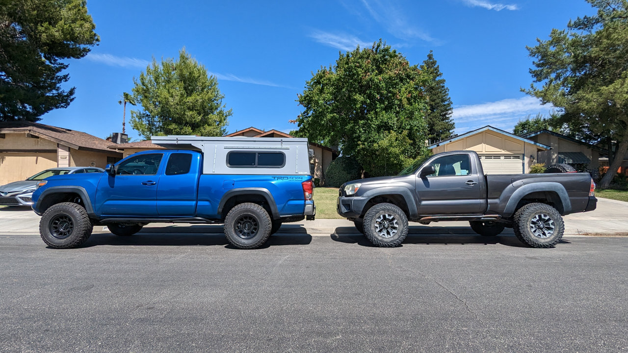

    Transfer went well and it fits like a glove! This pic is before I swapped the Deaver's over, so the back is sagging a bit.

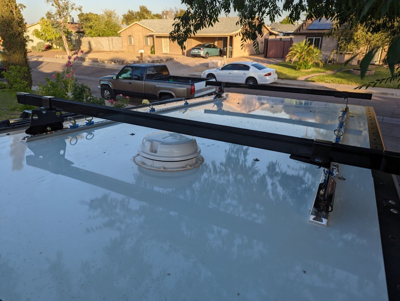

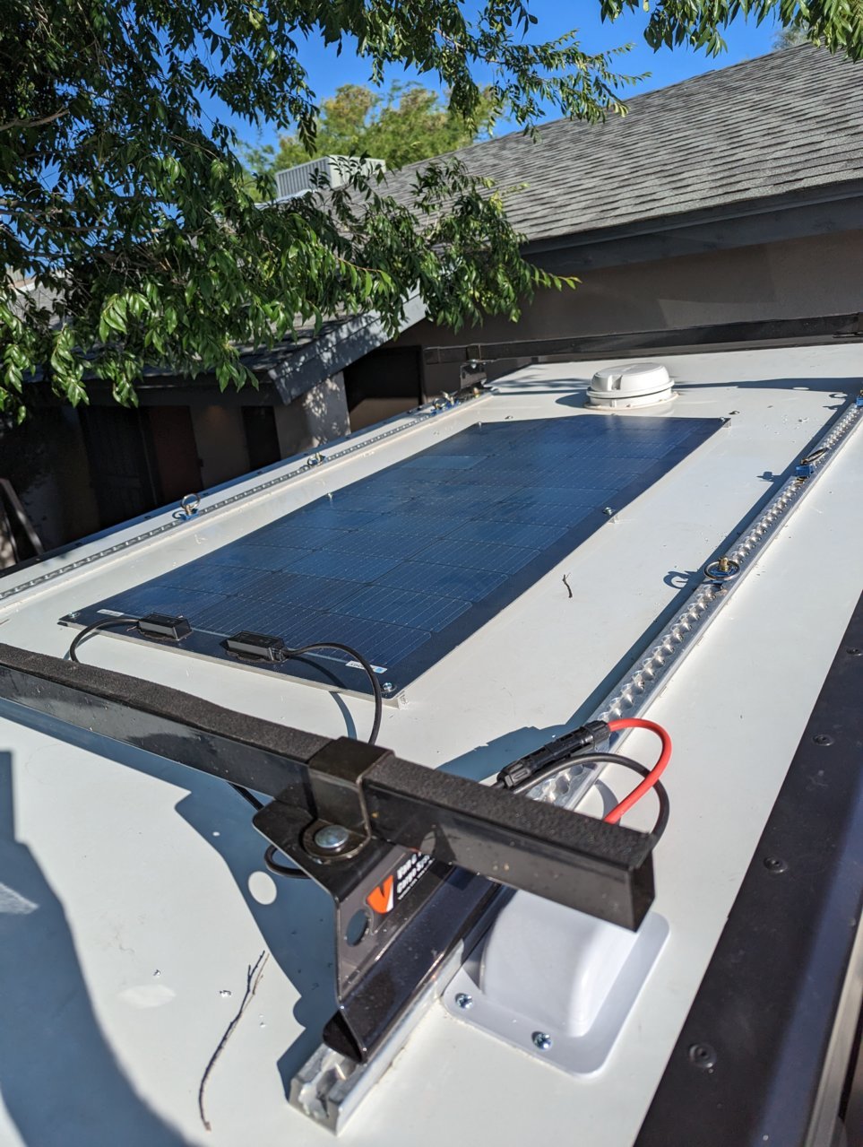

    I added solar to mine and used what was recommended above.

    jpmurph - any more pics of that rack on your truck and which size did you 50-55-60? Eyeing j1000 vs m1000 wondering if the price is worth with lower profile 3.5 vs 5 inch height?

    How many watts is that panel? And what adhesives did you use? I’m pretty hesitant to adhesive mount a solar panel as I know a buddy who had a bad experience. (It was about 8 years ago so I assume tech has gotten better)

    I believe this is the Renogy 100W black Division Panel.
    https://www.renogy.com/100-watt-12-volt-black-division-lightweight-monocrystalline-solar-panel/
    @Jpmurph I would like some more info on how you mounted these panels as well. I have (2) of these same 100W Renogy Black Division panels mounted to my camper (DIY not a TopoTopper) using VHB tape. I am having issues with the panels getting very hot to the point that the roof panel bows up slightly from the expansion. I think I need to install them in a way that creates a larger air gap for cooling like you did.

    Yea, no adhesives were used. I bought an aluminum c channel/u channel from Home Depot and cut three of them to proper lengths of the panel. something like 1/8" material with a 1/2" or 5/8" channel. Placed the open side down towards the camper and drilled two holes of corresponding lengths to the panels mounting holes. I used three aluminum lengths overall but there may be benefit to using more supports. I Used machine screws with a washer on top side and a nut on the bottom to fasten it. Making sure the panel is taught is important so it does not sag. Ive driven about 4k miles since install and have a small amount of sag that could have probably been avoided during the install phase. A sealant at the penetrations may be beneficial but I have been in a couple of rain stores with no water ingress.

    That looks like a solid solution! I have been trying to avoid drilling holes in the roof but I may need to bite the bullet. Out of curiosity, what kind of Watts are you getting out of that single 100W? Im wondering if the temps could be impacting my efficiency as well.

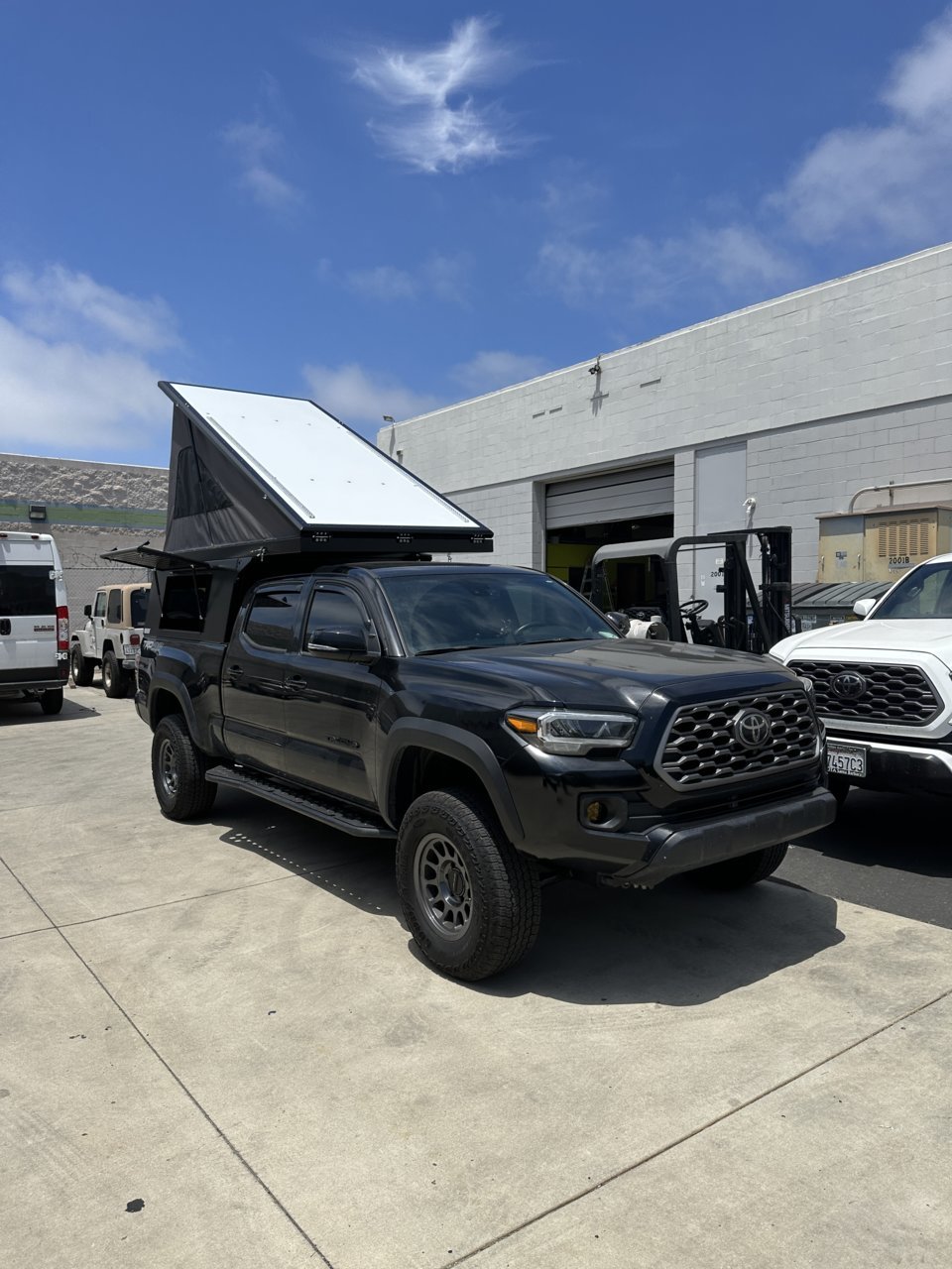

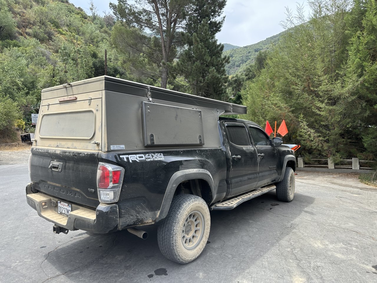

    Day 1 with Mesa from TopoToppers!
    First night was awesome!
