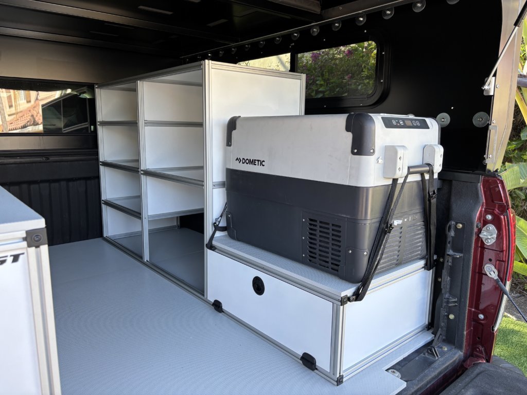

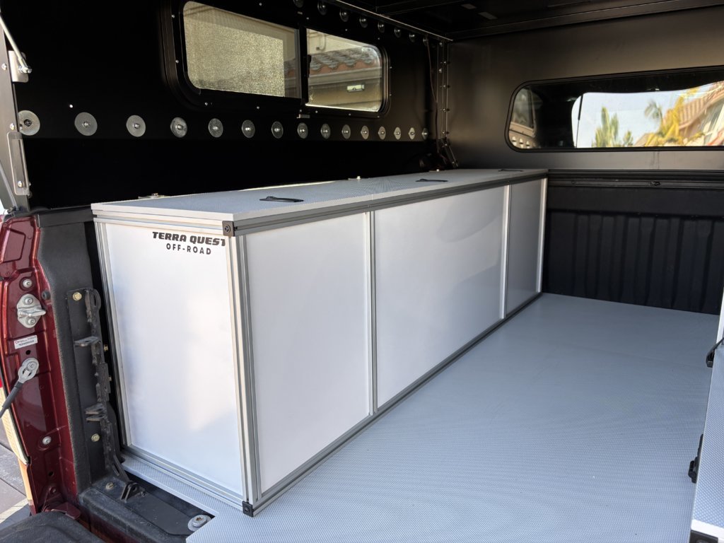

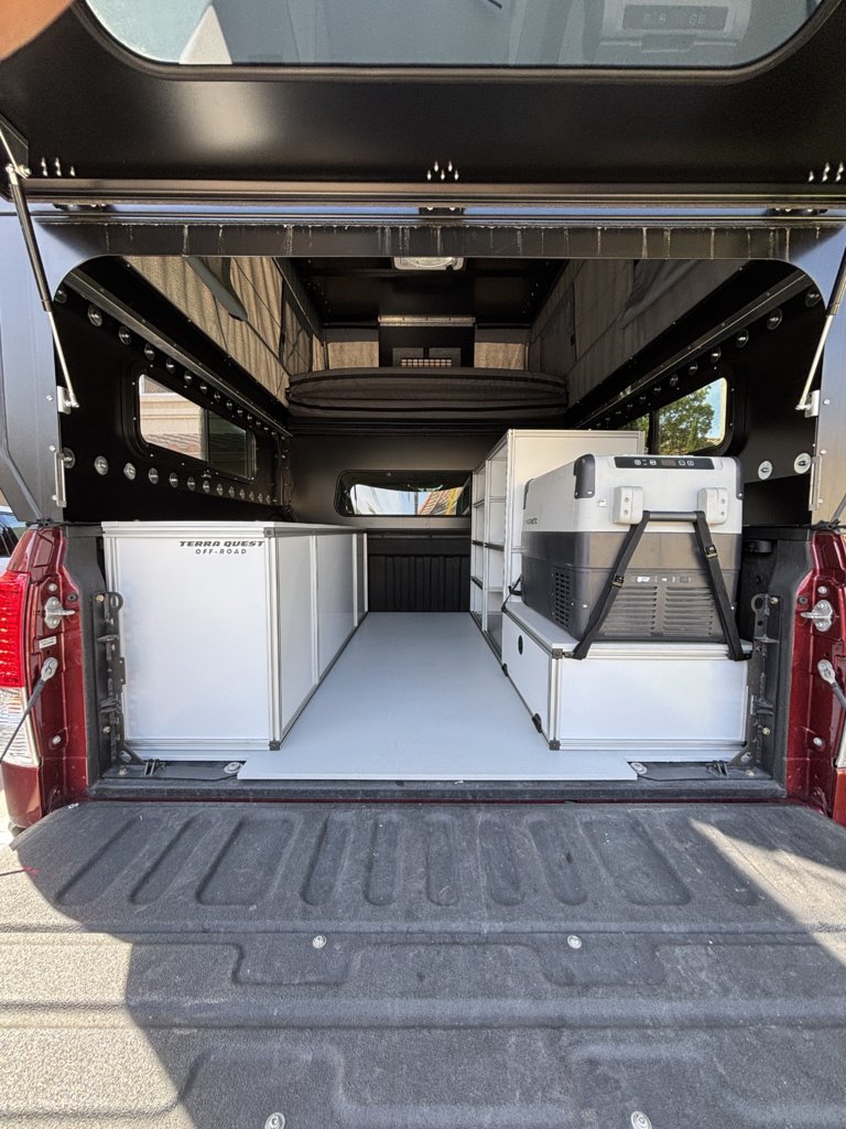

    Love my interior! It's perfect for my needs. Storage for days how I designed it. I have no idea what to put where cause there's so much room!!

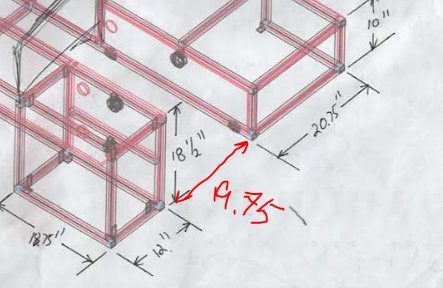

    Would you be able to share your cabinets width (left and right) with me? I am trying to decide whether I can narrow the right side a bit so i can have couple more inches passthrough width.
    This is the tacoma's kent 1.0 dimension.

    Will do, I’ll get you the dims. You’ll be pretty limited with the Tacoma bed on with. If you plan on sitting on drivers side bench, keep in mind 12” is a little uncomfortable when you have the bed rails protruding out and into your neck/back.

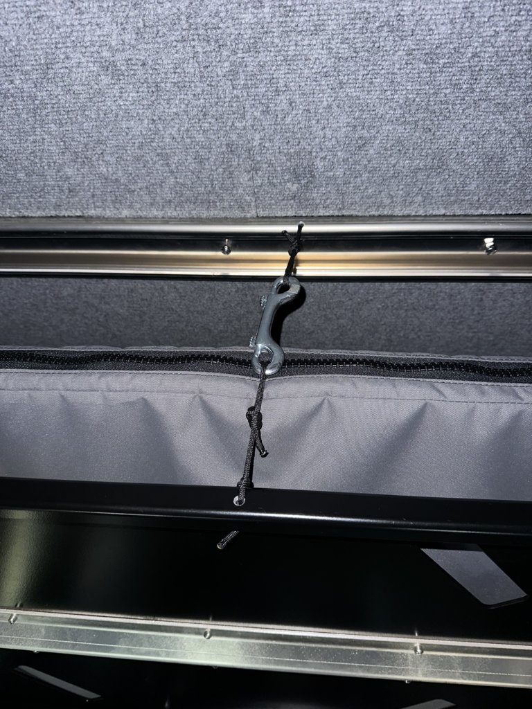

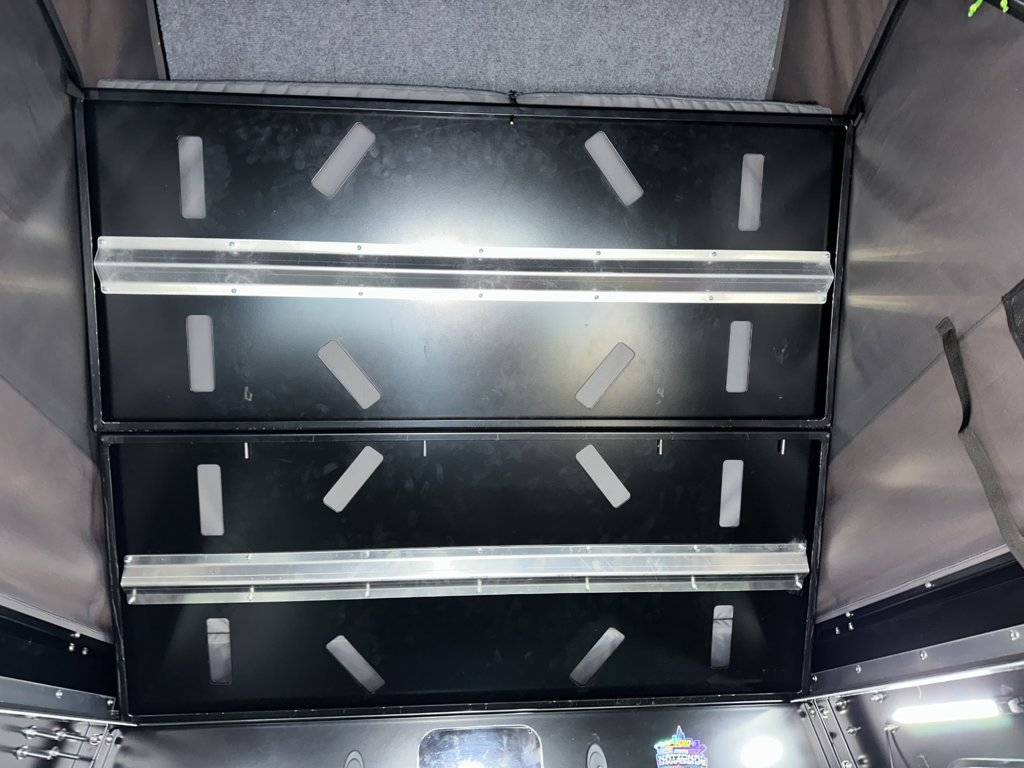

    Yep just bolted them together with 4 bolts. They do not clear it perfect when lifting straight up, you have to lift one side slightly and pull a corner up first to clear them, then there is no issues. It takes a little getting used to, but once you do its no big deal and is worth it in my opinion. If you used plywood or something else, taking off a 1/2 inch from the width of these panels would probably be perfect.

    Definitely enough for some pillows, backpacks, etc. You can adjust the room by the length of paracord and what angle you want the panels to sit while attached to the roof.
