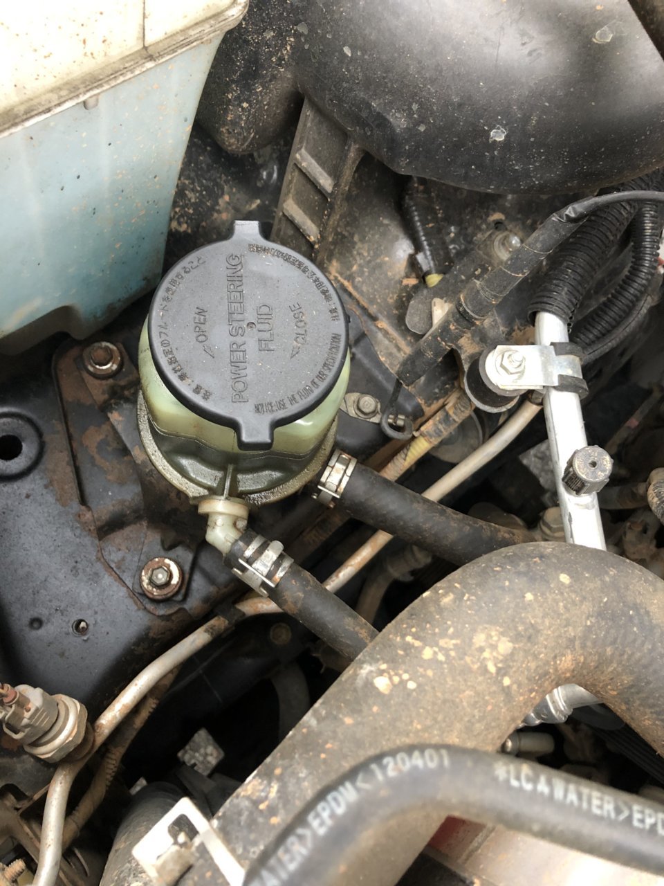

    Thanks for the help! What is the full name of the fluid recommended? Is this only a toyota thing/brand? Will see how far I can get before sending an SOS via pm lol

    I usually just use a generic Dextron/mercon ATF. Usually whatever is on sale.

    If you don't want to mess with taking the top off of the reservoir I was able to clean mine out with an acetone bath and then shop vaccing from where the cap goes. Everything came off the screen.
    For fluid I used Valvoline full synthetic ATF.
    I also have added an inline filter and power steering cooler but that's more than y'all need.

    I thought about going that route but to be honest I found it easier to bust mine apart it was so filthy.

    I changed the oil and cleaned out the reserviour. The reservouir was not as dirty as I thought but they oil was terrible. My guess is that it was breaking down at high temps. Took it for a test drive and so far so good. thanks for all the input.

    Am i correct on the return line being the one on the left?
