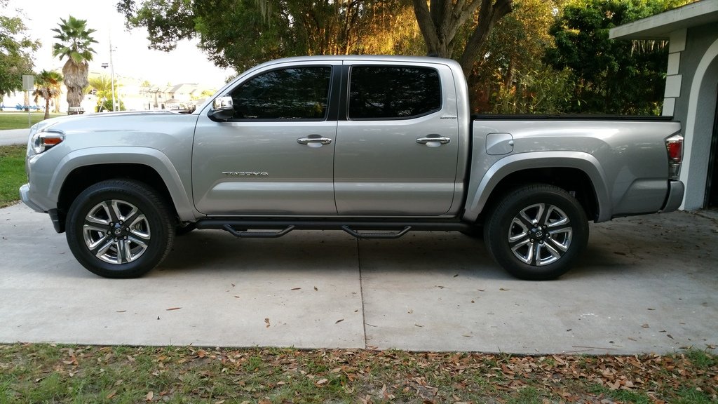

    I got mine and installed them. But I have to make some modifications.
    On each side there are supposed to be 5 bolts that hold the steps in. But on the drivers side only 4 holes line up, and on the passenger side its worse! I was only able to get 3 of the bolts in.
    I called running board warehouse, and they gave me a partial credit because I'm going to have to drill the holes out so I can get the bolts in. We decided to go that route because repacking these things and shipping them back is to much of a pain, plus, the holes are only off by a few millimeters. But I suggested he call Nfab and tell them to double check their jigs.

    Thanks for the advice, and I understand what you guys are saying, and I actually used that method to mount them.
    But I have a feeling I'm going to have to do some cutting and here is why.
    The problem I have with the passenger side is only one hole on the middle bracket lines up. So I can start one bolt in the middle, but I can't even start the other bolt on the same bracket because the slots are cut to close together. Even if I let the bar dangle all the way down.
    I know you have to muscle the bars to get the different brackets to line up. But it's not like I can stretch the bracket itself.
    So I'm able to get one bolt in the middle bracket, then get the front to mount (that only takes one bolt), and then I have to muscle the back bracket into position, but again, it has the same problem as the middle bracket. I can only get one bolt in. Once it's in, I can't get the second bolt on the same bracket to line up because the slot is cut to thin.
    Don't worry I'll get it to work :)

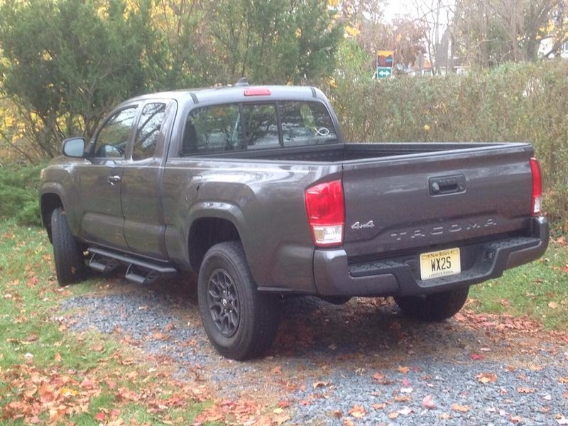

    Yup, got it two weeks ago. Got the Predator steps (OEM) from Mid-Atlantic Toyota on Thursday and put them on this morning. Very satisfied so far. Went on in about 20 minutes and they are made of aluminum so they will never rust.
    I did take the precaution of putting some Loctite on the bolts. They had flat washers only. There were also two extra thick flat washers that I couldn't figure out what to do with. No instructions.
    - NF.
