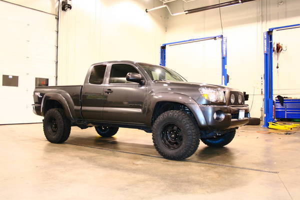

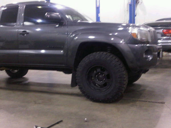

  8. Oct 30, 2010 at 5:50 PM

  9. Oct 30, 2010 at 9:40 PM

    DONE! what a relief
