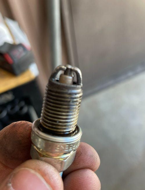

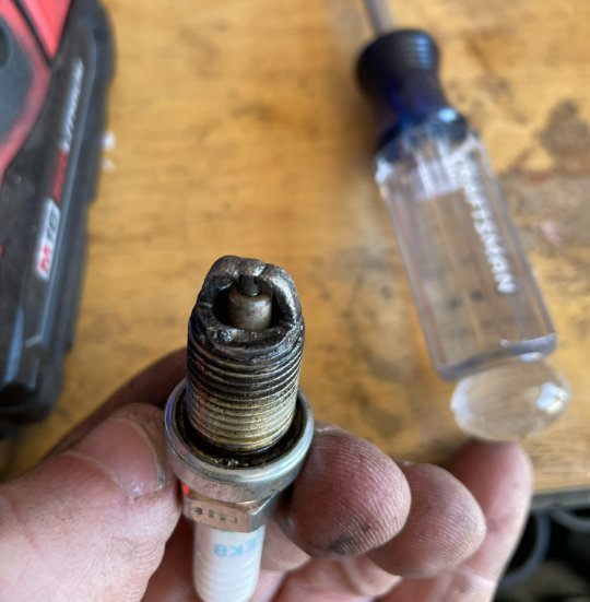

    Ok, so finally got to tear into the truck and the first thing I did was pull #6 sparkplug and this is what I see. Began pulling everything off to get access to timing junk so I can pull the head. Anyone seen anything like this before?

    Your engine Ingested some FOD thru the throttle body , either a screw or bolt , The closed plug gap is a dead giveaway . The sound you're hearing is something inside the cylinder being pounded into the combustion chamber of the cylinder head . At most that combustion chamber is trashed as is the cylinder wall and top of the piston
    wilcam47 and Deathbysnusnu like this.
  12. May 10, 2022 at 5:06 PM
    US Marine
    US Marine Semper Fi
    Mar 24, 2016
    #182227
    14,751
    Chuck
    Gallatin Tennessee
    02 Pre Runner supercharged 4cyl
    TRD supercharger , Doug Thorley header , K&N CAI 265/75-16 Toyo open country mud terrain , 15x8 Method Racing wheels , Rancho 3" lift , 4.88 gears , Detroit Locker
    The most common item that gets sucked into a cylinder are throttle plate screws . Such a tiny screw can cause alot of carnage , I've even seen it punch a hole in a piston

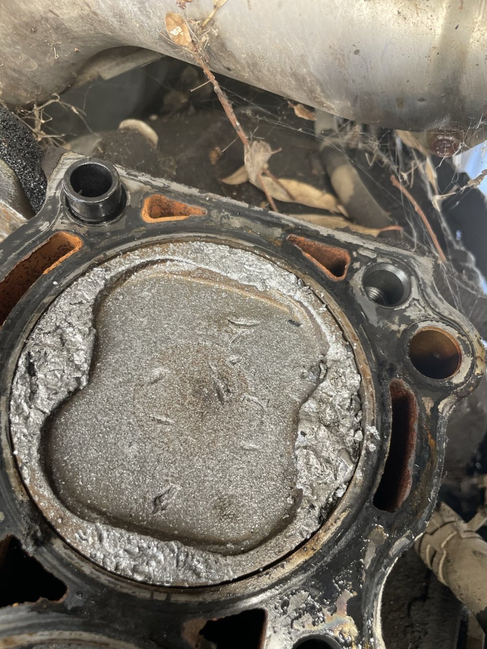

    Welp, I'd say she's chooched. Anyone know if these engines are sleeved? There is some scoring on the cylinder walls that'll catch a nail but its not insane. A relative who does all the Toyota heads around is going to swing by and have a look, I have no doubt the head is toast. Local place can get a long block with 140ishk on it for $1750. Might be the way to go.
