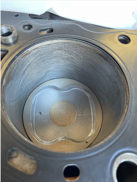

    What sucks is every other cylinder came back with 200+psi on compression. Sad to see an otherwise very healthy engine at 250k have such an early demise. Ill take a picture of what I found inside, doesn't look like a screw/bolt/nut. Its a shard of steel.

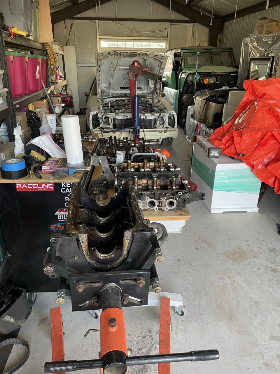

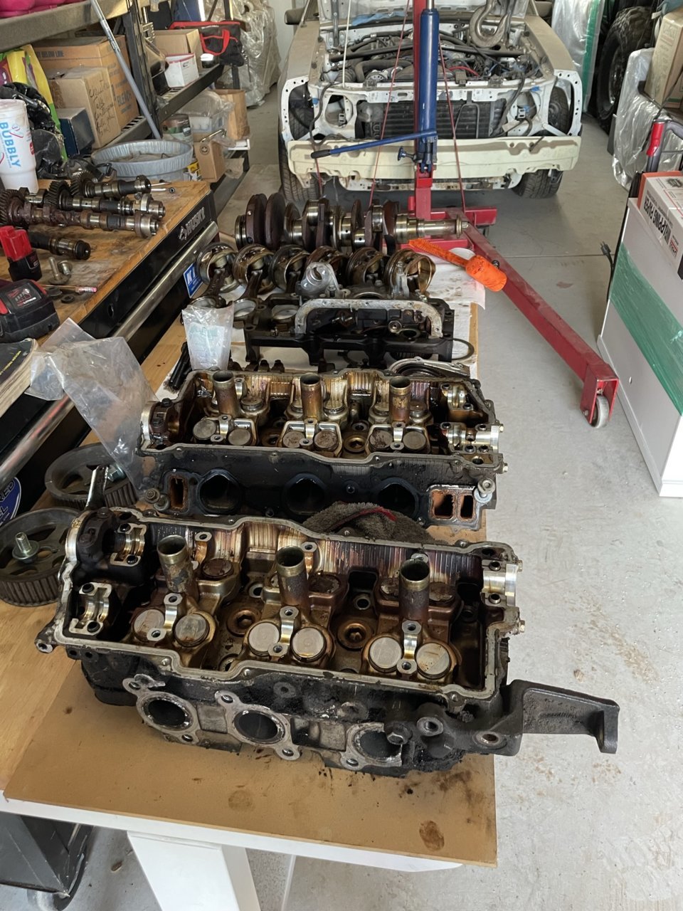

    Picked up a 3.4 with blown headgaskets. Block looks good, gonna have the heads rebuilt, Im praying they aren't cracked and will pressure test alright. Im planning to get one of the all OEM kits off ebay seller: aircabinman There seems to be a few vendors that deal with the 3.4's headgasket kits. yotashop, yota1performance, and lcengineering. The first two sell the stone brand and lcengineering doesn't specify. Anyone have any first hand experience as far as quality? Am I good to go between any of them? Enjoy the donor engine tear down:

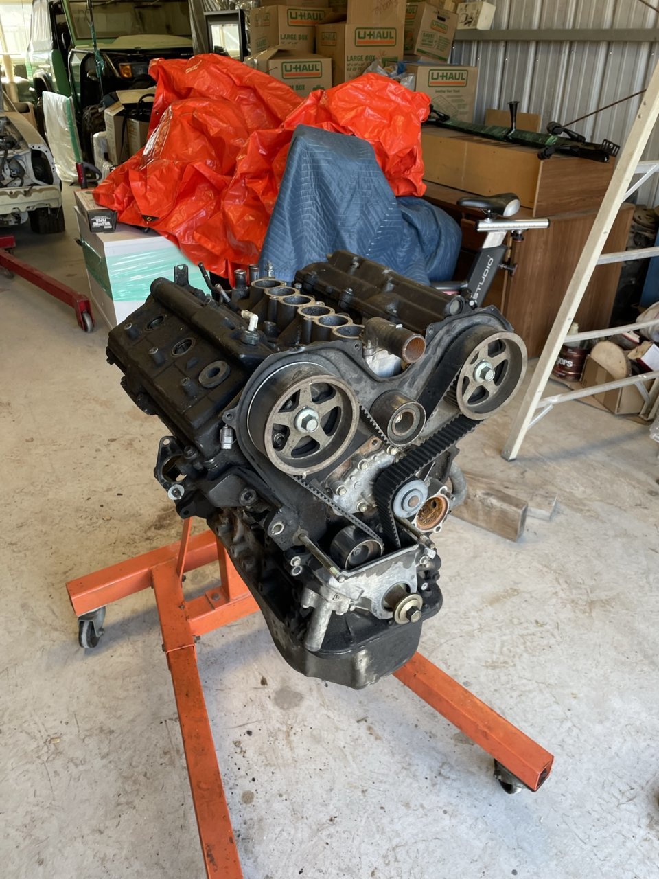

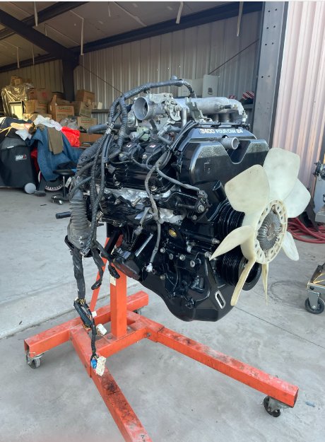

    Been a while. Everything checked out and truck is now 4wd, 5 speed, and on the road. A few pictures of the process to follow. I picked up an e-locker axle, harness, and switch but the dude didn't have the ECU. Anyway I can bypass the ECU and still use factory switch?

    I've rebuilt a couple of 350 gm motors and one Ford 300 straight 6. Looks like you've done a fine job fixing this Truck up. With a rebuilt engine, you should be good to go for 400k miles or so. Pat yourself on the back for a job well done.
