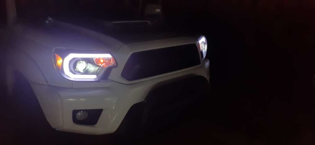

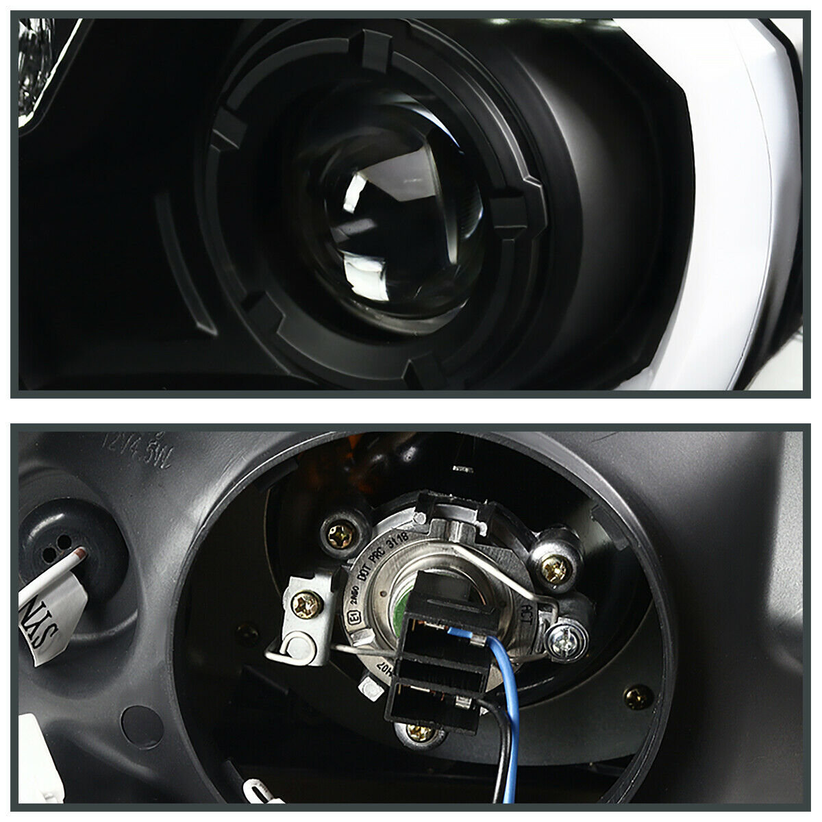

    Here's pics of what I bought. Hope they show up...

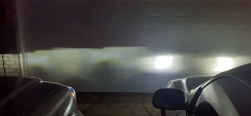

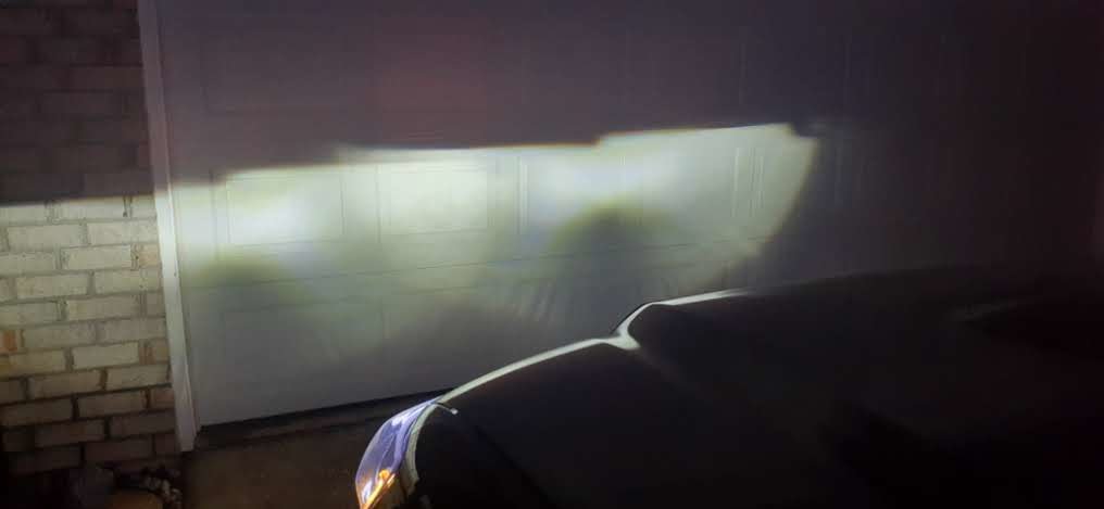

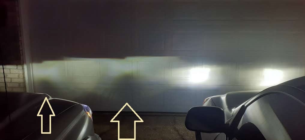

    the halogens that were shipped weren't bright at all, and the LED's were a little brighter... and I'd put the stocks back in, but the side plastic piece that bolts just in front of the wheel wells broke off when I was removing them... I should've watched a YouTube video before, I know... I'm just looking to salvage these projectors, if I can...
    Here's some pics against my garage... Left is my Tacoma, right is 08 Rav4 with stock lights that I replaced bulbs with LED's that are much brighter than my new projectors...
    should there be this round void where I put the arrows...?
    Did I adjust them wrong? Did I buy the wrong LED bulb?
    Thanks for your help...

    The harness will definitely give more power to the headlights but the headlight bulbs you have are not the best for projectors. Look into the bulbs that have LEDs all the way around for projectors it should eliminate your dark spot
