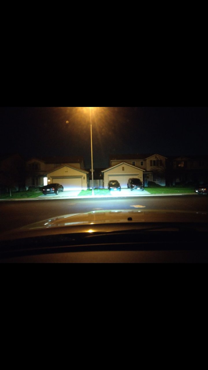

    Look into this pod light is Dot SAE fog lights cost about $85. The picture is without headlights.
