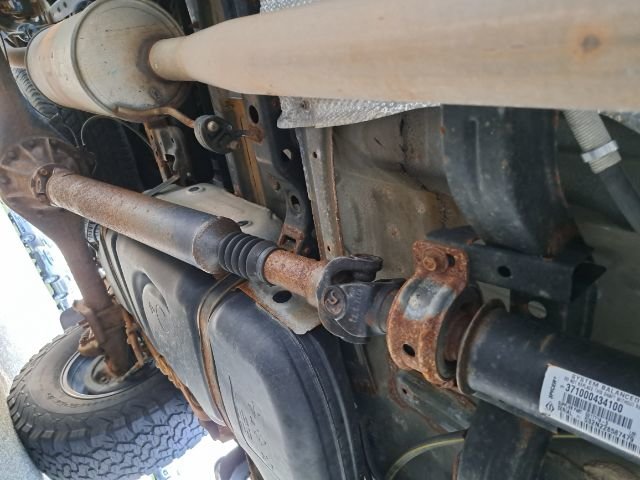

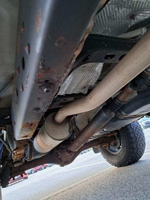

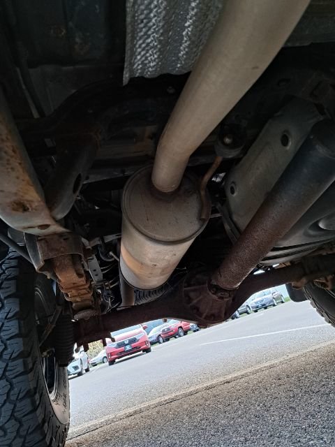

    Yea sooooo… the verdict is in. Frame, rear diff, leaf springs, suspension components were too crusty for my liking. a buddy of mine went to check it out for me, plus the sales rep sent me some flicks. Of course he didn’t send the worst stuff, however you can still see what’s learking. Carfax doesn’t say anything about a recall or frame maintenance… I called Toyota to make sure their wasn’t a frame recall open. Im wondering is I should keep trying for a second gen. At these prices with these frames.. man it’s discouraging.:(870D73F9-FD09-444B-844A-B9122D04A263.jpgDB557B02-6E5A-452D-8151-920137F15263.jpg359C90EF-DE5C-4BDD-B84F-C131C920E332.jpg

    This truck is still under the frame warranty time frame.

    2nd gen Tacomas that are in rust belt states have an extended frame warranty for 12 years from the first date the truck was registered.

    Basically, they only get replaced if there is a hole found in the frame. The frame could be crusty as hell but if there is no hole then toyota says its safe.

    Right I see.. plus the diff was crusty, suspeention components, leafs.. who wants to pay over 20k and still have to put in all that work!?
