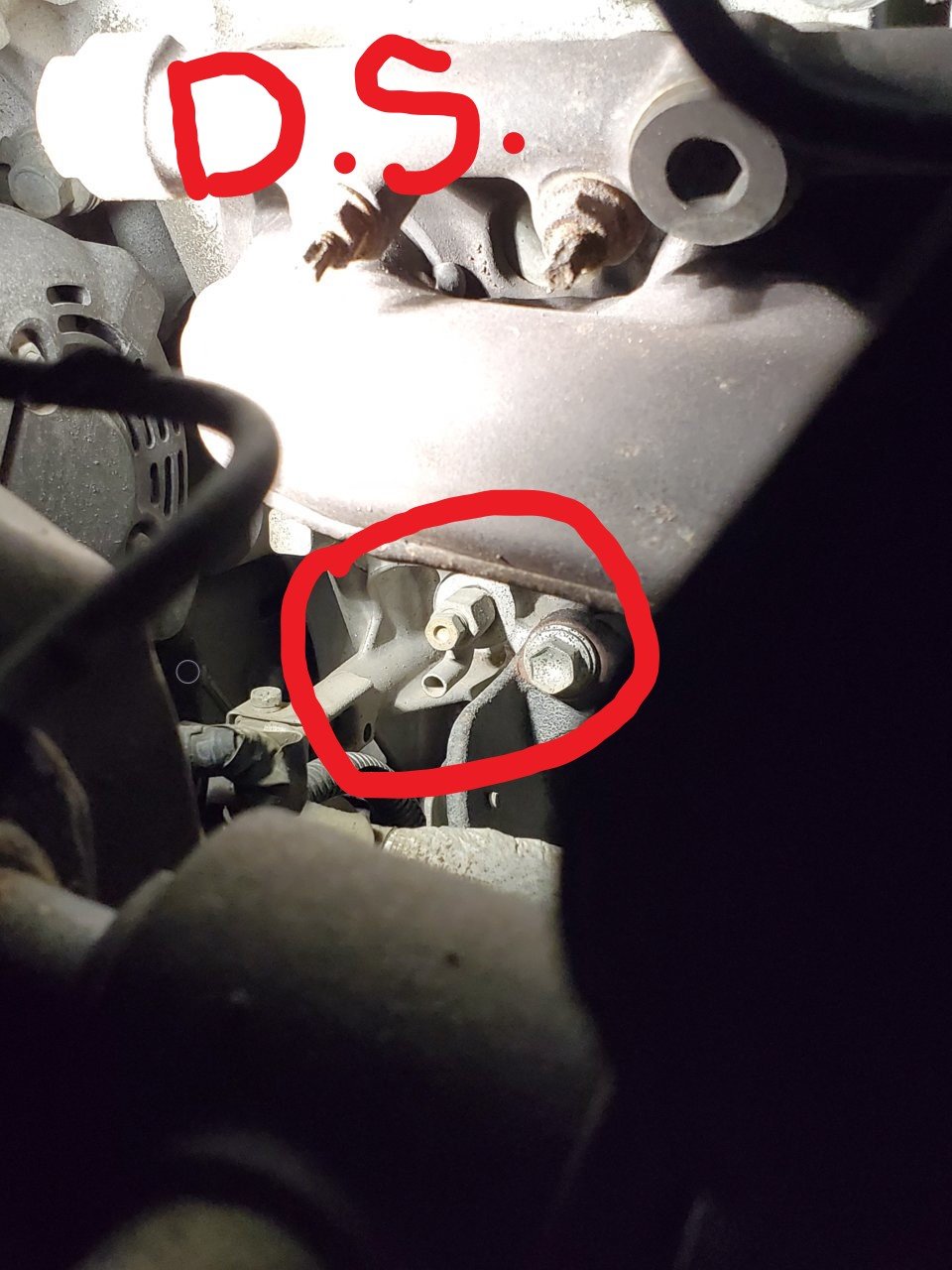

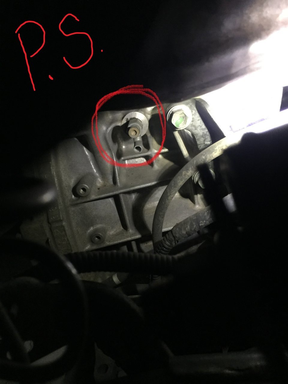

    Here are a couple of pictures (found here on TW) showing the DS & PS block drains. The PS is very accessible and I drain that one first.The left side (DS) can be a little tricky to get to, but it can be done. As I've said before, (at least for me) very little coolant drained out. Before I attempted to loosen the block drain bolts I sprayed a little PB Blaster on the bolts.
    This youtube video is one of many on coolant changes. Just like the number of past threads here on TW on changing the coolant in your Taco. I would strongly suggest you look over those threads and watch a few videos to become more familiar with the process.

    thank you very much for the help and the props!Is the ps side an allen bolt?I hear ya about the cackling lol,thanks.

    CC TX
    07 AC PreRunner TRD/Off Road
    Not and allen head, I believe it was a 10mm. You'll need a long extension too.

    I can not seem to find the driver side petcock? i had your pic out there with me and still i can't find it is it pretty much like the other side inline with the tire?Also,did you have the heater on while flushing or just when you added coolant? Also i got that funnel kit as well!
