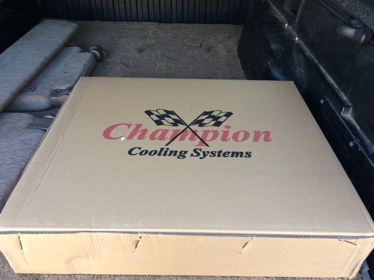

    FYI: Champion has their 95-04 Tacoma radiator back in stock.

    Looks like your in luck, they are back,

    Remember to swap out a different radiator cap as the champion radiator caps are not the best

    I have one that was meant for a plastic tank rad I bought over a year ago lol. Thanks for the reminder. Next week I'll plumb this bad boy in!
