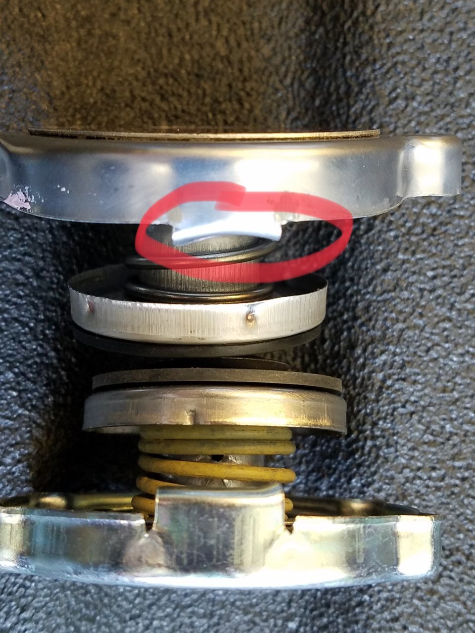

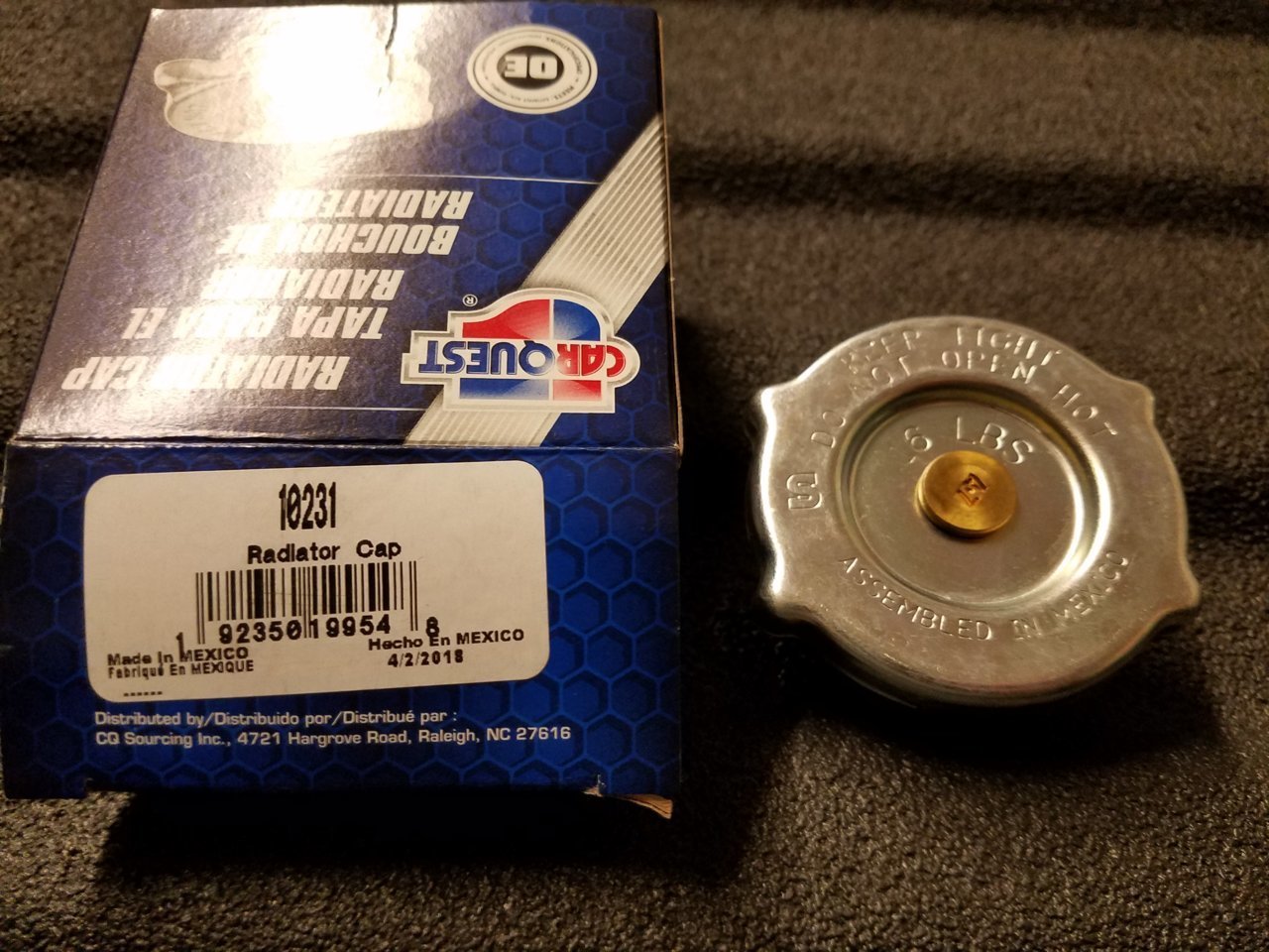

    I remember buying an after market radiator years ago that did not come with the cap and the oem cap
    did not fit in it that’s why it might not fit. 50/50 chance.
    The champion cap the lock down taps are made of thinner steel and tend to bend and then the seal leaks,
    This is the one I ended up getting for 10.00 or so
    Dalandser[QUOTED] likes this.
