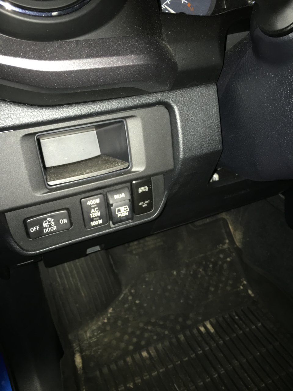

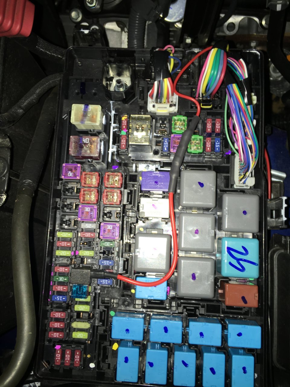

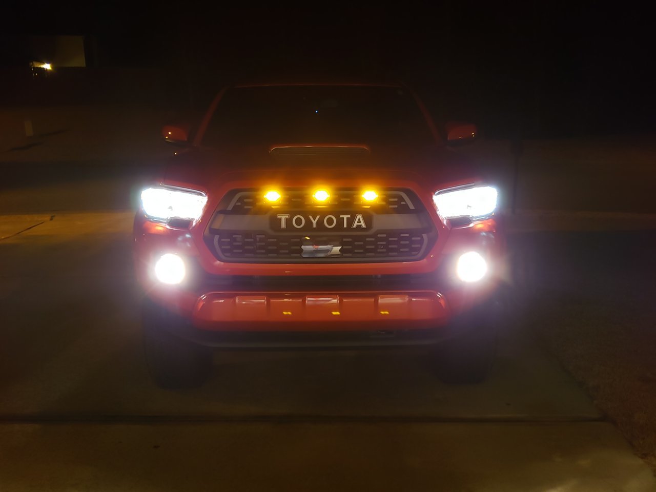

    43DB527E-857A-464F-A9B8-4C4BB5813747.jpg 8FE2143B-894C-499A-81F0-C412D6F24DD1.jpg 20CC601F-C6EC-429F-B14A-7E744D830CD6.jpg 349080D1-4F38-478B-B385-F77DD26CCCE0.jpg A38932AE-B976-484C-A674-00EB24977A78.jpg
    Using the raptor kit harness previously installed, I moved the tap fuse (power wire) one row over and used an unused position in the fuse box.
    I ran a ground wire from the engine bay black wire thru the firewall grommet and to the switch... used a grounding location behind the left kick panel and ran a ground wire to the switch. The switch disrupts the ground. I like that I can turn the ‘raptor’ LEDs independent of the other lights.
    The hardest part was pulling the wire thru the grommet ... it’s tight.
    I don’t have the switch lit up yet. Maybe tomorrow... that should be easier
    Edit: the grommet hole I used is also used for the hood latch cable
