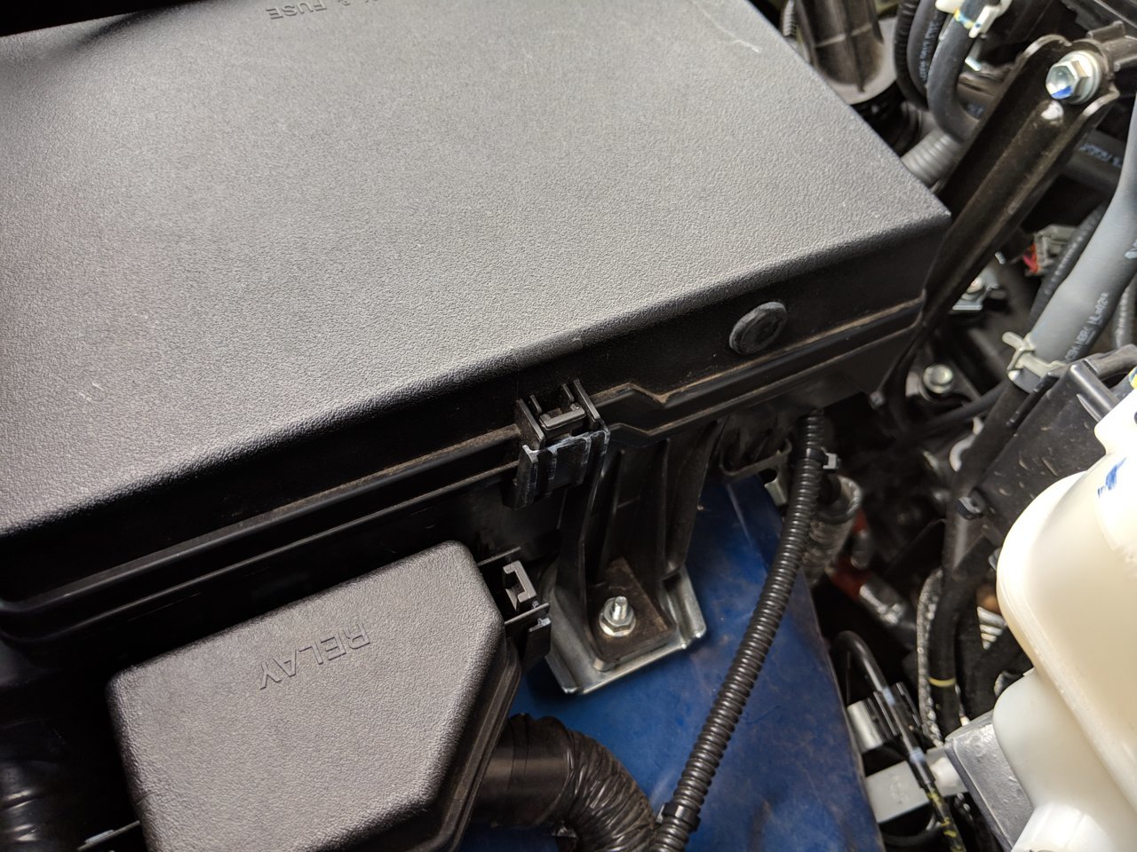

    In. Used the 10 amp ING fuse in underhood box. Used plastic loom on the wires with zip ties. Took my soldering pencil and put a tiny hole in cover. Pushed hot lead thru and soldered fuse tap. Left a little extra wire to remove cover. Real Happy . Posted another pic. Put the wire thru the plug like in some of the videos. It's easy actually and worked better.

    There is no need to cut the fuse box cover. You can run the wire through the larges harness [closest to the engine side).
    Pop it from the box, right side of the harness is moveable - up and to the right.
    After that, run the wire and put everything back

    I saw that post. I actually have a bolt on cover where the wire goes that will expedite other connections .

    IMG_20190114_154043.jpg Redid the power connection. Plugged the little hole. Just ran it under the plug like in the post . Too lazy the first time. Plus Beers were involved. Lol
