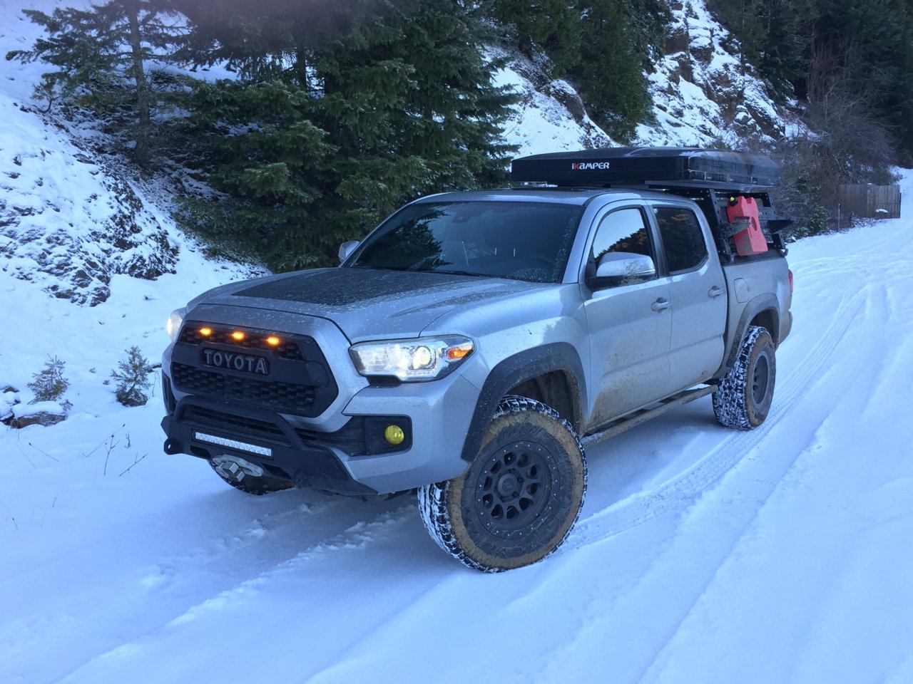

    #180710
    1,333
    Lee
    SE Texas
    2017 Tacoma TRD OR Quicksand
    Damn thats some major snow!
    Had a late night attack....bought some, 4 light kit, from running4Tacos.
    I plan to wire how you did it.
    Thanks for the info!
    Stay warm!
    BOMBS[QUOTED] likes this.
