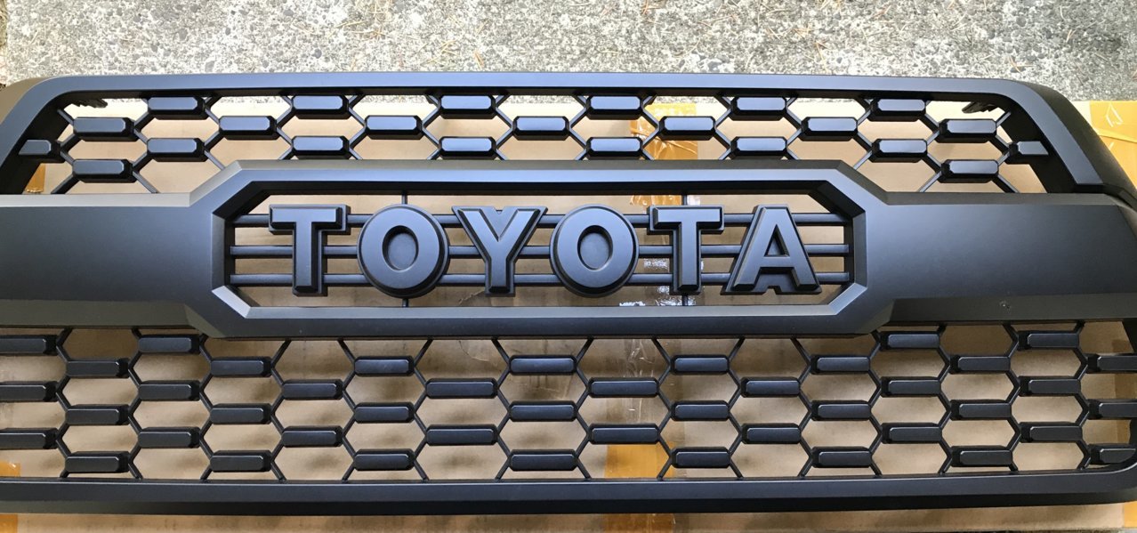

    I am contemplating adding a 2nd set. Currently, I have setup the 4 lights in the middle.
    I want to add another set of 4 on the bottom more spread out...
    Like this
    | TOYOTA |
    Muhahaha - Bring on the cops

    Eh, less is sometimes more.
