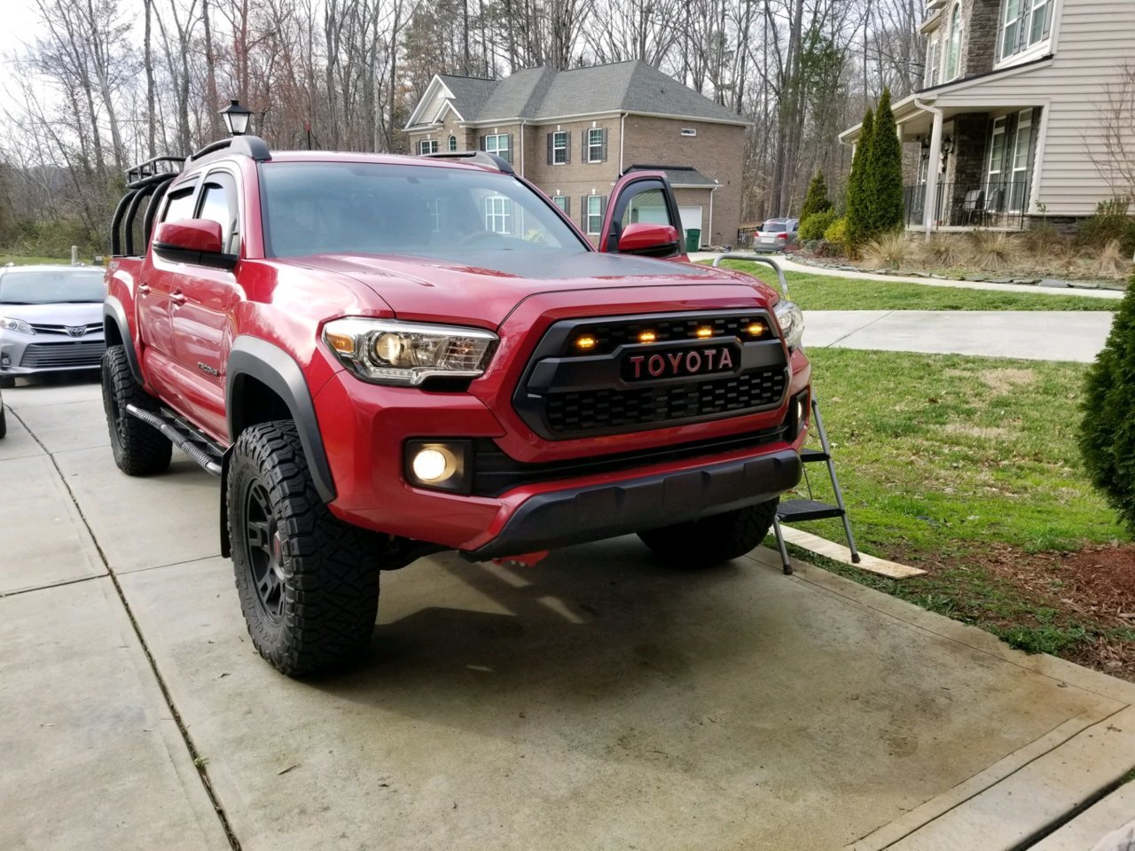

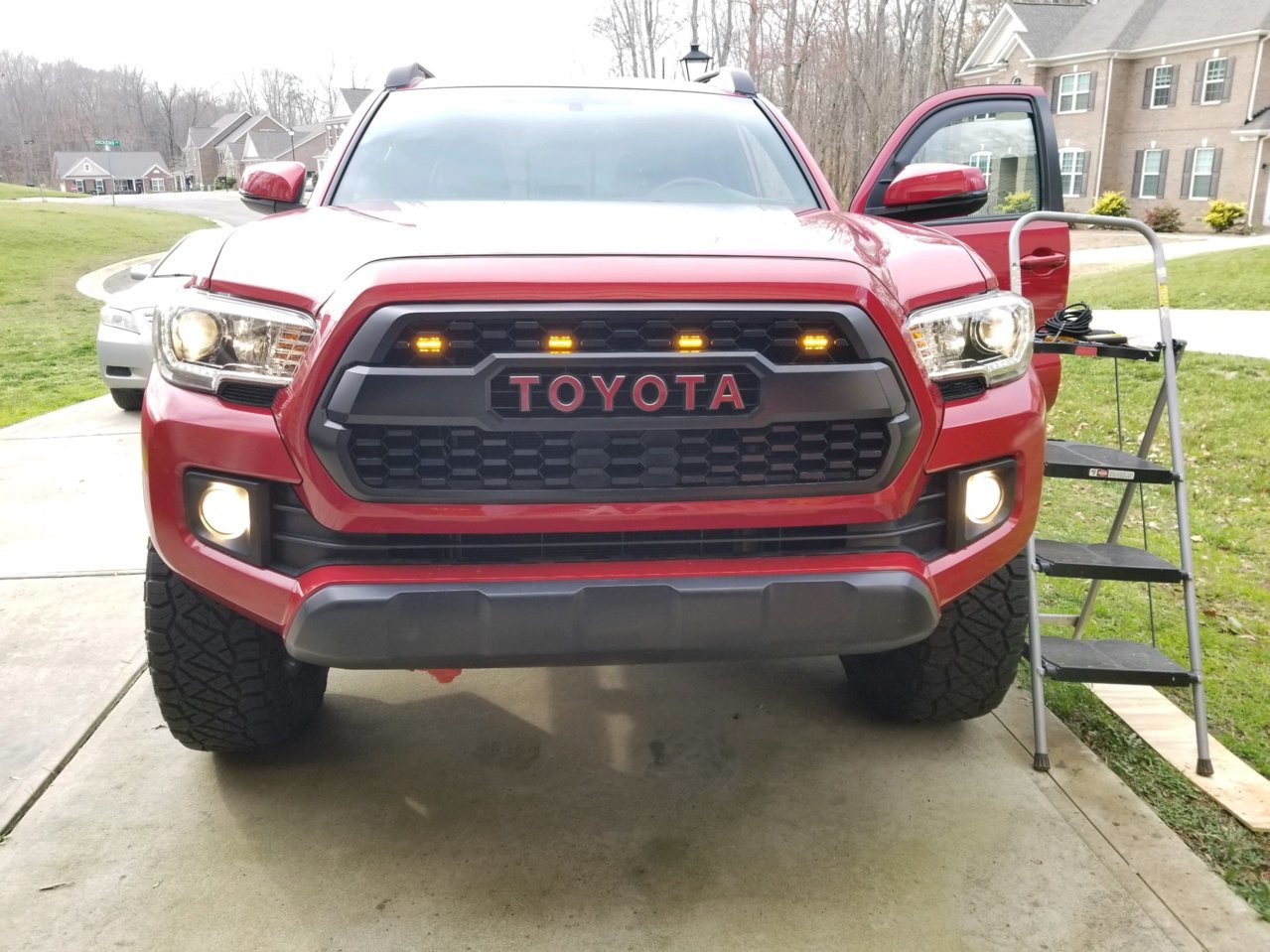

    I added mine to the 3rd row this past weekend. Bought them from Amazon. I just shaved a little from the sides of the two outer lights to make them snap right in. I think they look ok. Maybe when I have a moment I'll file off the grille's first row to make them fit. But I'm good for now, I like the way 4 look spaced out. Added a fuse tap to the headlight but may swap it to the INJ fuse for it to always be on when truck is on.
