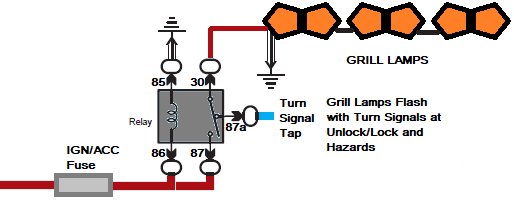

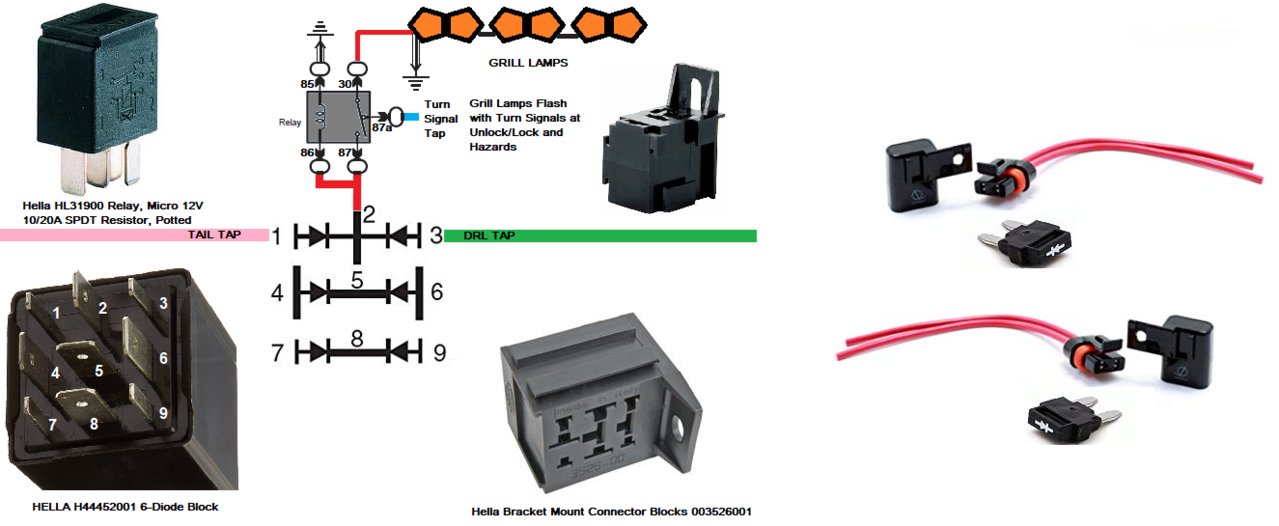

    oneup714 Well-Known Member
    Sep 26, 2018
    #267484
    996
    All show no go Super White Tacoma TRD Mall Crawler

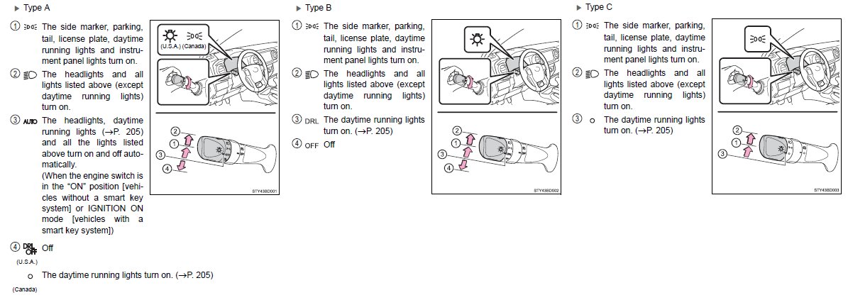

    I tried it like that initially and my grille lights would only turn on when the headlights switch was on the last two modes, fog lights/DRLs and headlights ON.
    Then I tried it with the pink wire only and the grille lights would only turn on when DRLs were on, not with the headlights on in night time mode.
    But wire it however you want, it's your truck. The way I wired mine worked exactly how I wanted it to work.

    So you're saying the headlight stalk on your Tacoma is unique. The "bottom" 2 positions skip TAILS? Also loosing TAIL (pink wire)input/power while Headlights is also unique. The TAIL circuit handles all the Front and Rear TAIL lamps. I think there's more to your install.
    Which type does your Tacoma have?

    I have type B, 2019 TRD Off Road. Even though it says that all, except the DRLs turn ON on position 2, on mine the DRL are ON as well but dimmed. And yes, the "bottom" 2 positions skip the TAIL but the "top" 2 position don't skip TAIL.
    Do your grille lights turn on always except on the completely off position just by tapping into the green wire? Mine do, in any of the other 3 positions my grille lights are ON.
