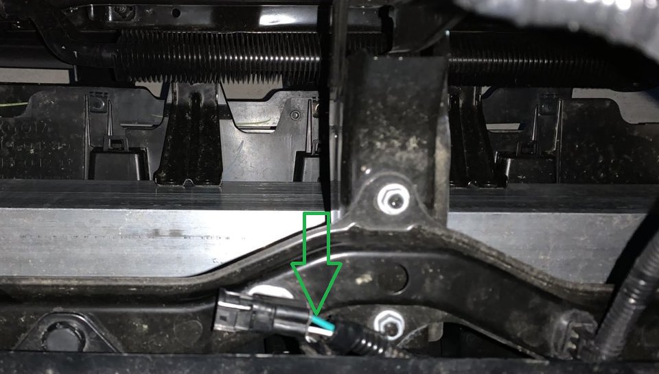

    Caribbean, Puerto Rico
    05 PreRunner TRD Offroad AutoTrans
    Hood Struts, My version Fogs always ON, Map & Overhead Light Mod,
    Tap into the green (+) and join to red (+) of your grill lamps. White with Black stripe to the Black. They will be on & off with the Fogs.

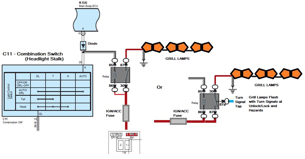

  11. Jun 21, 2019 at 12:05 PM
    #531
    caribe makaira
    caribe makaira Well-Known Member
    Feb 13, 2011
    #51121
    11,787
    For those with Auto Light Control and LED DRL and Parking lights and who keep the stalk in AUTO:
    or this
    Does not apply to Tacoma's with type B or C stalk.

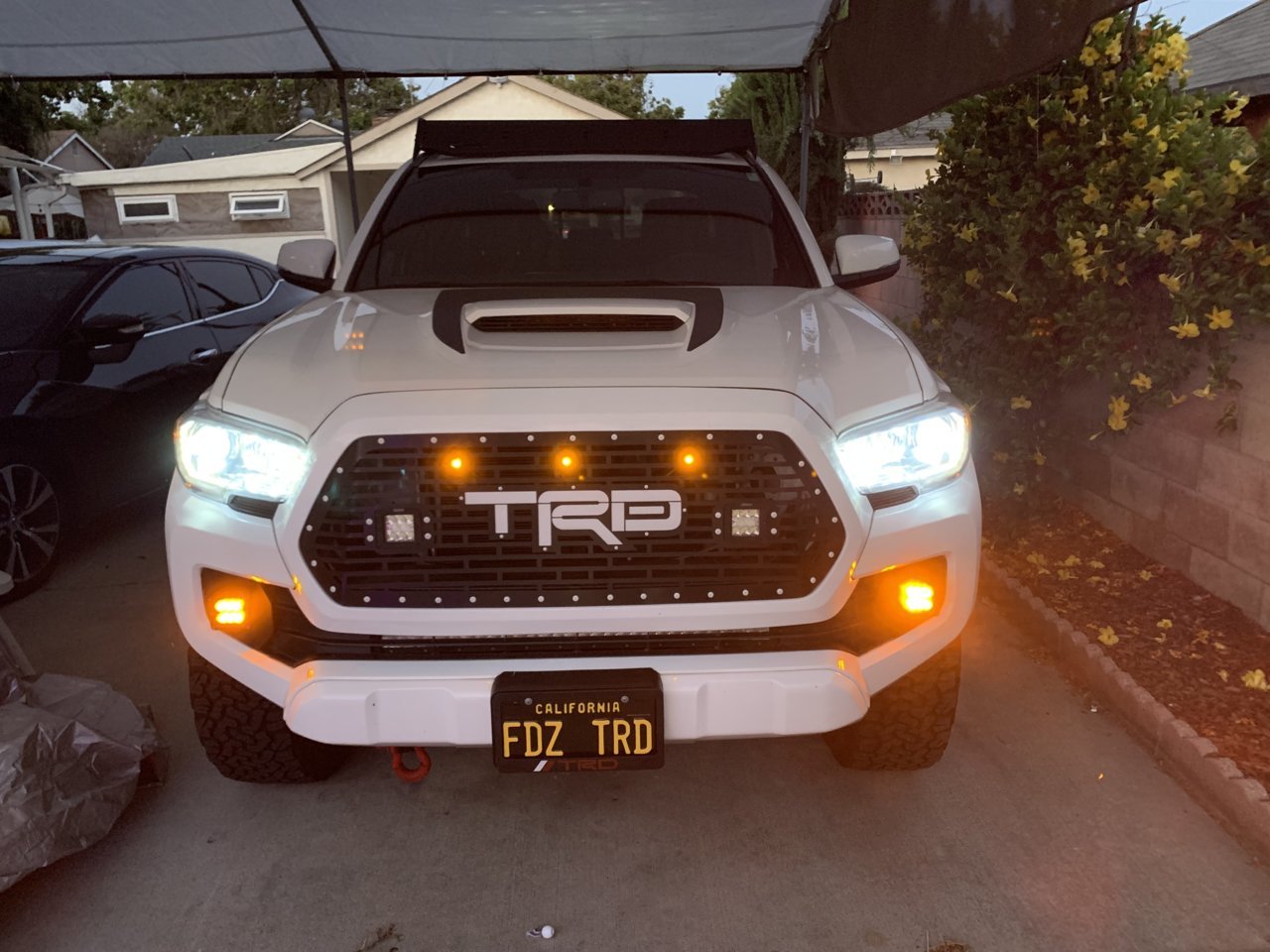

  13. Jun 21, 2019 at 12:27 PM
    #533
    SoCalTaco8
    SoCalTaco8 Active Member
    Aug 16, 2018
    #263072
    34
    Jerry
    Pomona
    2017 White Tacoma Sport TRD 4X4
    MBRP 3 inch Cat Back Exchaust, TRD Pro Grill, Speaker Upgrade, Plastic Dip Sport Wheels, Red TRD badge, Painted Red front Brake Calipers, Door sill Vinyl Letters, Tailgate vinyl letter inserts, Cabin LED Bulbs, Headlamp/Fog Light LED upgrade
    57D41E2F-8E40-47A1-BFB8-0903B7BF8174.jpg I made mine also, $20 lights from Amazon 57D41E2F-8E40-47A1-BFB8-0903B7BF8174.jpg

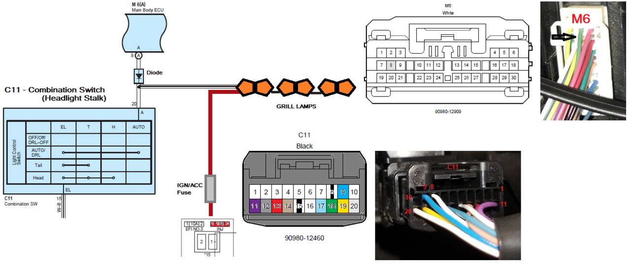

    65
    I wired mine to the DRL and did not do any splicing , use quick splice connectors . Worked awesome , and easy .

    2018 White Tacoma SR5 Double Cab
    I have a quick question and I'm sorry if it's been answered already, but if you connect the grill lights to the DRL will they turn off when turn your headlights on?
  20. Jul 2, 2019 at 10:34 AM
    #540
    Tacospike
    Nov 19, 2018
    #273198
    14,418
    512
    Two Trucks
    Yes, you just run them and splice to the DRL. That's how most people wire them I they don't use the add a fuse option.
