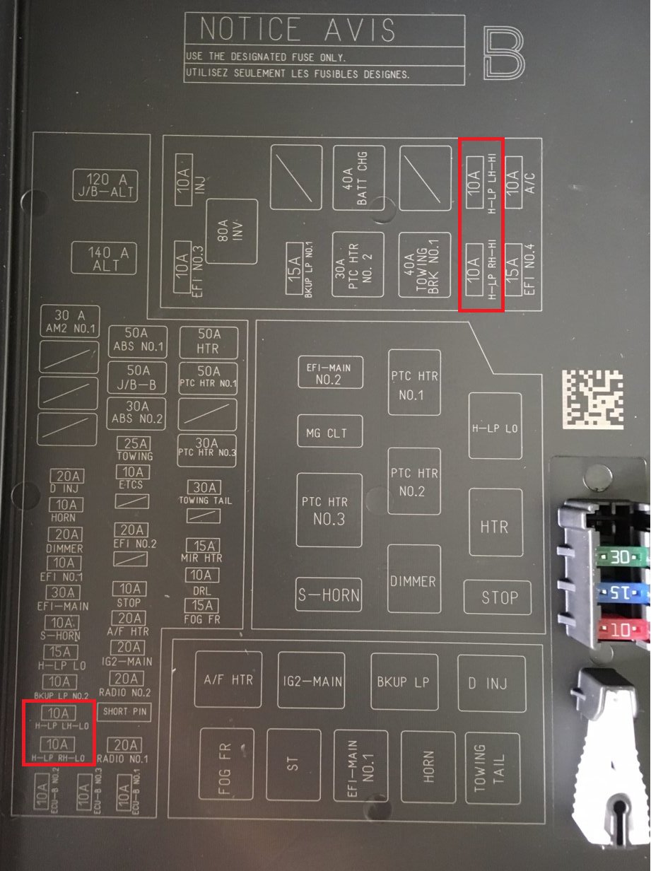

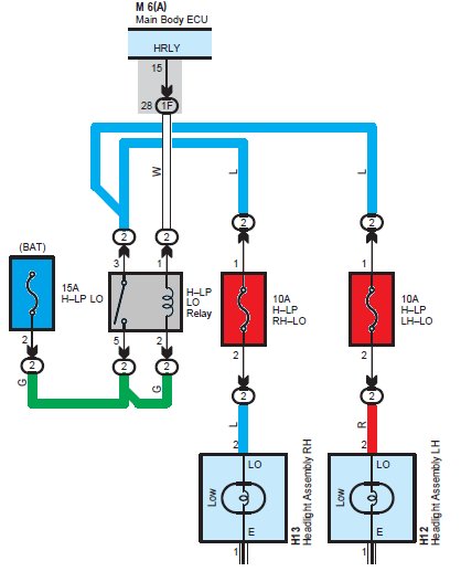

    Was this in response to me? I guess I am just confused about which fuse to tap into... I don't really use my DRLs much, and they aren't automatic on my truck (as far as I know), so I just want them to be on with the low beams and high beams. I see three fuses labeled H-LP LH-LO, H-LP RH-LO (assume these to be low beams for left and right?...) and them H-LP LO (Why is there a 3rd?)

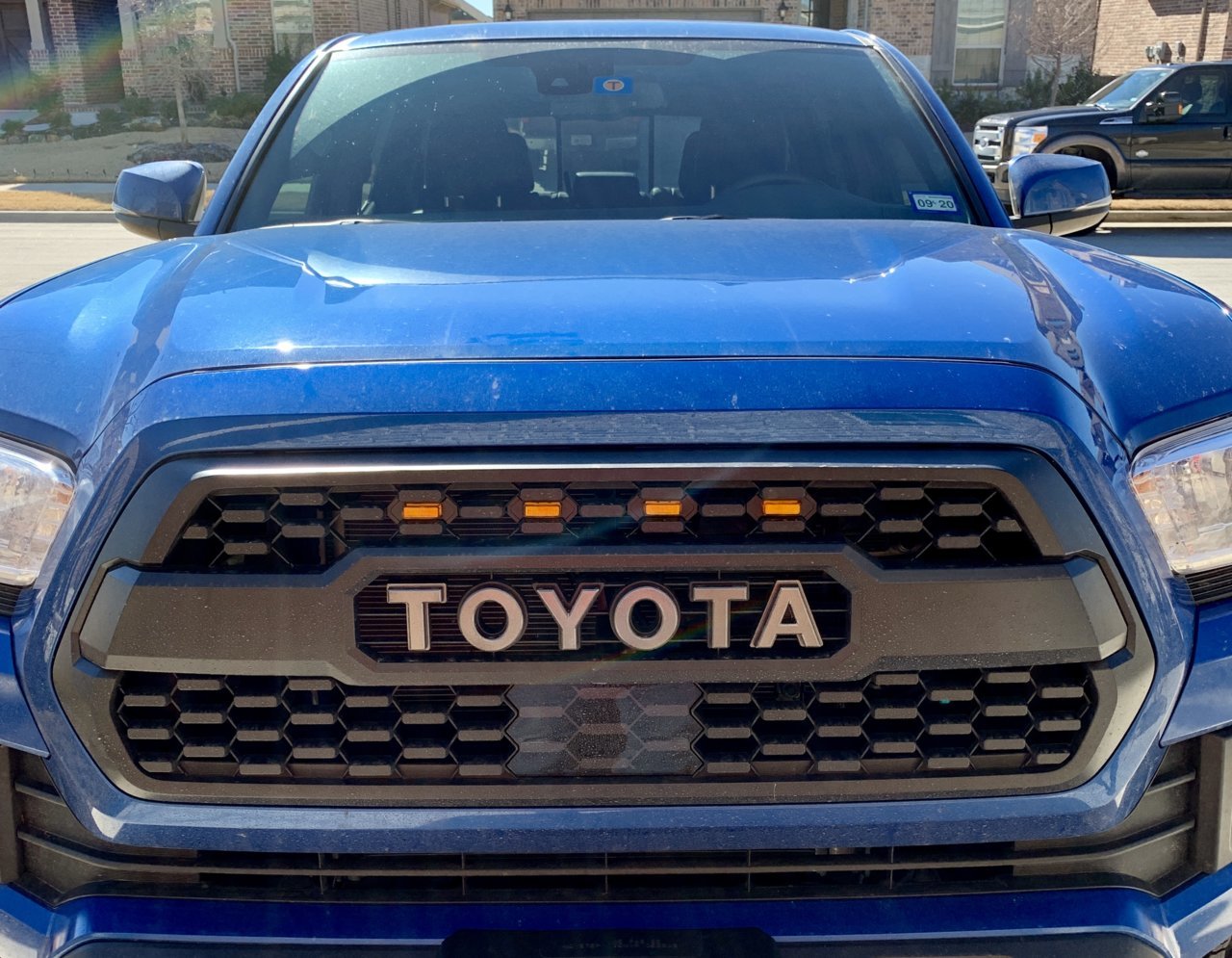

    I bought the running4tacos amber 4 light set and had it on my truck for a while. They snapped in fine and the wiring harness was easy to route/install. The add-a-fuse was easy (into the headlight fuse)- and ran the wire around the edge of the fuse box. The wiring harness was long so it made it easier to route (just had to zip tie the excess out of sight). Never had issues with them falling out or burning out.
    I just took them off last a week ago though for a different look- if anyone is interested in some, I’m willing to part ways (DM me).

    H-LP = HEADLAMP
    LH = LEFTHAND
    RH = RIGHTHAND
    LO = LOW
    HI = Hi
    The larger square drawing with the H-LP LO is the relay...

    Yes the ones you boxed off in the bottom left are the ones in question... two above that box is "H-LP LO" on a 15A fuse though...and I didn't know what that one was. So if I wanted my raptor lights to be on with the high and low beams, would I have to tap into both the LO and HI (both of the ones you boxed in red) fuses somehow..?

    The 15A fuse provides power to the Headlamp LOW Relay (Left & Right) then each lamp has its own 10A fuse.
    Just tap any of the LOW fuses(10A) for your added lamps to be ON. Some models do not turn OFF the Lows with the Highs...I don't know if yours is different.

    Lets just hope that the lows still have power when the highs come on... Guess I will find that out. Going to tap into the low like you suggested. Thank you so much.

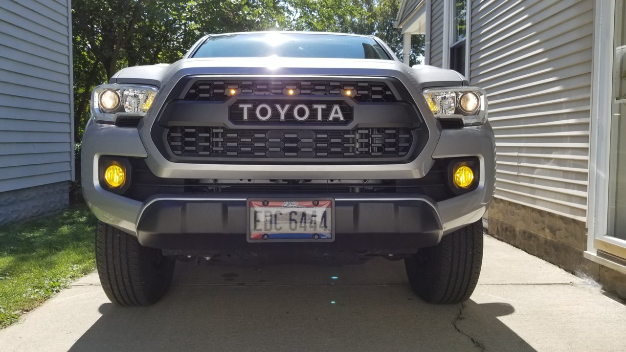

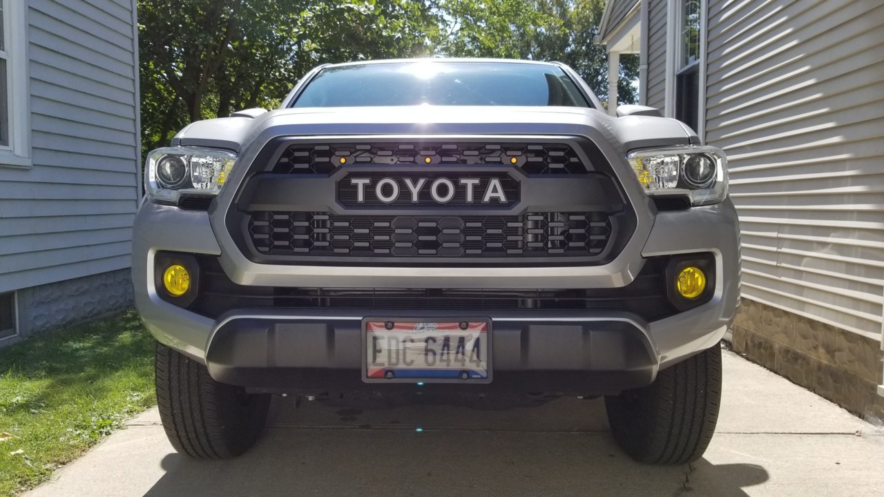

    Installed my yotaleds grill lights today ... perfect fit and only took about 25-minutes
    Yes they are expensive but quality made, the metal brackets are a perfect fit in the grill slots .. wiring was simple as it's just one ground wire and the add-a-fuse you just plug in your fuse box low beam 10amp so grill lights are on when lights are on.

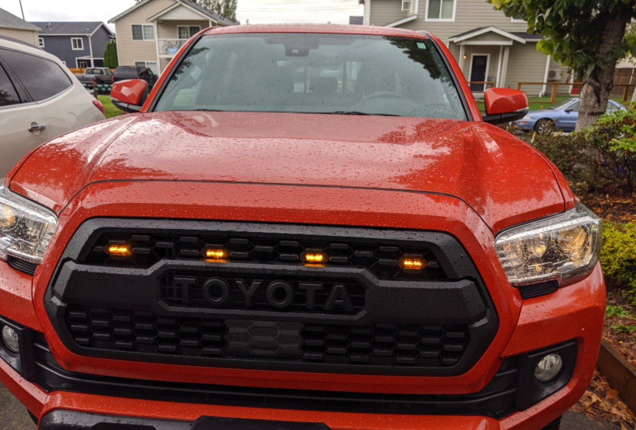

    Just put in the raptor lights from runnin4tacos.com, nice fit with the taco garage pro grille :)
