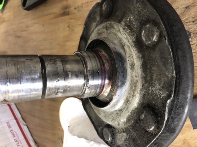

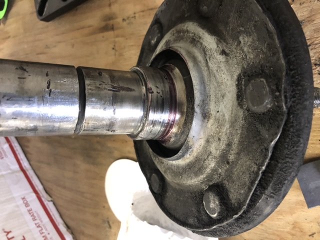

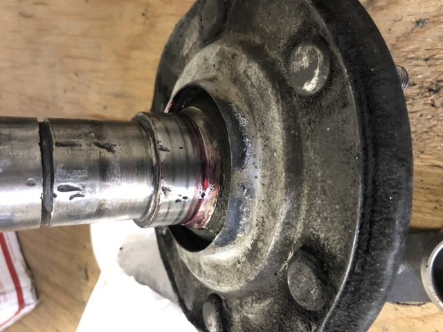

    In December I noticed a little play on the passenger side rear axle. No leaks, so I knew the seal was still likely ok but the bearing must be going bad. They were replaced with National bearings 3-4 years ago, local mechanic I thought would do it right pressed everything off and on for me...or so I thought pressed.
    Fast forward to today. I bought all the tools to to the job myself, and the bearing/seal kit from @Marlin Crawler that came with a Nachi bearing. New bearing pressed on, STILL have play. About 1/16 or so. Very noticeable without the axle in the housing, and it appears to have play tat the inner race.
    I’m at a loss, not sure what to do. I followed @Timmah! video to a T. Only thing I did was take some very fine wet/dry p800 and very lightly went around where the bearing would sit to make sure there were no burs or anything from where the mechanic did a hack job and heated, beat, and cut the old parts off last time. Attached are how the axle looks from the last job. I don’t know if the problem is the axle, or by some chance a bad bearing out of the box?

    Holy shit dude. That bearing journal is toast. Go buy new axle shafts, might as well do them both if the other one looks the same.

    I figured thats the response I would get, but not the one I hoped for :( I have no idea if the other looks like this one. I’m doing just one side at the moment since the play was on this side, and to conserve money right now

    Better to hear the truth, then BS ya and then you go make some baaaaaad decisions. You're doing it right. One side at a time:oops::cool:
