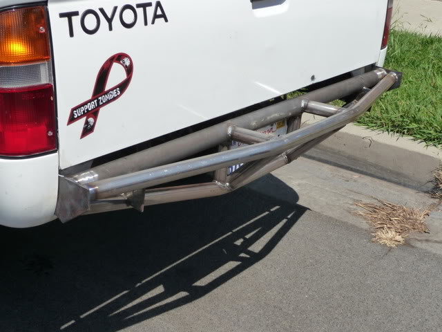

    Well I decided to sit down and build a rear bumper. I saw this http://dmzfab.com/images/rear.jpg and wanted something exactly like it so here I went.
    54 inches of 2" x.120 d.o.m
    and 60" of 1.5 x.120 Hrew.
    3/8 inch mounting plates
    2" hitch reciever
    and a Miller 250 dx tig.
    finishing it all up tomorrow.
    fab work rr bumper 001.jpgfab work rr bumper 002.jpgfab work rr bumper 003.jpg

    Finished Product as promised, Will update picture tomorrow of it painted. Then Hopefully tig the hitch reciever on by wednesday .fab work rr bumper 004.jpgfab work rr bumper 005.jpg

    I'm gonna copy you if that's alright:D Its exactly what I wanted to do for mine. Nice work!

    looks good man, i personally would have had it wrap around to the rear wheels, but it still looks awesome! nice and tight!

    WOW! that looks awesome!!! I woulda extended out past the taillights, but rep n respect for you building that. I want one

    Thanks guys.
    SRQ: Go right on ahead, I got the idea from DMZ and Demello.
    I think sliders will be my next build.

    thats a kickass looking bumper man. good job.

    no lie, best looking rear bumper i ever seen. most excellent job

    looks good but the hidden plate would get you a ticket a day here in jersey.

    Im pushing my luck here, twice a cop has been behind me and nothing happened.

    hey man, thats a awesome looking bumper, u did a good job. is there any way u could put a hitch with it?

    looks awesome, great job!

    Well for the hitch, I was going to relocate the plate off to the left, and Tig in the Hitch under where the 6 was. then add 4 corner gusset plate and hope when i get yanked it wouldn't go. Other plans was to add a Clevis and a shackle to the 2 vertical bars on the side of where the plate is. But if i have a hitch i wouldn't need that.

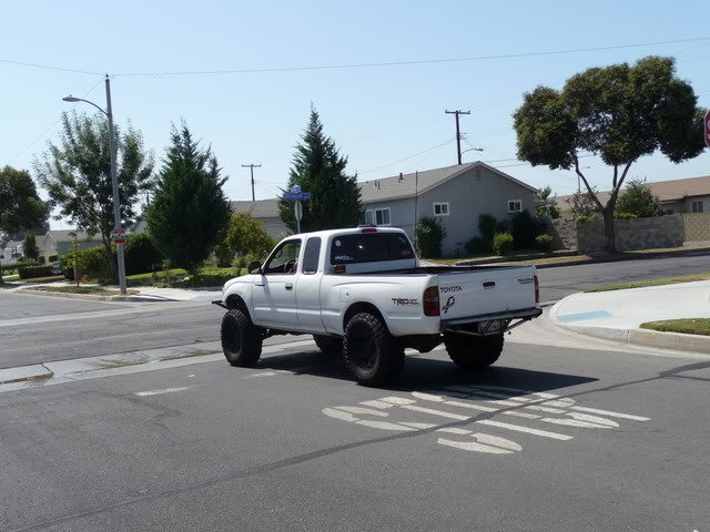

    Pics of Andre's bumper SCMD 4 2009Sept12:

    that is a badass truck you got there whatthepho... lets see some more pics of that thing. you got LT? i cant tell.

    No not yet, Wish I got LT. Im a broke ass college student, so i try to build things instead of buying it. I can make a LT kit, I just need someone to draw something out with some measurements. 50/50 anyone?
