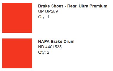

    Thanks for all of the replies guys. I went with Napa Ultra Premium Drums and Shoes. Hopefully the process isn't too painful, will get the drum brake tool kit.

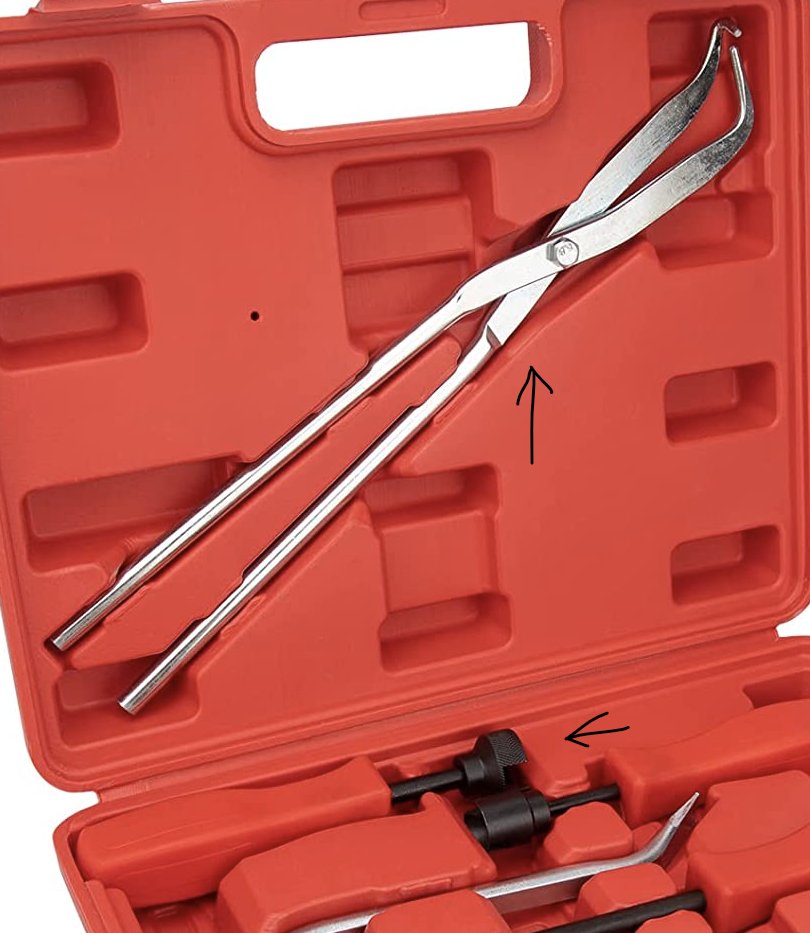

    What is the tool kit made up of?

    you just need these two:
    Sometimes the auto parts stores sell these individually. :notsure:
    Edit: Also- on the spring tool- I'll place a small block of 1/2" wood on the shoe surface so the tool doesn't dig into or mare the shoe.

    Do you know the size of that spring retainer tool? It seems there are a few different sizes so i want to make sure i get the right one if i just buy the individual tools.

    I'll go measure mine in a minute.

    Mine looks to be 25mm / 1".
