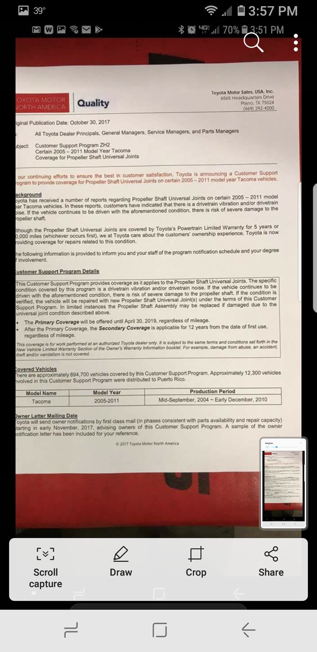

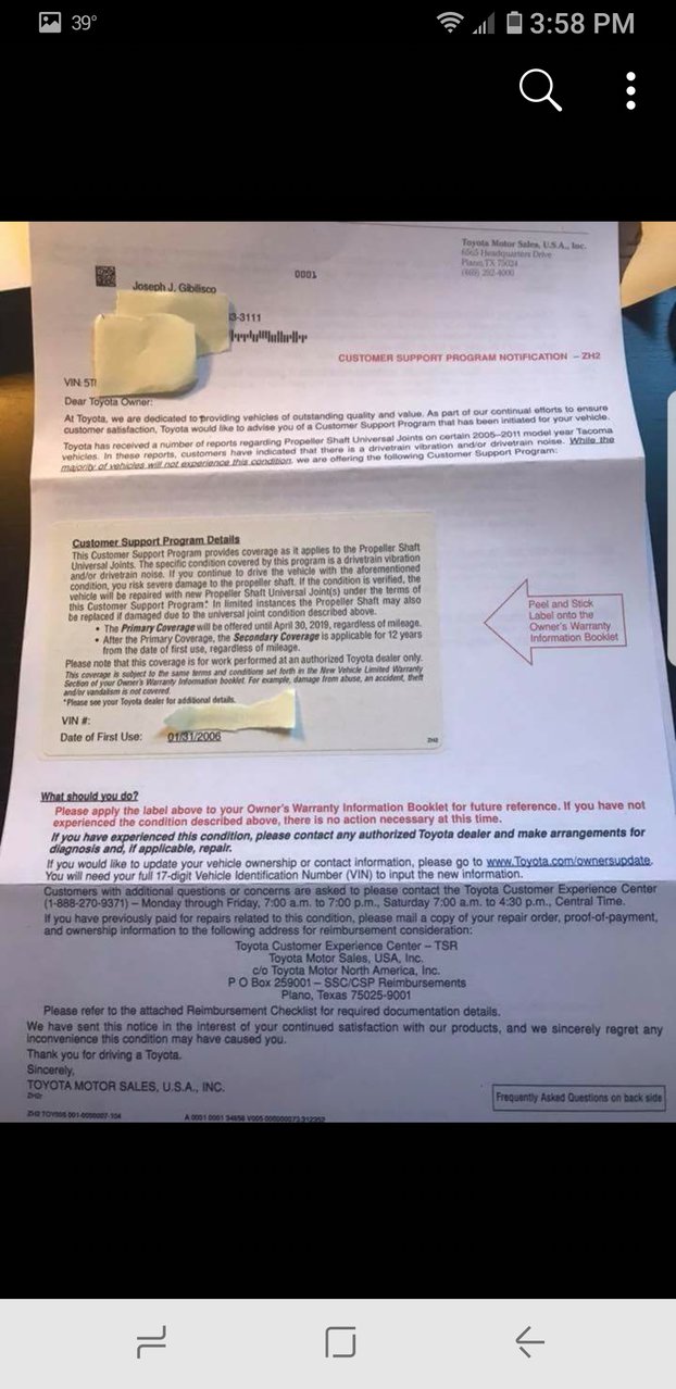

    Thank you for posting the notification letters, this info will come in handy when contacting a dealer.
