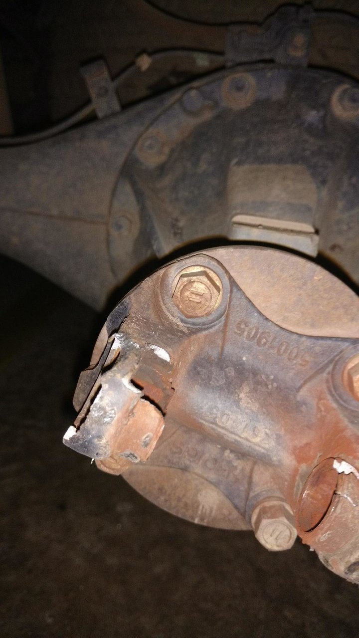

    My mom was driving her truck today and this happened
    2010 4x4 double cab v6 auto

    Didn't she notice the vibrations or maybe she liked them
