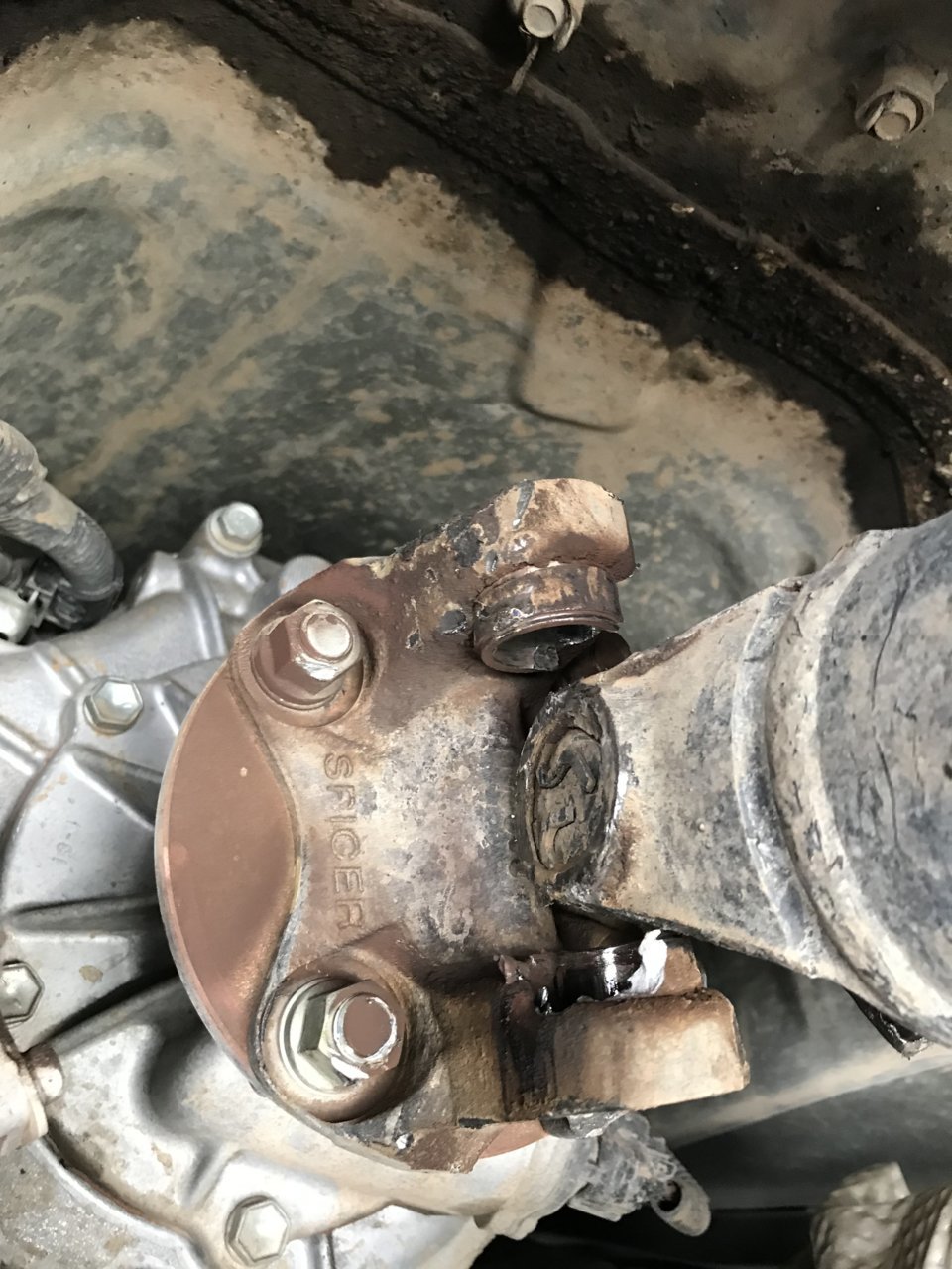

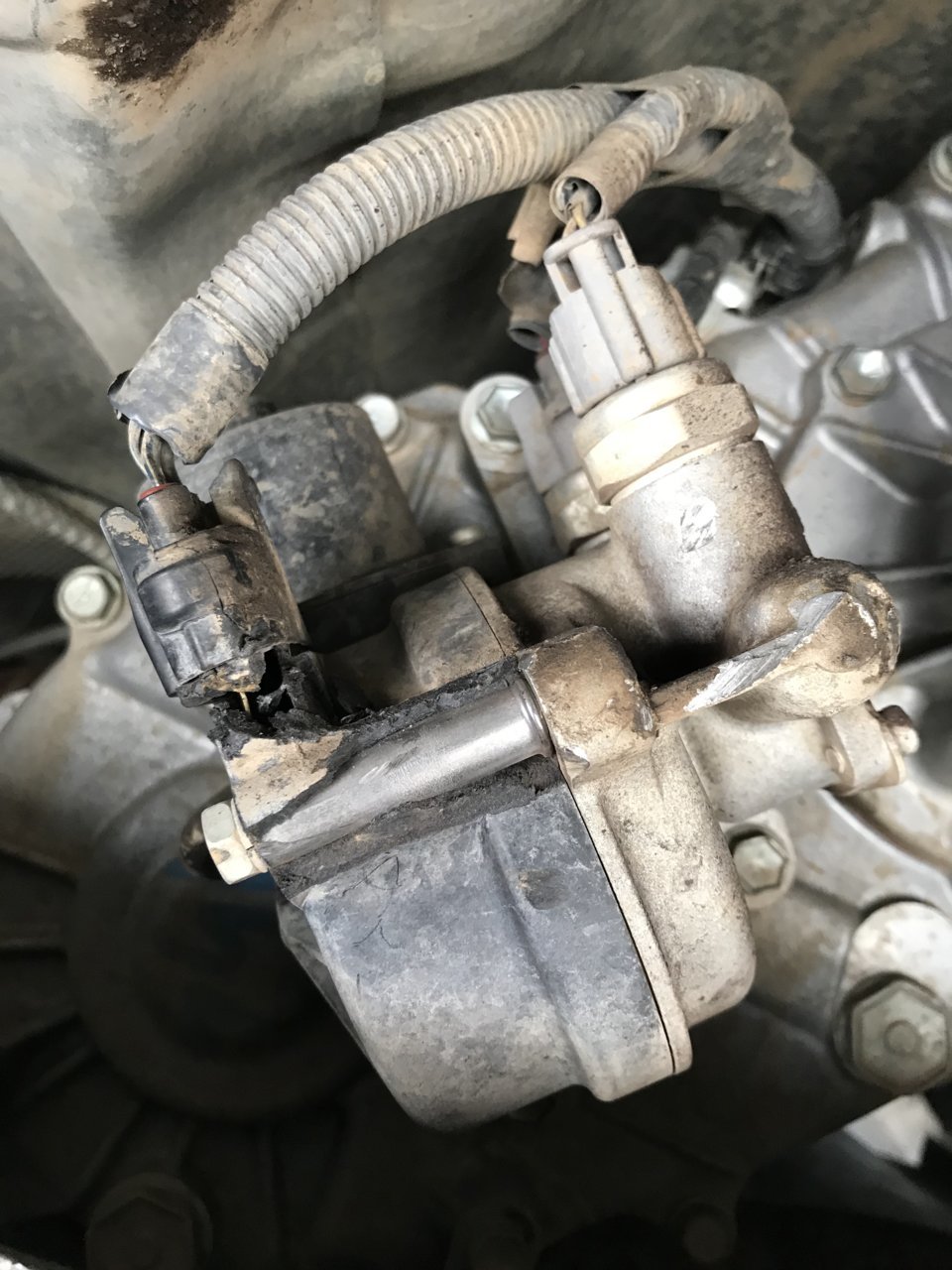

    OME 886 front and dakars in the rear. ARB front bumper, 12000 winch, relentless rear bumper, Stubbs Hd-sko sliders, Relentless full skids
    712BA5F8-D7AF-4D87-88F2-FC52F071F215.jpg 5 days ago my front propeller flange joint and u joint completely granaded and along wit7580B3D4-23D3-47F2-AF1F-039FCC0895FF.jpg h my drive shaft tearing some things up as it dropped. Wondering if Toyota will cover this fix
