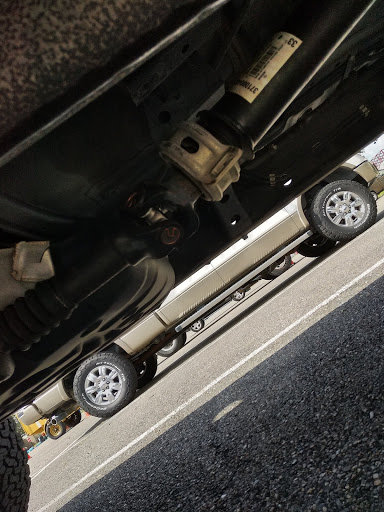

    Got my Truck back last week... Been hearing noises and reverse felt funny. Finally got around to looking at it and found this. Before I call the dealer, should I expect them to replace the carrier bearing? They didn't replace it last time and I probably have 200 miles on it hanging like this.

    how the heck does that happen? they should give you something. good lord

    Guess someone forgot to put a bolt in or just hand tightened it. I just don't want them to stick another bolt in if something could have been affected by this.
