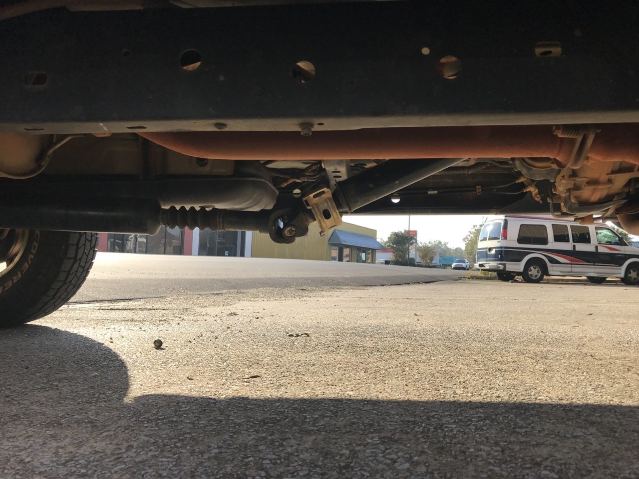

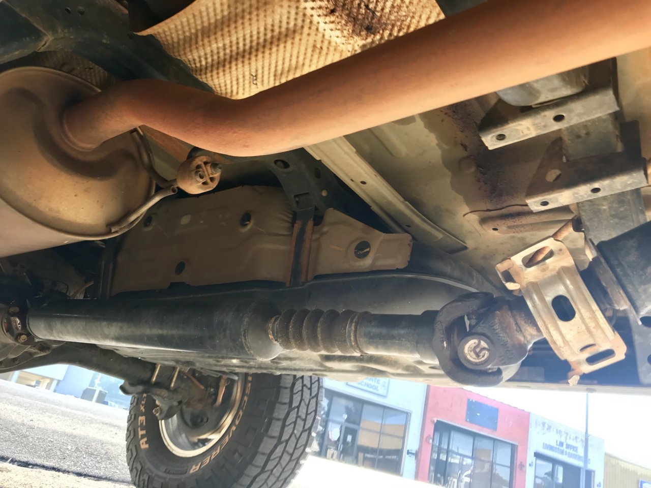

    Update update. Fucking floored. My drive shaft fell out this morning driving to work. Luckily I was in town not on the highway. Dealership really screwed up this time.1D982C9A-1A36-4004-A967-59F617AD9587.jpg2011531A-AE04-4339-A9B3-C525B0CD43A3.jpg

    Lawsuit time. You could have been seriously injured or killed if it broke and "pole vaulted" the truck.
    Glad you are ok!

    Absolutely.
    I would also expect them to inspect the transmission and differential to ensure no bearings/seals were damaged if it spun widly and shook the hell out of it all.

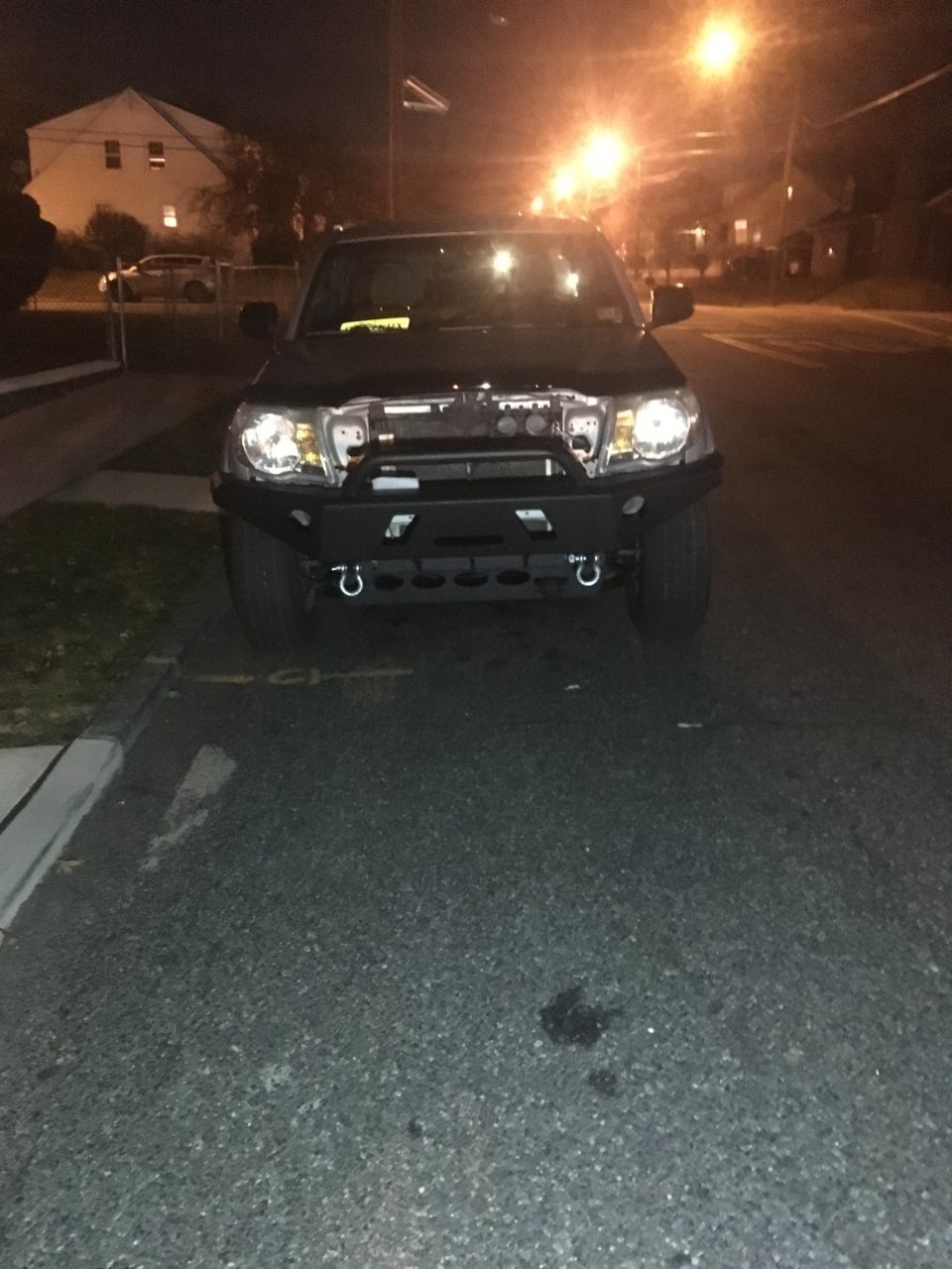

    I just had the same problem you guys had with my 6spd. Whenever I was cruising and let my foot off the gas it was fine, but once I stepped on it again the truck would jerk. And it also had a bad vibration at 60mph+.
    Sooo I took my truck in to the dealer beeefooore I put on the cheap off-road bumper on eBay (that way they can’t say that the u joints went bad because of the bumper or the bumper voided the extended warranty).
    Put on my bumper once I got the truck back from the dealer. 6EF9E556-BD71-46ED-BCBA-3CC7F67D6794.jpg
    Now im feeling a slight vibration when I’m driving highway speeds around 60+ but no more jolting/jerk from the truck. Crawled underneath and pushed up on the carrier bearing and sure enough, it’s got about 1/2-3/4 inches of play up and down.
    Whyyyyy wouldn’t they CHECK the damn carrier bearing too if they went and changed the u joint.
