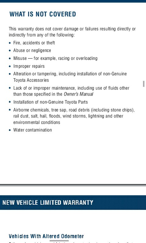

    Found the new vehicle limited blah blah warranty section of the warranty booklet for an '08...

    Theres a pic of the letter on the first page srry mines at home.
    It states u joints and possibly prop shaft if damaged by conditions of u joint failure

    "Certain 2005-2011 models"
    I got a letter ill look up my vin to see if it shows

    I hope so. Mine is shot! Strong enough vibrations will definitely wr CL you carrier bearing but pretty sure mine would be blamed on lift and like others in not so hot on paying a diagnostic bill

    Mines wrecked too, but I have dakars so I’m probably SOL

    Same. Dakars. Might take out two leaves to get closer to stock height and then try bringing it in.

    I’d rather just throw in stocker and bring it in

    Yeah but that's a lot of work for MAYBE getting a repair and could still be that you only get new u-joints and not a whole new shaft and carrier bearing
