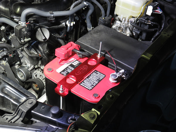

    I just gave my wife’s Camry the five month old Tacoma battery. Put a red top in the Tacoma with the spacers and they don’t fit the OEM tray. It seems the red top is a little shorter than the OEM battery. I’ve cranked down the tie down to the point that it’s deforming the battery tray and it’s still not tight enough for off roading. If I really push and pull on it it slips just a little bit which isn’t cool.
    Can somebody point me to a decent aftermarket battery tiedown so I can throw the OEM in the trash?
    And the negative post is a smaller diameter in the red but I can shim it.

    Tacoma battery is 24f, I put a yellow top 35 battery and used the provided plastic spacer and it fit fine. If the Camry is also a 24f, there shouldn’t be a problem I think.

    Actually for your specific problem OP, maybe just a cut up piece of cutting board, sounds like you just need a very tiny riser to meet the hold down. That's the cheapest heavy duty plastic you can buy

    I use this Toyota 86 / BRZ tie down bar with generic parts store 8" J-bolts and 1/4" locknuts: https://www.ebay.com/itm/P2R-Billet-Scion-FR-S-Battery-Tie-Down-2013-BRZ-/252332542376
    c4kIYMWIKbLtVTC7rzHfqTzqQHmssdJ72BLK3vsO_6db51a3bf20ae32cfbe0b95c991dd56dc4c4f639.jpg
    You can also spend a bit more for @Coupe's TRD tie downs: https://www.tacomaworld.com/threads/3rd-gen-trd-battery-hold-downs.574494/
