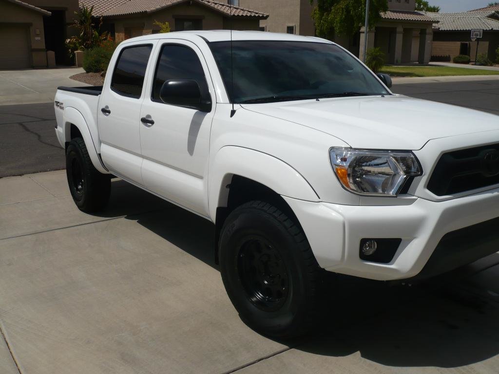

    265/75/16 Cooper ATP's on stock suspension. No rubbing but close on the inner fenders at full lock. I had plenty of room on the stock alloys, but with the backspacing of the KMC's I put on, it pushed out the tires out a bit and made it close.
    I would stay with 265's, they are perfect for the Tacoma.
