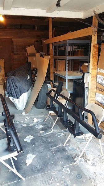

    rattlecanned mine: sanded, wiped down with mineral spirits. Then primer, bed liner, and semi-gloss black
    Great thing is how easy they are to touch up when they get scratched
