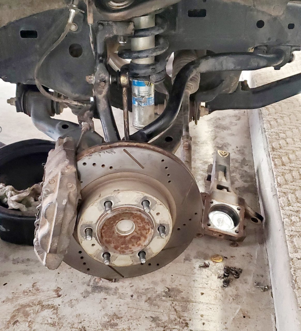

    Step 1: TRD Ceramic pads, stoptech cryo slotted rotors, rebuild the calipers
    Step 2: higher level: upgrades. 5th gen 4runner calipers (larger), tundra brake master cylinder, possibly same as above parts but larger versions to fit
    good with both: stainless steel lines
    I did and still use Step 1, which solved pulsation. I want to go step 2 ideally, which is even better, but is hard and costs more.
    Stoptech rotors and ceramic pads? They slap right on.
    But upgrading the caliper size, brake cyl, associated parts, etc. if you look into it, seems like a lot more work.
    I haven't scoured the junkyards or carpart dot com for it,
    but any time I browse Toyota stuff on FB/CL/OfferUp/etc. I NEVER see any crashed 5th gen 4Runners being parted out, to even ask if they'd part with the calipers for a decent price
