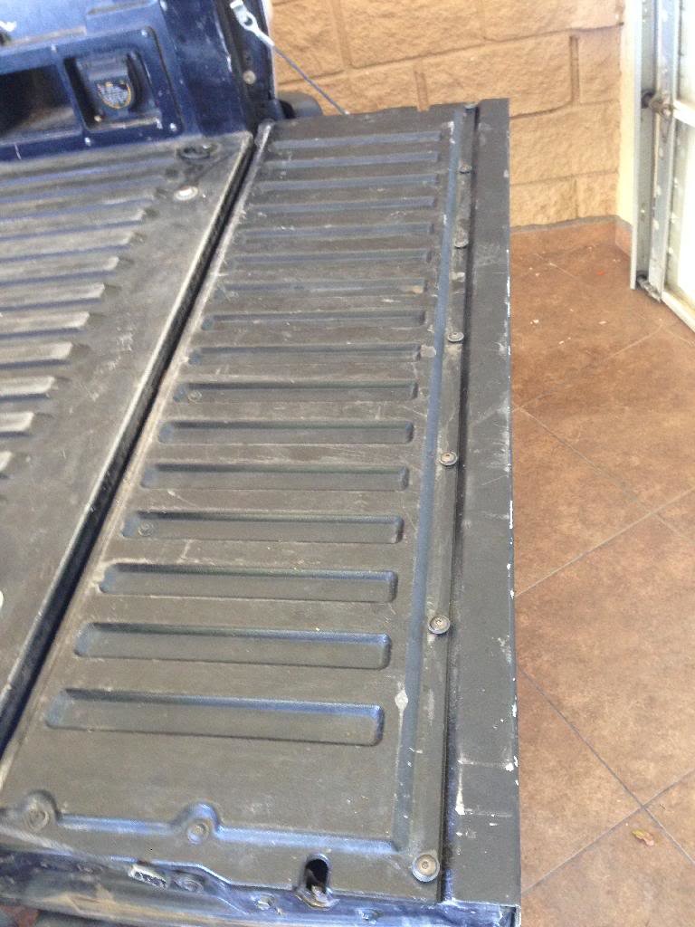

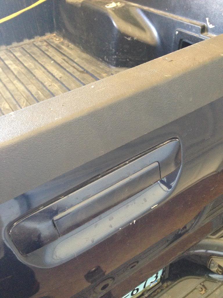

    To double check: You also remove the black plastic angled trim piece at the top of the tailgate, yes?
    Assuming the metal-reinforcement doesn't fit over that. I think I need to find some of that clear vinyl to cut a strip and put on the tailgate painted side to avoid scratches...

    I couldn't get mine on in the test fit phase, before drilling the holes. It didn't even really seem close. I gouged he paint a few places and I was still almost an inch from it seating over the ridge in the top of the gate. I tried convincing it, but to avail. I may try again.

    Yes, you remove the plastic cap on the top of the tailgate. With mine, there was only a scratch from my test fit, and it was pretty minor. After my test fit, I used blue painters tape to protect from any additional scratches.

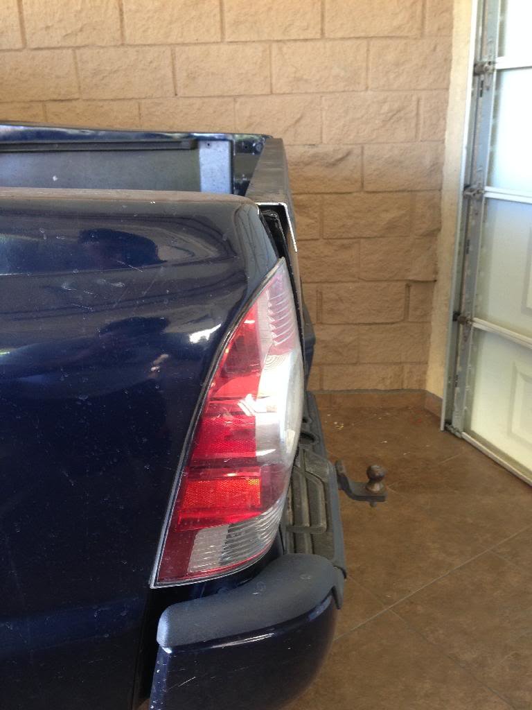

    Only that tailgate doesen't close completely

    If you're going to be using BOTH the plate AND the stock composite, I believe that you need to adjust the hinges so that it will close properly.

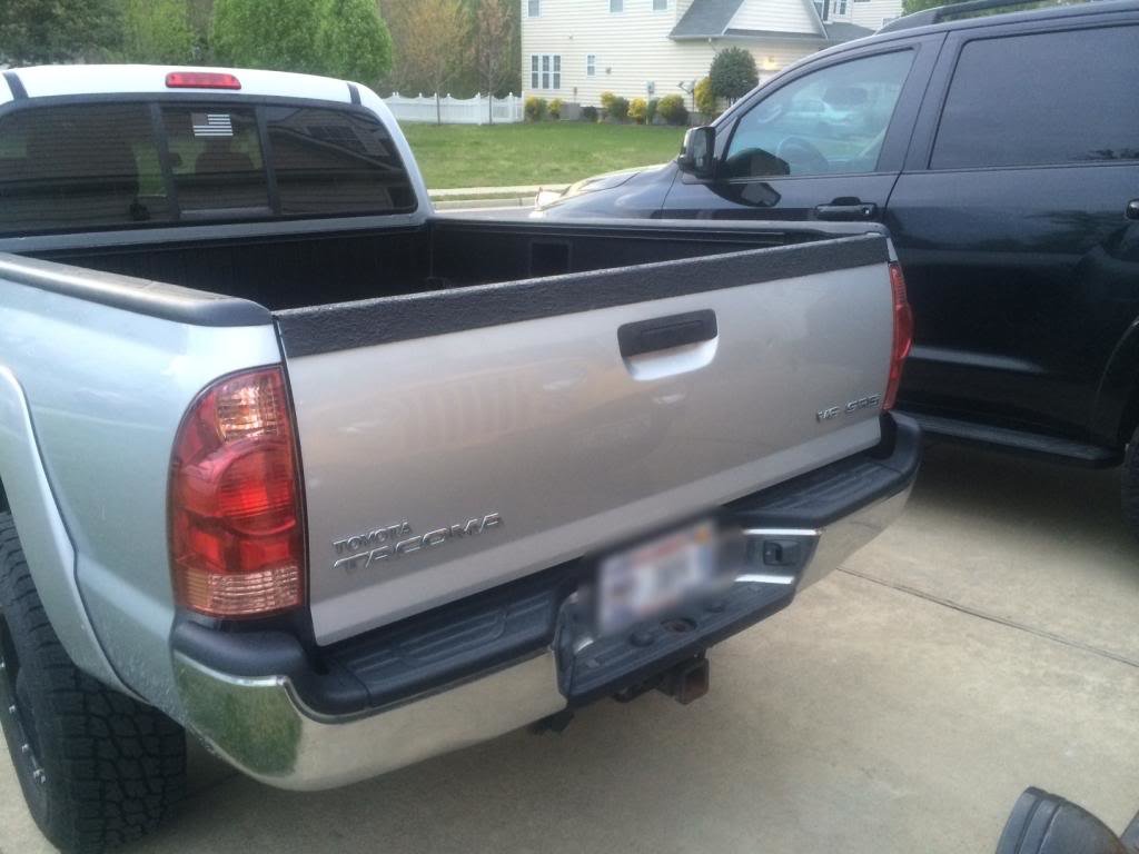

    Installed my tailgate reinforcement today. Love it! Used Herculiner on it. Helluva deal.
    Many thanks to HoffmanDesigned!

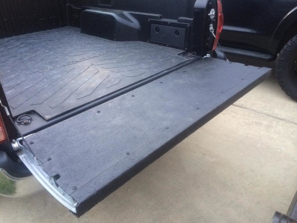

    This is a good point. I drilled all the holes the same size, then I primed (last night), and _then_ realized that the larger screws, while the same diameter thread-width, has a wider head (you know what I'm talking about).
    So I guess my options are to: widen those screw-holes...or live with the screw not sitting completely flush.... :confused:
    Im going to be re-using the composite decking on top of it (already trimmed ~2mm of metal from the sides).
