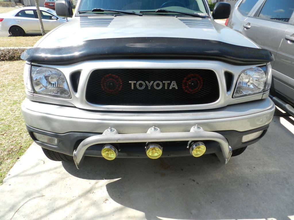

Let me know what you think?

    Just got done installing my new grill mesh, 4 hours and a lot of cutting/ shaping and trying to figure out where to drill the holes for the zip ties. Powder coated gun metal grey.
    It turned out better than I thought it would.
    As a note to those who are going to try this install, do NOT tighten any zip ties until you have them all started. That way you can still lift and move the mesh around to get the next zip tie in place as you work your way around.

    Nice truck and a very clean install! I really like the pattern of the mesh.
    1) Where did you go to get the material?
    2) Did you do the PCing yourself or have a pro do it?
    3) Do you plan to badge it up with something or keeping it as is?
    Job well done. :)

    BigOly,
    1) I got the mesh from Custom car grills.
    http://customcargrills.com/products.asp?cat=56
    2) I did everything myself after gathering all the information I could find about other installs. Nothing like a good 90 degree grinder:)
    I used card board to get the correct shape of the metal insert before I did any cutting. ....actually, I did have a pro install it, ME!
    3) I think I will leave it the way it is, I like the clean look.

    Im looking to do the same thing. any chance you can take pics of the inside of the grill? I want to see where its all held together.
    also is the 6"x36" the size we need?

    I guess I really don't get these altercations...
    what function does this altercation offer to it's owner :confused: :notsure:
    just another TW bling ego thing ?
    What makes muh junk stand out...
    is not what it looks like... but what its done...
    will do... and where few others have been.
    once there... image seems of little interest.
    zip ties suck btw... they dry up and get brittle.
    got to be a better, more durable/permanent method
    of altering these grills !?
    Anyone use a different method then zip ties ?
    Anyone install this insert thingy using a plastic welder ?
    ^ if the grill's plastic could be ? :notsure:

    I will take some pics of the back side of the grill today and post them.
    I got the 16"X48" size so I knew I would have plenty of material.
    I did use zip ties and I know they will get brittle over time. I have found two plastic products that will allow you to adhere plastic together for two different applications.
    The first product, Plasti-Mend Black 4oz, https://plasti-mend.com/cart/index.php?route=product/product&path=59&product_id=79
    The picture of the product is just a stock pic. and makes it look like there are three cans but you have to pay attention to the quantity on the description.
    I have used this product and it works great for bonding plastic or filling plastic cracks or holes. It's fairly thin/liquid that starts to set up or skin over very quickly due to quick evaporation of solvents. I will be using this to adhere tabs that I am going to make so I can get rid of the zip ties.
    The second product, PlastiFix, http://www.urethanesupply.com/PlastiFix/ can be used to secure the mesh to grill permanently without worrying about getting brittle and cracking. After you bring up the web site, look on the left side of the web site for the Information and Instructions blue section, find and click on the "Videos" at the bottom. Next, go to the second page of the videos and click on the first video at the top. It shows the best way to make tabs and use the plastic powder to bond plastic material together, like grill mesh to a grill. I haven't used this product yet, I will be buying it next month.

    Here are the Pics of the back of the grill.

    Nice job. Been wanting to undertake this project for a while but was hesitant to do so. This looks like a simple way to accomplish the satoshi look without going the fiberglass and bondo route. Thanks for posting and providing the links to the plastic products.
    So it looks like after you cut out the center section of the grille there was enough material left for you to drill through in order to attach your zip ties, correct?

    Increasing air flow and improving heat transfer through the radiator seems pretty functional to me.
    Zip ties are plastic and don't dry out. They get brittle when exposed to prolong UV, which isn't an issue with a recessed grill. I'm not sure how you can say they aren't durable. :confused:
