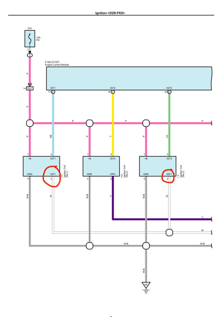

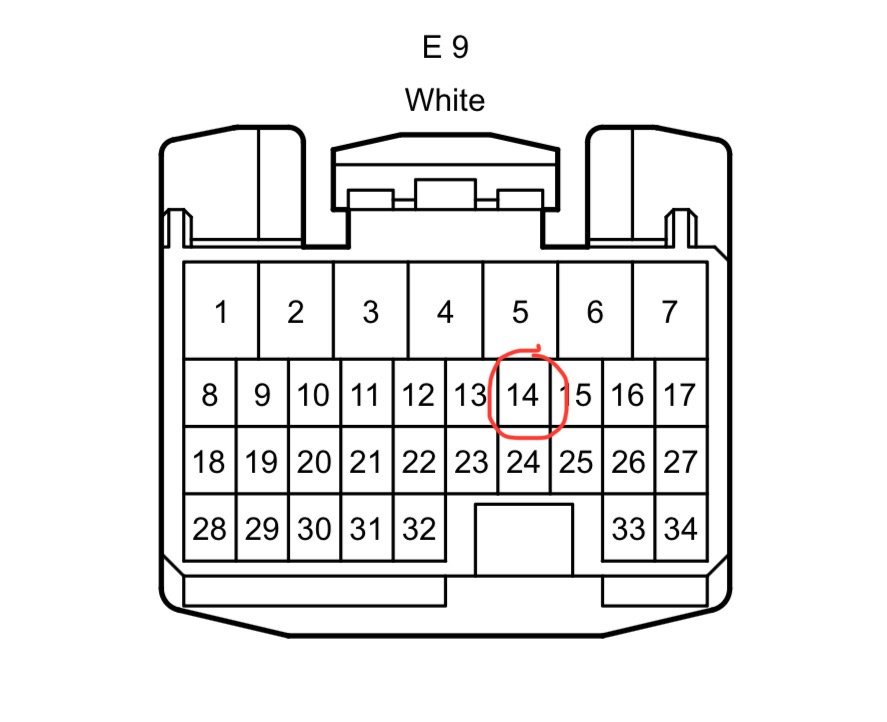

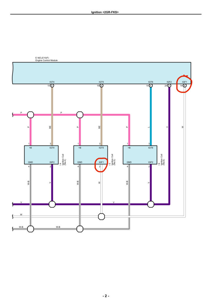

    I would say it’s unlikely the new ECM is bad unless you have something else shorting it out. Although the lack of codes doesn’t sound good. There is only one circuit common to cylinder 1/3/5 ignition coils. It is the white IGF1 circuit. It goes from the #14 pin on E9 connector to each coil on the right bank. I would check that and make sure you have a good connection to each coil connector and a good connection at the pin to the ECM.
