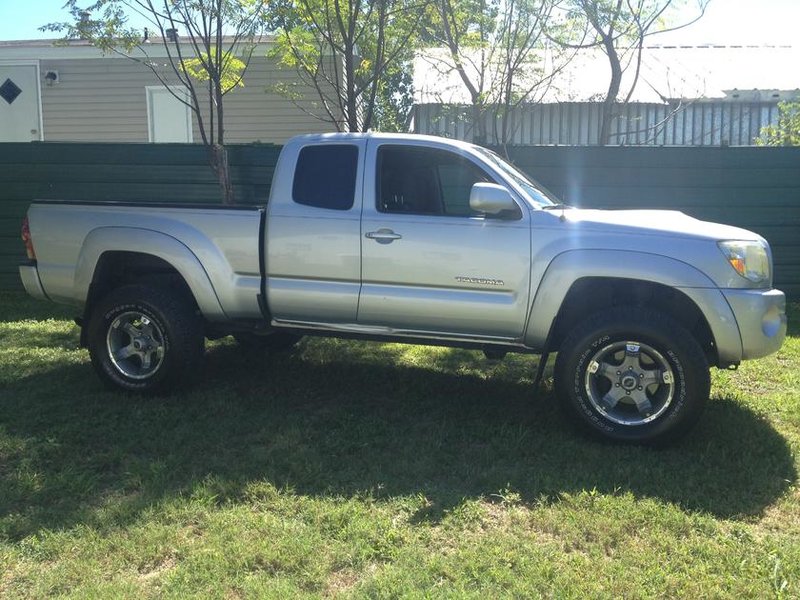

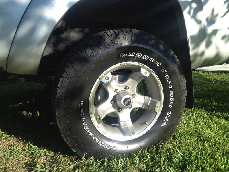

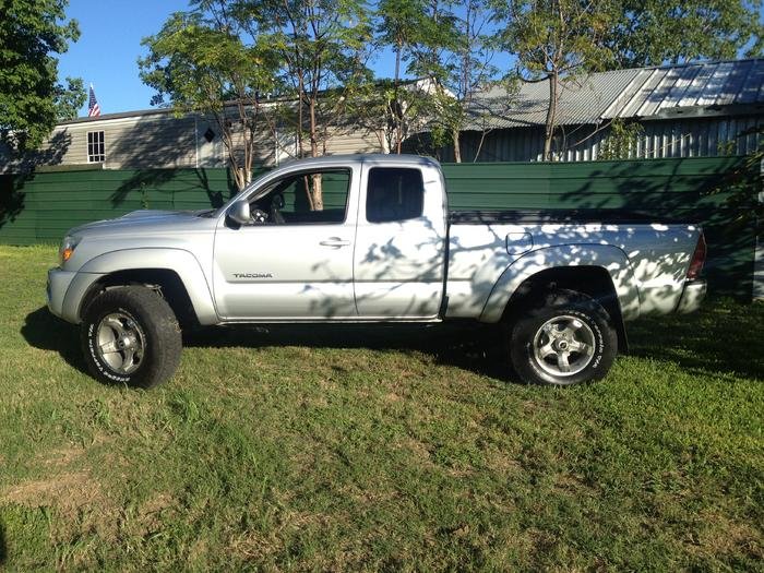

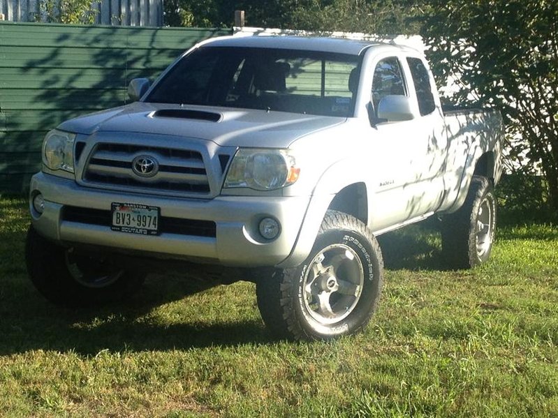

    Been a long since I've posted but, I wanted to share my new purchase with you all.
    New wheels and tires. Went from Ivan Stewarts from a Tundra to Black Rock 17". P285/70/17 BFG Rugged Terrain T/A. Really like the new tread pattern.
    If you are considering these wheels they will not fit without spacers, the bolt on kind. Some call them adapters. The front wheel hits the brake caliper.

    Looks good I like the combo. That was one of the tires I was considering for mine when I was shopping last month. Kind of pricey and they don't have a lot of siping so I was concerned they might not be too good in the snow. I wound up buying Generals and Dick Cepek wheels for mine.
