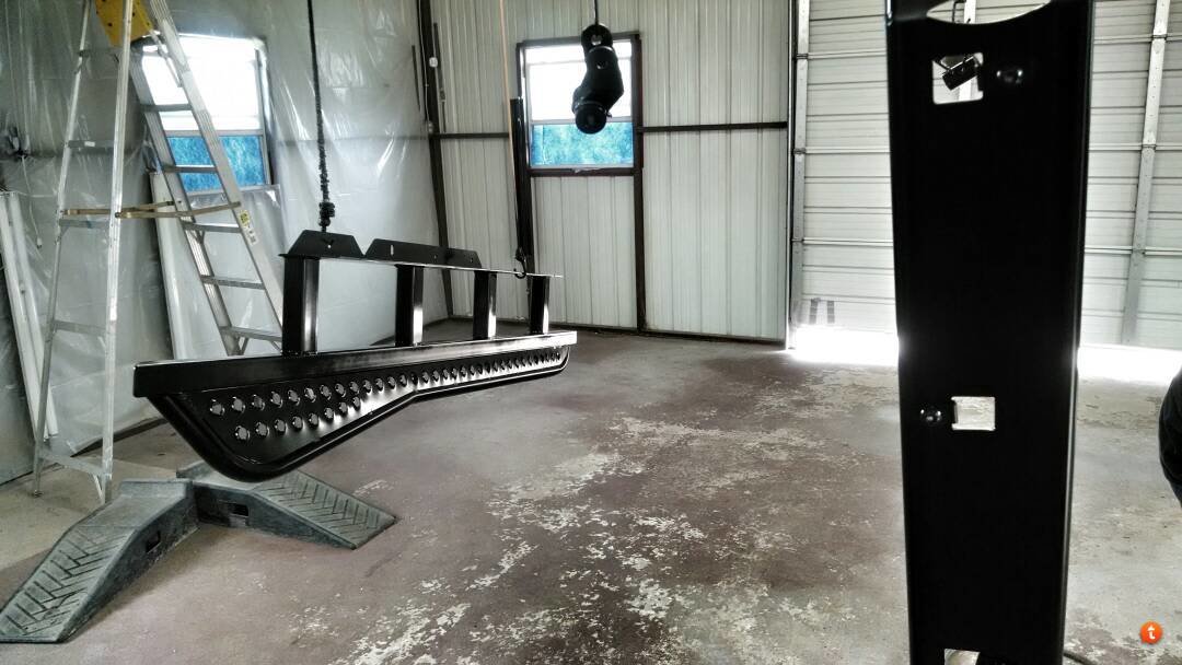

    Just thought I would post a pic of Josh's sliders with Kickouts and fill plates as an option.
    He is awesome to work with.
    Just finished spraying primer on them...

    the sliders look great with high quality and craftsmanship but I honestly have never seen any sliders bolt or weld on that didn't have gussets for added protection. I just thought it was interesting that's all.

    I will get a shot of the underneath later tonight.

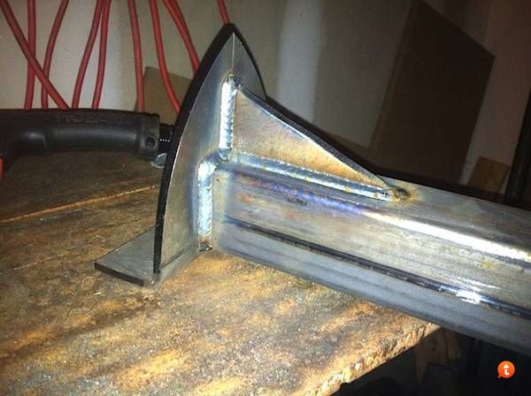

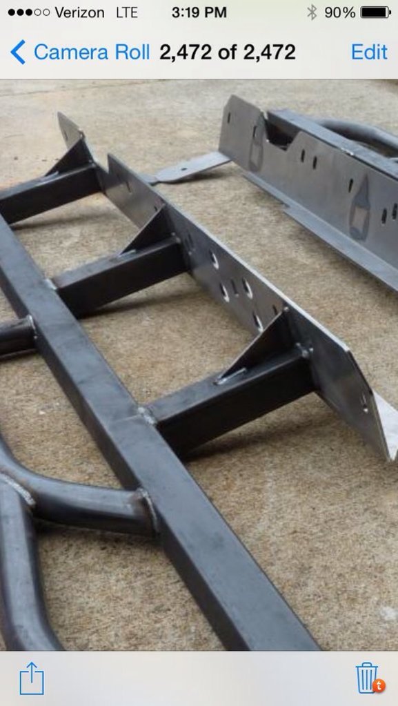

    Ps for those that don't know what a gusset is. This is a gusset.
    Just never seen sliders without them. Helps keep the sliders from bending up towards the vehicle when all the weight is on them pushing up like resting on a rock or hi lift.

    not sure what I was thinking...
    I will see how they hold up and report back.
    hopefully there will not be too much flex.

    hack job
    My sliders looked like that too..
    The gussets didn't come welded onto the sliders they came separately. I'm sure these include gussets as sliders are kinda pointless without em
