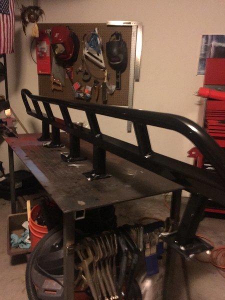

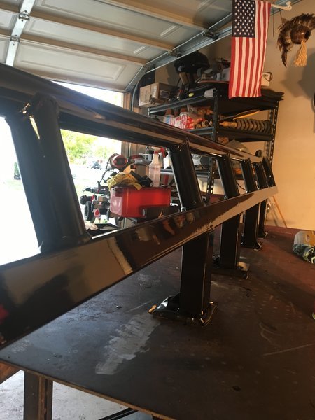

    I have recently used POR15 on my sliders, I've only had them on the truck for a few weeks but so far so good. This stuff is supposed to be incredibly tough. The video that sold me was this one:https://youtu.be/d4L0N3-OTcI
    1:02 ^ clanking two treated steel pipes together with no chipping= tough shit.
    I paint-brushed it on with 2 coats after I did the other prep steps (degrease/ metal prep) waited 24 hours to cure in the garage and welded them on with no issues. It is a bit time consuming to do the job right. But worth it if you don't have to touch it up all the time. I'm not the best painter by far but it came out pretty good I think.
