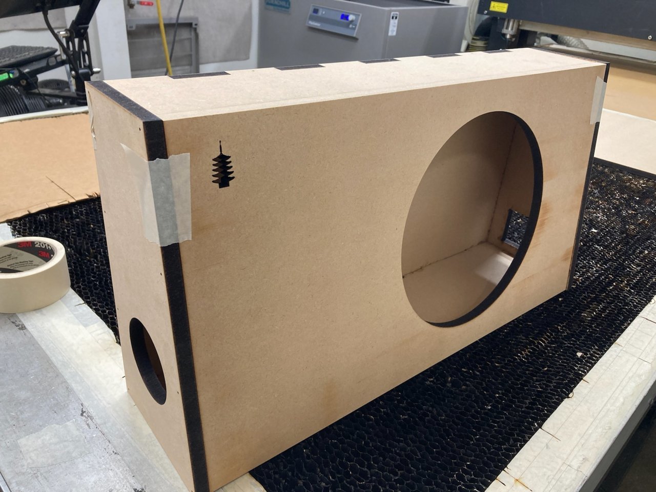

    Prototyping a nice hi end budget no frills ported shallow sub box that fits behind either seat in the cubby without any modifications or part bin removals.
    The mounting depth is roughly 4” and can fit various 10” shallow subs as well as optional space for a midrange 3.5 for anyone look for that fat mono sound in the back.
    What’s cool about adding a 3.5 in mono to a sub is that you can play with various nulling issues and comb filter issues in small rooms like a truck. What is also cool these will be all USA made (in Commie California) and not sprayed with chem trail poisons and funny sweatshop smells.
    Any interest from people here?
    CNC laser cut, mdf and/or 1/2” birch, glued and reinforced countersunk joints. Dynamatish 150mil internally with acoustic Roxul spun mineral wool and 3” side port, rubber decouplers, rubber feet, metra wiring plate, clear custom spesker grill. Lights???? Different finishes and veneers, acrylic, etc.
    Will be able to crank these out as relatively affordable kits if worthwhile and can also customize cutout diameter and end caps.
    More photos of finished product coming this week. Can’t wait to install my Focal Flax which will give a rig that will smoke pretty much anything under 1k.
    No reason to pay 700 for a sub box!

    waiting on the speaker from crutchfield and will post finish pics this week. i have a CAD file very easy to modify for custom sizes within reason.
    ...and will come up with an awesome price that moreorless covers materials, laser fee, and a tiny margin for time.

    Beautiful speaker, extremely well made and nice earth tone color. 3.5” depth should fit in the build without issue. Waiting on the new cut pieces tomorrow and will show finished product hopefully tomorrow night. Will be stuffing ultratouch recycled acoustic denim and closed cell Noico 150mil throughout. The inner cab volume is roughly 14L so basically perfect for a ported 10”. If room allows we might be able to mount the speaker on the inside face so you have that 1/2” clearance for a flush mount grill protector etc and keep that sexy burnt laser edge.
