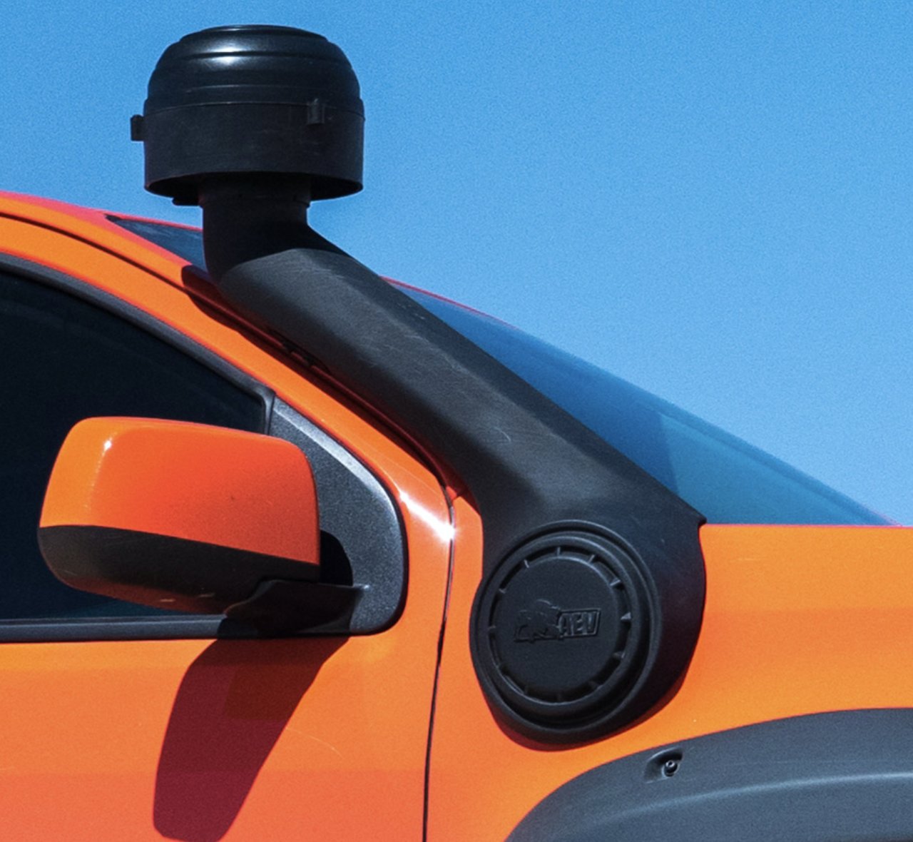

    that is not where snorkels attach on Jeeps. They still travel along the hood to about the I or C in Rubicon. They use that spot for bracing.

    Thats a picture of one... It travels under the fender and up to that panel.

    interesting. I’ve only seen different ones

    AVE Ram snorkel with pre-filter :thumbsup:

    Lame, why aren't these companies running under the fender like the Jeep and AEV snorkels...

    you realize we have a whole fender. Not a piece like jeeps, that can be removed
